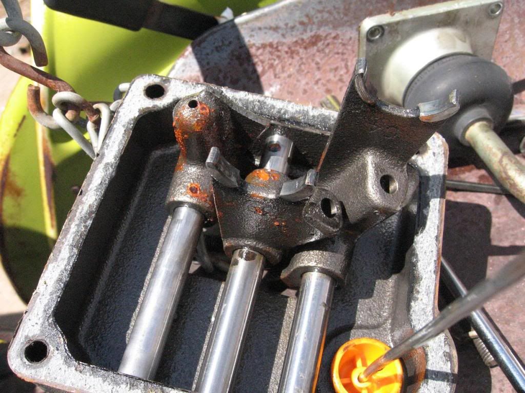

The shifter cover (Part 8 (I guess) here) comes off easily; everything appears intact, movable, with functioning detents and so forth.

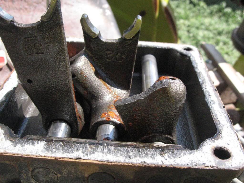

I got it off, with a combination of a hoist and a mallet. I'm not sure why it was so tight, but it was! The internals were kind of disappointing, and also a relief. There was a broken shifter fork, sure enough:

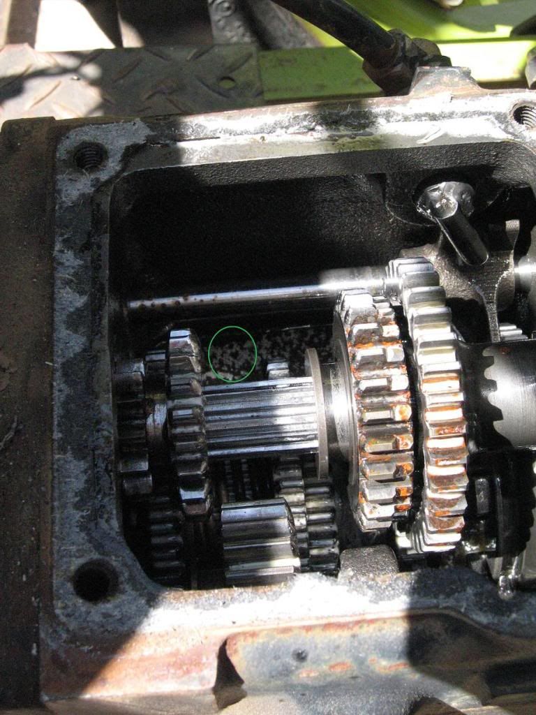

There was also very clear signs of water contamination and the ensuing rust:
There is a film of something, whether it's an algae growth or what I'm not completely sure, floating on fresh hydraulic fluid over a milkshake of contaminated fluid. You can see the grayish-white flakes in the green circle. There is also ugly rust on some gears, but it appears to be fairly shallow, and shouldn't be a problem once cleaned.
The broken piece of the shifter fork is presumably down in the bottom of the transmission case. I haven't been able to find it with a magnetic probe. I'll pull the hydraulic screen and attempt to reach it through there. The hydraulic fluid badly needs to be changed anyway. I'm hoping to be able to fish it out from there.
