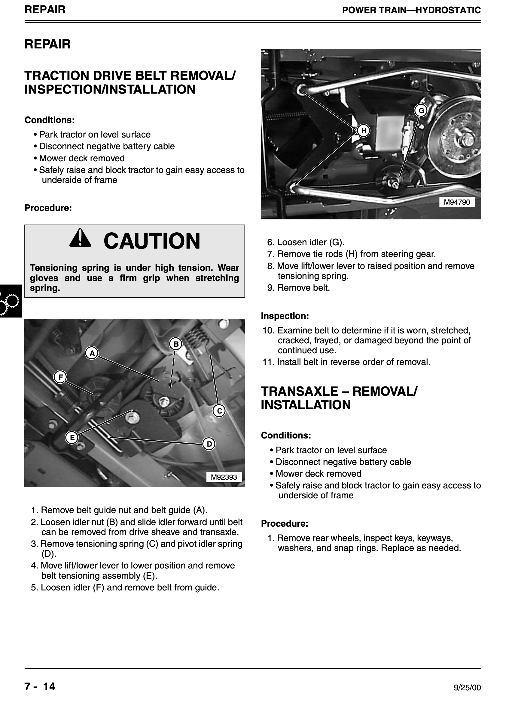

Old belt snapped off and everything I've seen tells you how to Uninstall. And then says follow the way of the old belt. Well if it snapped off you don't have a pattern. Anyone help here please?

Looks like i got it on right but I'm getting no forward or reverse. Is there supposed to be any play in the belt? Or is it supposed to be tight?
   / Transmission belt pattern for LT155 #5
I would say if properly installed the belt should be tight. Not unusual for springs to get launched or broken when belts break.
   / Transmission belt pattern for LT155 #6
Be sure that the spring is in the groove of the arm. If it slips up it won't drive.
   / Transmission belt pattern for LT155 #7
I have a PDF of the tech manual, if wanted message me your email and it's on the way-
from the manual -
