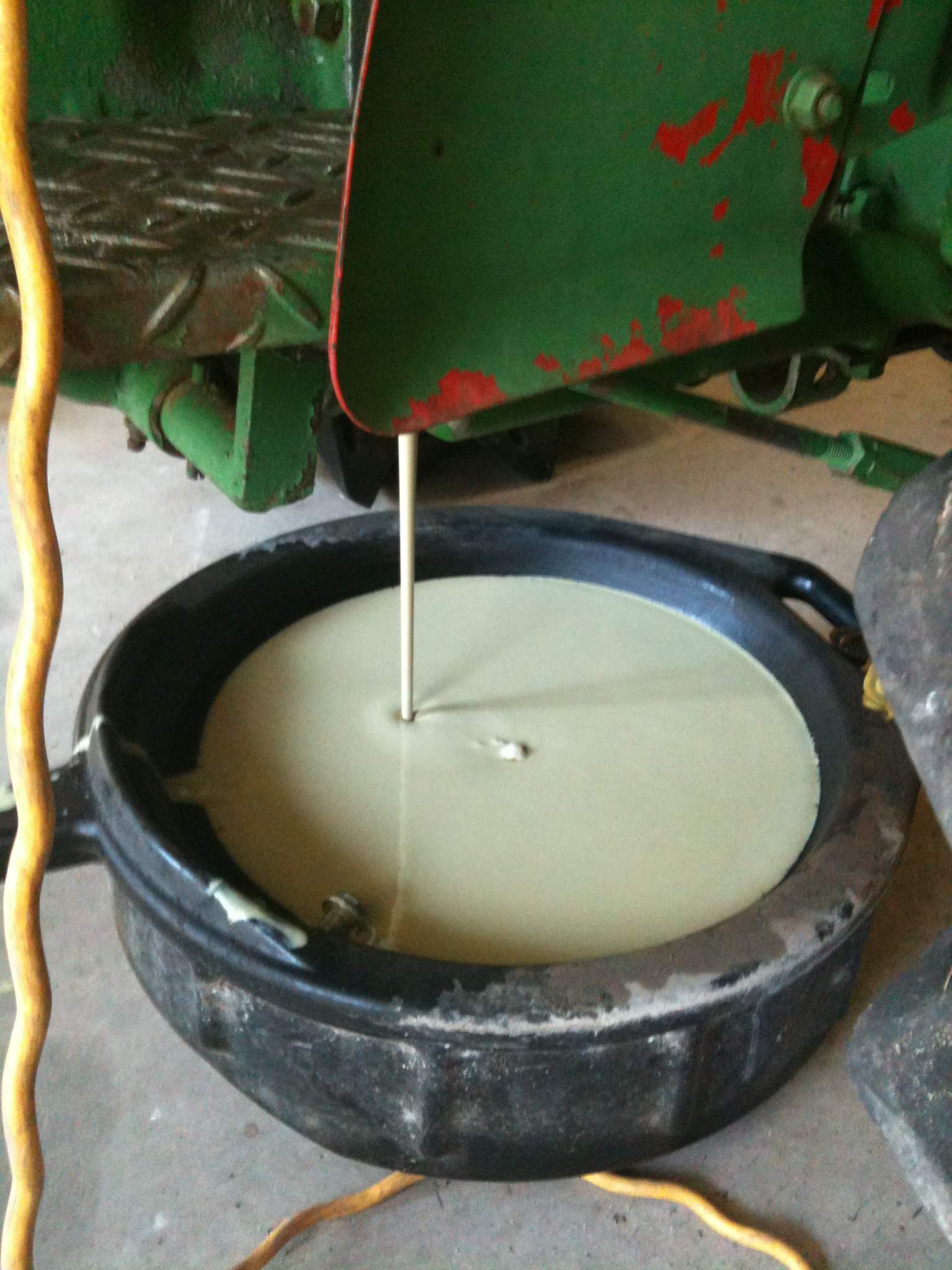

I got around to changing my tranny fluid today and to check the screen that lives under the 3 bolt plate. I looked at the color of the new tranny fluid and realized that the old fluid is almost white in color, and it kinda has me spooked. I dont know if water got into it or if someone put the wrong kinda fluid in it or what. What do you guys think this is?

Yes, looks like water got in it? is the shifter boot missing?
/ Tranny Fluid #3
I would say that there definitely is water in that oil. Do you have any idea how long its been since the oil was changed?
/ Tranny Fluid #4
Sure seems like water got in there. I had a similar problem when I bought my 186D. I had a bad (cracked) filler cap which allowed water to get in. Recommend you drain it all, clean screen, replace filter and fill with JD303. You can also use Dextron 3 ATF if you can't get the JD303. I've used the ATF with no problem....so have many others. Good luck.......:thumbsup:
I dont think the previous owner did any maintenance on this old gal the whole 5 years he had it.

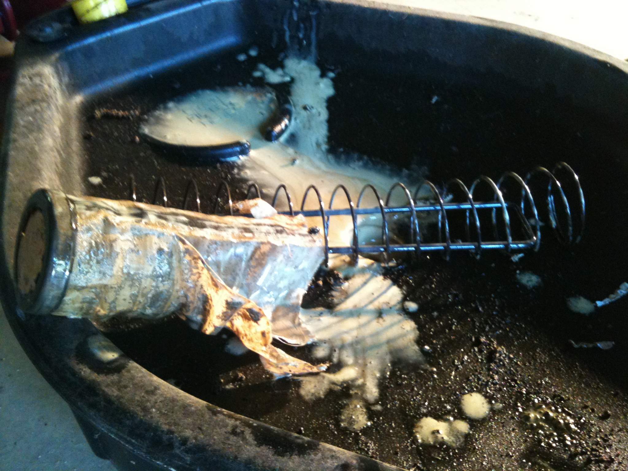

The screen under the 3-bolt panel on the bottom is destroyed. Is it bad to run the tractor without the screen until a new one arrives? I would like to fill it back up with fluid for the time being. I guess I will be ordering some parts soon.

I wouldn't run it with out the strainer

I discovered a previous owner used the wrong O-ring and this had cemented that filter solid into the transmission. I destroyed the filter tuggin it out all bent. (Photo).
That was back in 2003. After I sorted out the 'deferred maintenance' issues it has been trouble free ever since. Your result should be the same.
I suggest flush the transmission sump with diesel and scrub it with a toothbrush on a stick or something then mop it dry while you wait for the new filter. Then the new filter should be good for years.

it probably got ripped up with the gungy fluid trying to be dragged through it. that old oil has lots of water in it and has for a long time. even after a diesel wash i would run fluid for about 20 hours then replace it whilst hot just to be sure as you may find one day it has done some damage.

I had a feeling that is what this one looked like at one time. This would be a typical On The Cheap VN. Repair to me and it was complete with Forma Gasket instead of a O-Ring also. I decided best just to replace it.

If you rin it without the screen it wont be any worse than that one prolly, but it will suck pieces of metal and circulate anything that may be there through your pump, which can cause extra wear and also stick your 3pt valve open. Id wait and get one from Hoye with the gague or sensor that you needed. If you fill it and run it with the old one you will ahve to drain the whole thing again to put the new one in, if you catch it in a clean bucket no big deal but i would not use your normal drain pan.
