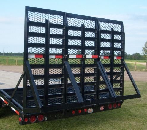

I made mine with steel exhaust pipe tubing;
/ Trailers With Equipment/Landscape Gate #30
Same idea. Very nice job. Just need something to contain the spring and cable, especially if it decides to let go.

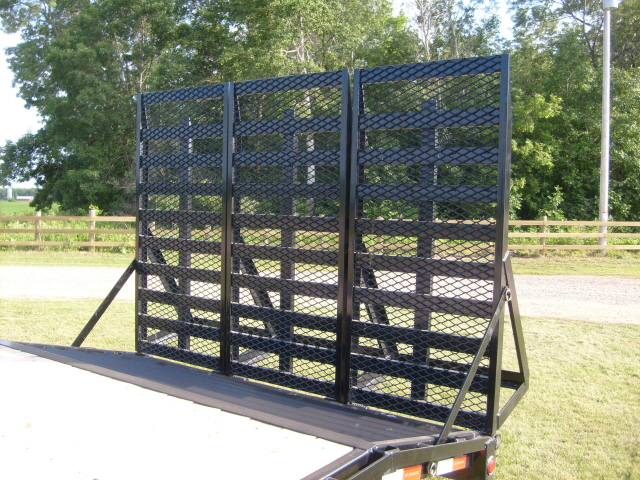

Back in December I bought a 2006 24' Titan gooseneck car hauler. This spring I built a 5' split gate for it.
Gate is 2" tubing 3/16ths, and 2X3 angle 1/4". Has double pivoting hinges, and helper springs. Gate folds over and sits on the deck or I can stand it up. Have 3 sets of bars for different angles.
/ Trailers With Equipment/Landscape Gate #33
Nice job. Like how it folds low and like you said, with your 3 different sets of bars you can do what is needed for the load.
Chris
