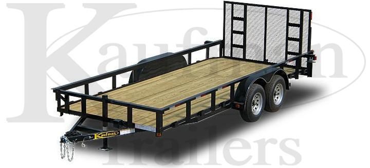

Does anyone know any trailer manufactures that make a trailer with a equipment/landscape ramp except for Kaufman??? One with a gate like this:

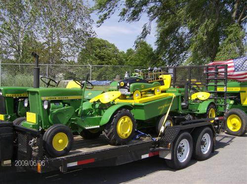

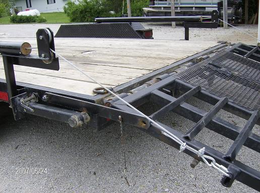

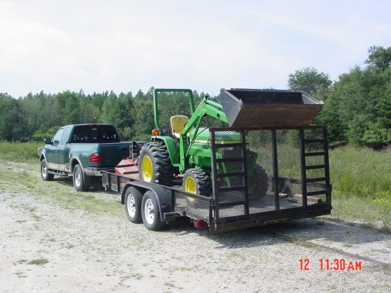

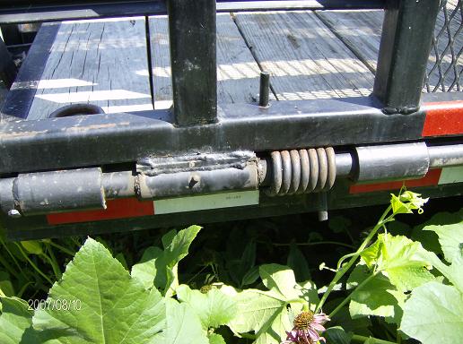

My 8-12' x 16' Woodworth (a local trailer co.) has a 5' ramp-gate w/ added 18" extension. Has coil springs around the pivot pins, plus when I added the 18", I put garage door springs in exhaust pipe tubing on both sides.
In my case, after cancer treatments, the 5' HD ramps got to be too much to handle! I haul multiple garden tractors, my JD 790, & 550 Mule, so a ramp-gate works much better for me than individual ramps anyway. ~~ grnspot110

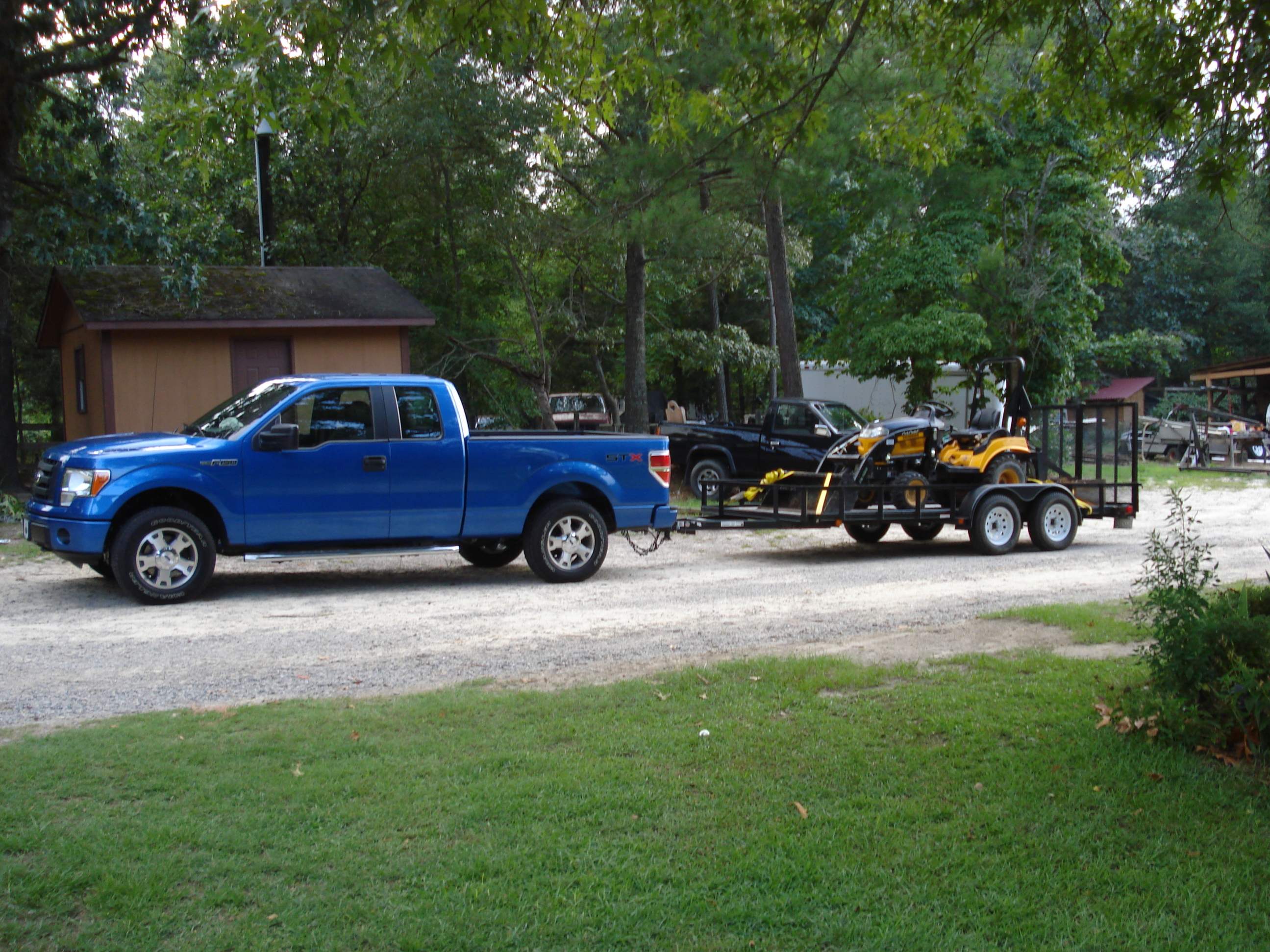

Here's a pic of mine. The drive on rampgate is heavy, but it also has TWO springs to assist with raising/lowering it. :thumbsup: I really like the drive on rampgate, it makes it quick/easy to load/unload just about anything that will fit on it.
The trailer is made by Diamond C Utility trailers out of Texas. Mine is the Road Clipper "PaceSetter" utility series, but it's 22 yrs old and they call this line by a different name now. It's been a good 'un though for the 12 years I've had it! No broke welds, but had to re-fab the little tabs for both latches on the rampgate though. They were broken off when I got it. The paint has turned to a nice shade of rust though. :( Check out their website.

Yes, I know almost every manufacturer will offer a mesh landscape gate, but I'm looking for ones that have the "ladder style" heavy equipment ramps built into the mesh gate like the one in the picture.
