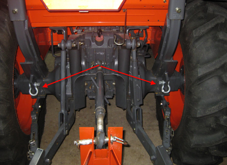

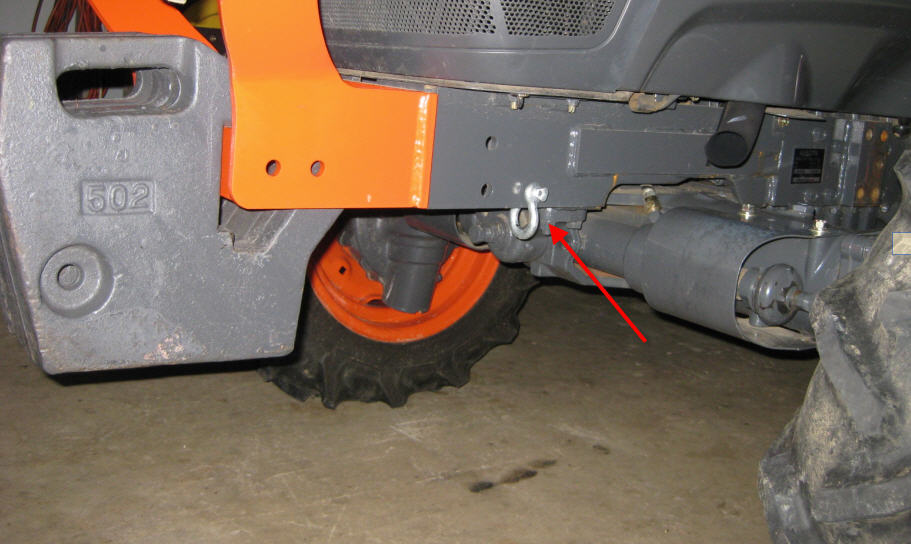

I have a new L3240 and use it away from my house so I have to trailer it all the time. This is how I strap mine down. I bought clevis's and attached to the frame at 4 points, 2 back to front. Then I bought racket straps from
Ratchet Straps, Tie Down Straps & Cargo Load Bars Manufacturer the 2inch ones with extra cordura sleeves- had to get orange:thumbsup: As long as the strap are not rubbing metal they are o.k. each strap is rated at what the tractor weighs and I have 4 of them. Might be over kill bought it is easy and holds strong. I used chain at first but like this way better. Pull tractor forward on the trailer and strap her down.

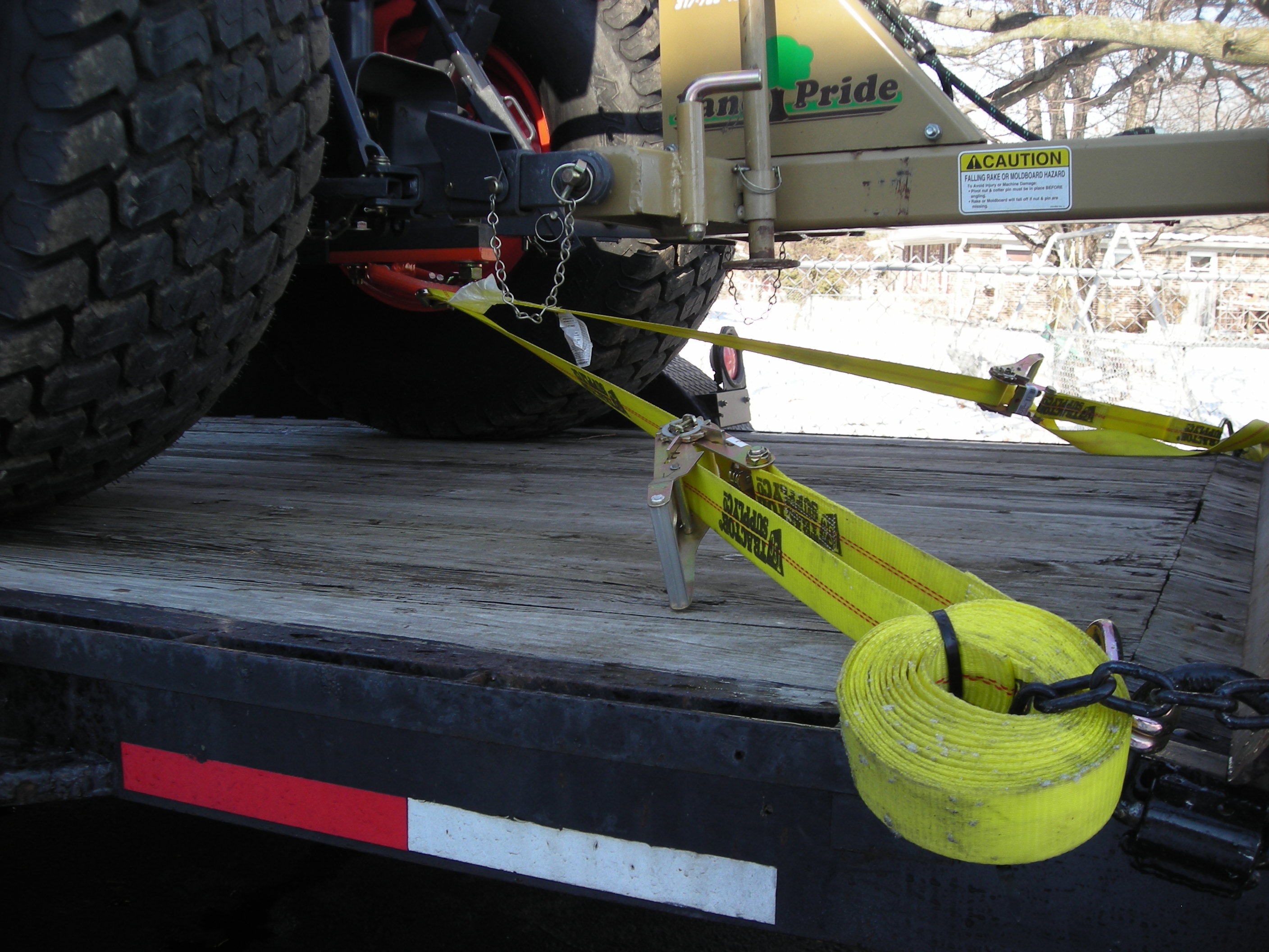

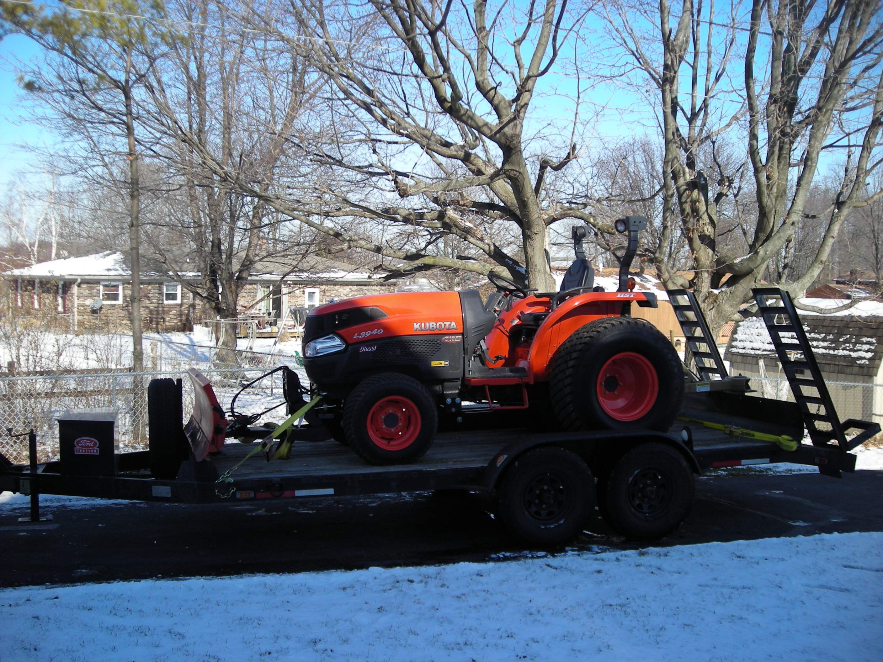

Here are some other thoughts. I like to drive on frontwards, always thought it looked kind of stupid seeing a tractor going backwards down the road! Philip.

What's the name of the implement on the back of Philip's tractor in the picture with the FEL attached?
/ Trailering a tractor #17
This one?
From the list of implements in his signature, I would guess it to be a 6 foot pulverizer similar to a Landpride SP30.
Aaron Z
/ Trailering a tractor #18
It is an older Gill/Woods 6' pulverizer. It is an I-beam with two rows of spikes and two spring loaded rollers with smaller spikes. Great for braking up dirt clogs as a final preparation before planting grass seed. Philip.
