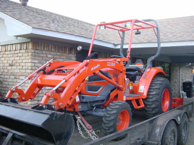

Malk,
Bob has made some good points. I use 4 chains with ratchet binders. I bought 2 grade 70 5/16 - 20' chains and cut them in half and added grade 70 hooks back on the cut ends.
I chain the front through frame rails. (Hook opening facing down/outside - chain runs from inside frame diagonally to trailer.) I hook the back chains onto the rops mounting bracket. I am not worried about scratches since safety outweighs looks.
If you are worried about looks and ease of use, invest in the j-hooks that wreckers use. You could easily get some rubber tubing to cover the hooks to prevent scratches. If you use this method open end of hook goes down.
I would also look for a 16' trailer minimum. If you have any attachments that you want to carry with you there will be limited room for tractor position adjustment for best weight distribution. (I wish I had went 18 but the price was right.) Also if you will be using your Nissan, invest in a weight distributing hitch. Proper load placement is critical and a weight distributing hitch will help to move some trailer weight from the back axle to the front axle of the Nissan.
I attached a picture of my CK20 w/RFM on a 16' trailer and as you can see there is not an inch of wasted space. When I have more that one attachment with me, the balance of the load gets a lot harder. I had one load were I was off by about 3" and talk about a fun drive. I was not able to go over 45, I ended up stopping and moving almost everthing to get the load balanced correctly. (I have no pictures of that load, but it was loaded.)
Kurt

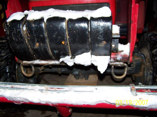

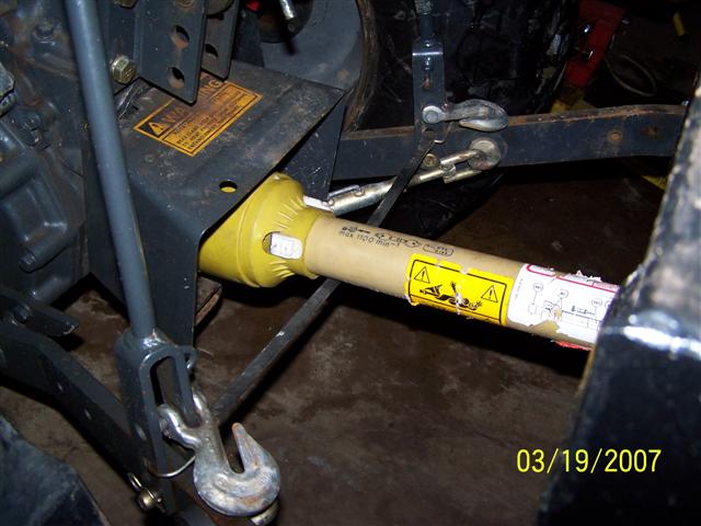

I use 3/8" chain and ratchet binders at each corner of the tractor.
One pic shows two D-rings I welded to the bottom of my loader frame mount which is bolted to the tractor frame. I pass the chain through the ring and the other end through a D-ring on the trailer then tighten with the ratchet binder. Prior to the D-rings I ran the chain over the loader frame mount.
On the back I added a grab hook to each lower 3 pt. arm. Chain goes from that through another trailer D-ring and another ratchet binder.
If you are worried about scratching your paint, go to your local firehouse and ask if they have any firehose they are getting rid of. You can pass your chain through the hose as padding to prevent scratching.
