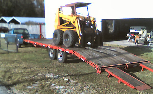

I don't know, I am tired of debating.
I know I am HIGHLY ILLEGAL the way I am running. I am having a big problem deciding what to do right now. I am thinking about selling my three axle trailer that has a 24,000lb GVW and going to a 2 axle trailer that has a 14k GVW and going to a mega cab dually (Dodge) which has a GVW of 10.5k instead of 12.2K like the quad cab dually we run now. Or going to a Chevy crew cab dually (I have one ordered) with an 11.4k GVW. Any of those combos would get me back under 26k and out of the troubling territory I am in now. I have just gotten to like being able to haul two trucks and a Jeep all at once. I am thinking about going to this trailer here and having them make it about a 40' deck instead of the 36' that it is. I'd be losing 8' of deck and one axle. I would put 14 ply tires on it instead of those crappy 10 ply they come with. The trailer I have now came out with 10 ply tires and I had trouble, switched to 14 ply with metal valve stems and 100psi and have never had a flat or blow out since.

/ trailer weights 9990 or 10000 #44
Why don't you get yourself a medium or heavy single axle tractor with a 5th wheel and tow any trailer you want? Just get your CDL and get it overwith. You know you want to have one. ;)
Chevy Crew cab, huh? I thought you were "Cummins" Luke? ;)
/ trailer weights 9990 or 10000 #45
Sound to me like it is time to move to real truck. Some type of single axel road tractor and proper trailer to get the rating you need to be safe. Then there will be no gray areas with scales, CDL, fines Etc.:D
I like the big Michigan specials with 26 to 42 wheels where you can scale 18 bushel on the steer alone:cool:
Michigan is much like Builders state, They take your plates and park your rig if your all out of compliance.
