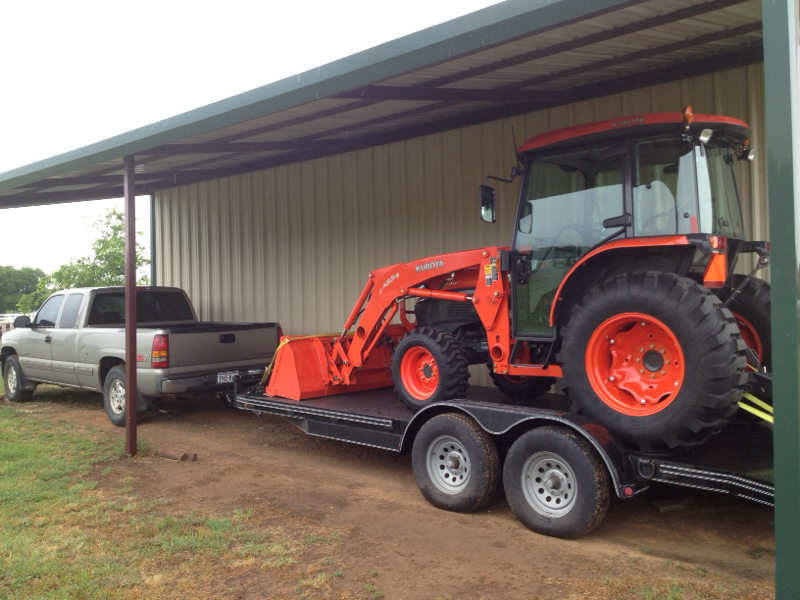

Y'all are getting off topic - can the guy SAFELY haul what he needs to where he needs to is the problem. He's not talking about doing it often, it's a one time haul. Mileage per gallon may not matter.

The answer is yes he can safely haul it. Provided his numbers are correct, he is within the rated limits. And those ratings I am sure get a level of safety built in.
Only thing I would check is see what the trucks hitch is rated for. Make sure it matches the load.

Will it safely tow it yes. I pull 8,000 lbs behind 2004 1500 suburban. Bobcat on trailer. Good electric brake control, you want the kind that has the inertia braking. Brakes on both axles. Replaced stock hitch, wouldn't trust older stock frame hitch mount. Has weight distributing hitch and 3/8 safety chains with the correct load rated clevis. 3/8 load chains all at the correct load rating. It is safe, but the truck is not going to like it! What Zing stated above is correct. Don't remember if your year truck has issues or you have had issues with your exhaust manifold bolts, but.... there going to get a work out along with the rest of the truck. If it was me I would see if I could get it to fit in a u haul or Ryder truck. The pulls I make are local and if the engine blows up its no big deal to me and I have the shop and equipment to replace it.

It will do it but it will push you around.
I had my weight distributing hitch cranked down pretty good and told myself I wouldn't do this again. Borrowed my BIL's 3/4 ton the next time I hauled it and it was a dream. Now I own a 3/4 ton.

Thanks everyone for the information. I ended up going through a broker and having it transported to me. My tractor is currently coming out of Vermont and should be in Arkansas tomorrow or early Thursday.
