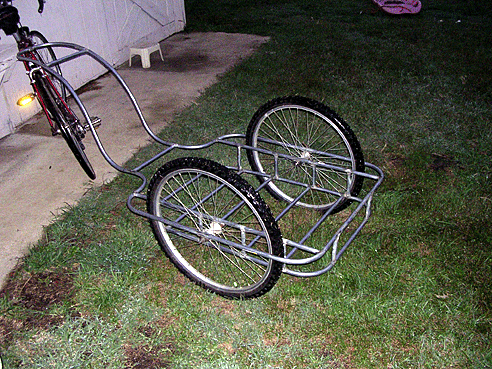

I have this idea to build a trailer to pull with my bike - for small local shopping and such. Already have two mountain bike wheels - they were free from the landfill. No for the frame, I see two ways to build it (I don't feel like making it wooden):
- weld it from square tubing say 1/2x1/2"; the standard, just like my big trailer, onluy scaled down and light
- use 1/2" steel conduit and tubing bender, bent pieces welded together. I dont know if there are any issues with welding conduit except the galvanization.
Any other idea? I considered plastic conduit, since it is used for soccer goals and such, but I dont trust it too much.
The trailer should carry 100 - 200 pounds, depends on situation and distance.

When my son was 10 I made a sidecar for his BMX bicycle out of EMT with a flat 10 gauge aluminum deck. was tricky welding with a stick welder but it outlasted him & the kid he later sold it to. It would carry my 200 lbs. MikeD74t

Thank you guys, I did my research and found probably everything what is out there.
One of the best plans I think is this one: Backpack frame bike trailer - Appropedia: The sustainability wiki. Simple and recycling too.
Another one I found was made from an old aluminum ladder. I think I will use the conduit after all - unless I can find some aluminum structure to modify.

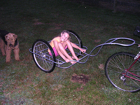

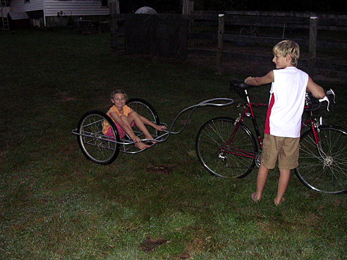

Well, here it is after successful test ride:D

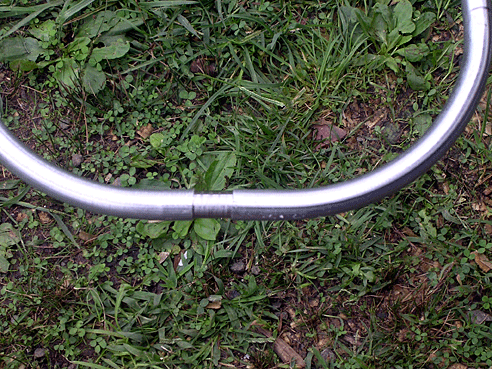

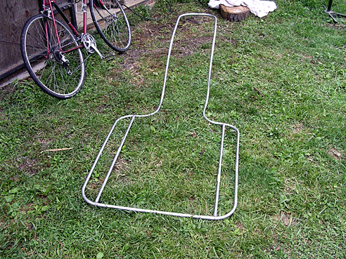

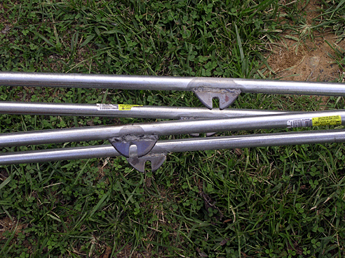

Wheels are from a bike I found at the dumb, the frame I used metal conduit (btw the bender works like a charm, could not do without it) and odds and pieces are mainly scraps from an old lawn mower.
It took some effort to get good welds on the conduit but it is pretty sturdy.

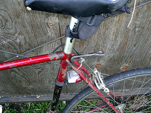

The hitch has a rubber bushing to avoid the clanking and the trailer is secured with a hole, washer and a pin.
I hooked it up to my beater bike, because it is steel, but since it hangs from the saddle post bolt, it could possible be pulled behind the full carbon too.
