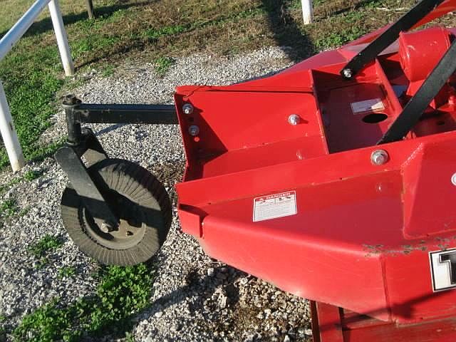

I have a JD 790 w/loader & 5' finish mower, just fits on my 16'. Your BH is probably heavier & longer than my finish mower, so 18'+ would probably be a better choice than 16'. Centering weight is not a problem for me since my axles are farther back than most trailers.
Also I'd consider 5000# axles over the 3500#, with trailer weight, & any extra tractor weight (loaded tires or wheel weights), you may be pushing the 3500#'s capacity.

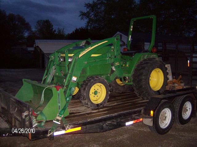

Here's a picture of a L3200 on 18ft trailer,I would go atleast an 18ft with the 5k axles like mentioned above.kubota on trailer.jpg and this is what it would look like on a 16footer16ft.jpg
