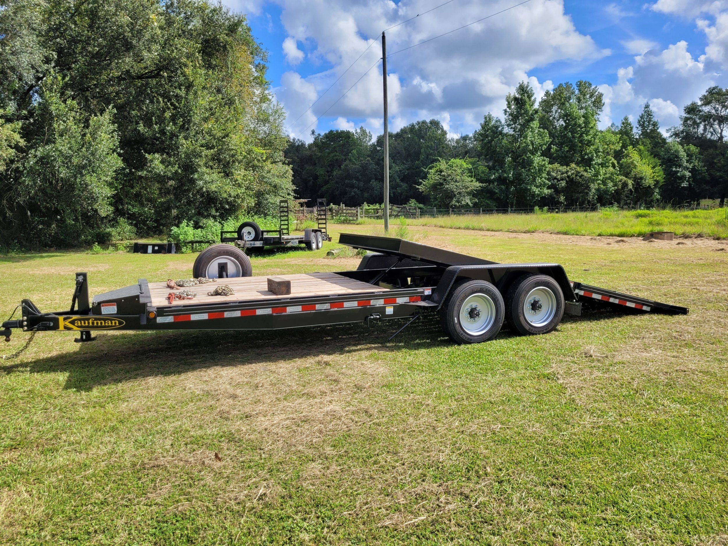

Have a 2014 Mahindra 5010, a 50-hp tractor with FEL and bushhog. How big a bumper pull trailer do you think is needed? Could remove the bushhog, but leaving it hooked up, what's needed such that it isn't a big hassle to load? Prefer this to be a utility type trailer such that it could carry firewood or a UTV and ATV.

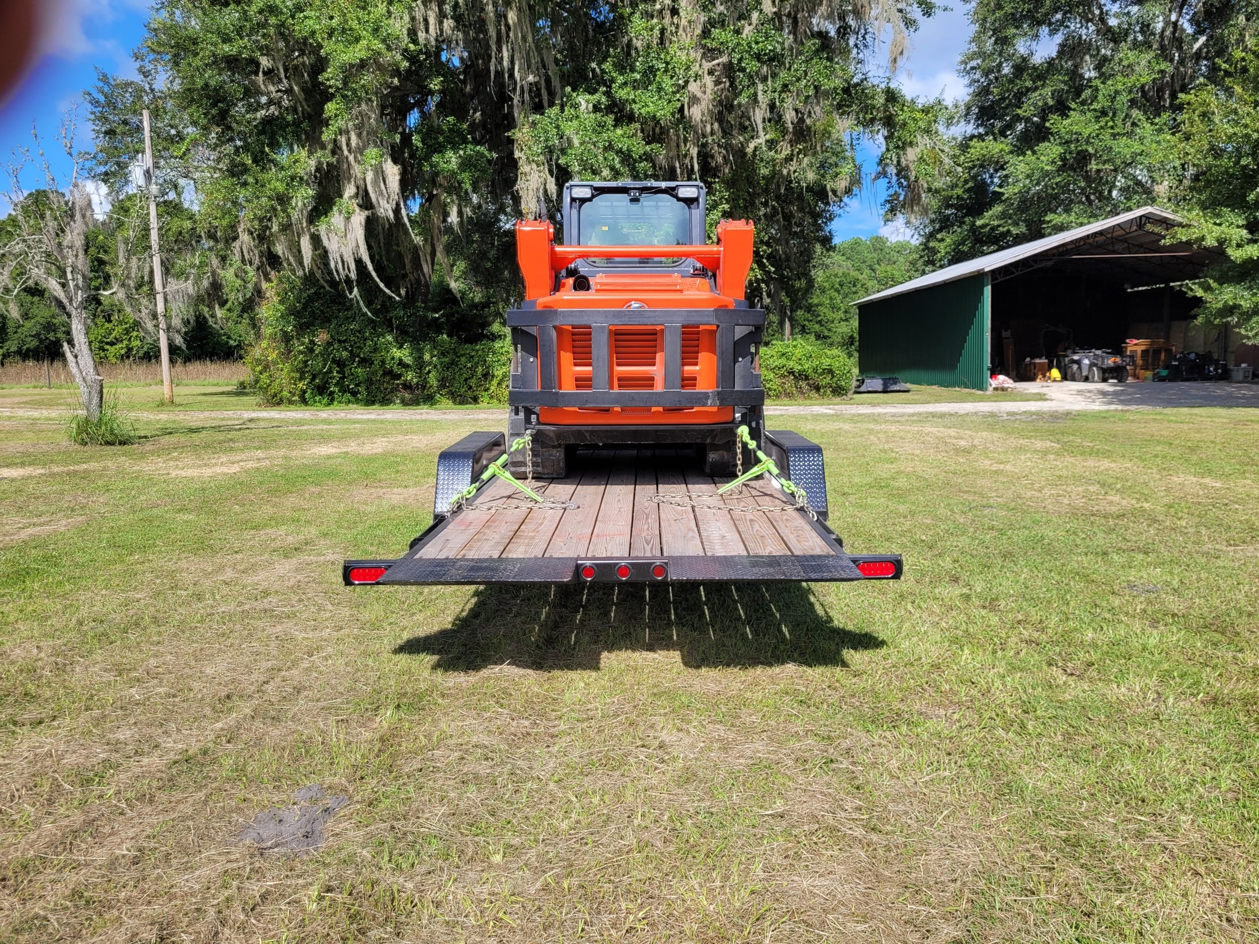

Have you considered a tilt deck trailer? I had a 20' 14k equipment trailer and I was using it to haul my skid steer and it was really over loaded, so I started looking at tilt deck trailers and found Kaufman, you can buy a 22' tilt deck trailers from them for less than 7k, I upgraded to the 8k axles and 17.5 tires and it was still just a little over $8k, that extra 2' allows me to put the tractor I mostly mow with on it without the tail wheel of the bush hog hanging off the trailer, did I mention I don't miss messing with ramps.
