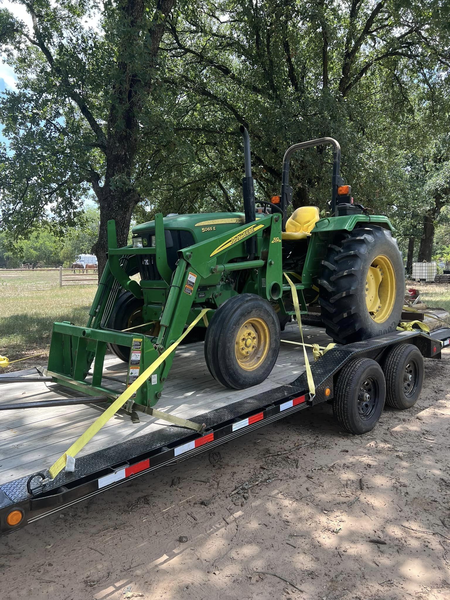

It weighs more than my TC45 DA.
The way I was loaded in the pictures I posted earlier here my total weight is 16,440 lbs (gross) and the tractor as shown with the flail mower scales at 6,520 lbs.
I wouldn’t want less than a 10k trailer and that leaves you very little extra capacity.

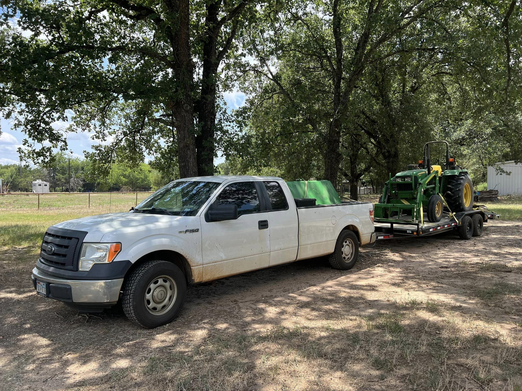

I hauled a 5065E John Deere with a 6 foot bush hog on a 20 foot bumper pull trailer. The trailer was big enough for this, but to get it balanced right, the bush hog was sticking out past the trailer. I didn't see any issue with that. Pulling it with a F-150 was a little sketchy, and I wont do it again. With a bigger truck, it wouldn't be an issue.
Why was the F150 sketchy, it didn't have enough what? I ask because that is exactly what I have, lol. A 2018 F150 King Ranch. It's new to me but I figured these big, honkin' 1/2 ton trucks these days are closer to a 3/4 ton of yesteryear but I have nothing to base that on other than somebody told me that one time, lol. I do know one thing... they are BIGGER. Taller, wider, longer. Which I don't like from a comfort and maneuverability angle. I love the size of my 2008 Nissan Titan, wish I could find something these days about that size.

Why was the F150 sketchy, it didn't have enough what? I ask because that is exactly what I have, lol. A 2018 F150 King Ranch. ...
In my opinion, the 5.0 V8 engine was pretty much maxed out going up every single incline. I would get going from a stop pretty good on flat land, but it took awhile to get up to the speed limit, which varied from 55 to 65 mph. But when I was on a hill, my top speed would bleed off until I was the slow guy that everyone was lined up behind.
Braking was also something that seemed to take A LOT longer to happen. I was driving cautiously, and really paying attention to what was coming up, so I was always able to slow down over a safe distance, but I knew that if I had to stop quickly, I was probably going to be in trouble.
The last thing that bothered me was being able to feel the trailer back there. I had it tied down really well, but when the wind hit me sideways, I felt the trailer push my truck sideways. When I was going the speed limit and their was a turn in the road, I could feel the trailer behind me.
I'm pretty sure that I was legal, but I honestly wouldn't have been surprised if I got pulled over. It just felt too heavy for my truck.
