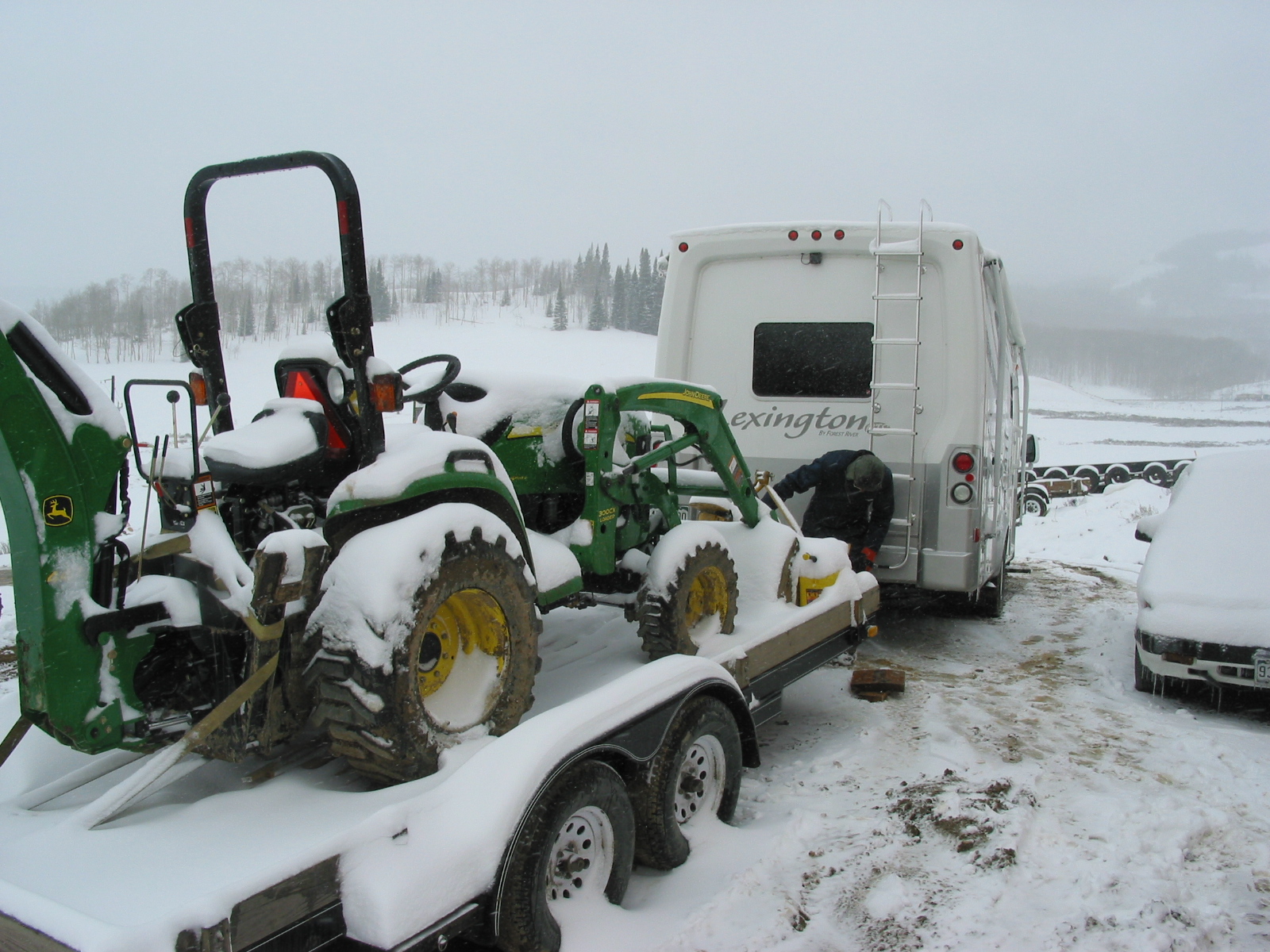

I use a 16' flat for my 3320/447 bh. I've upgrade the tires to 225x15 from 205's and re-did the spring mounts to raise the front of front spring and the back of the rear springs 1 1/2" higher ( I didn't think the axles were true ). So, I'm about max as trailer weights 1,600 empty.
Note: the picture was taken 5/18/08 at 8,500' at sons house. They had over 500" snow last year.

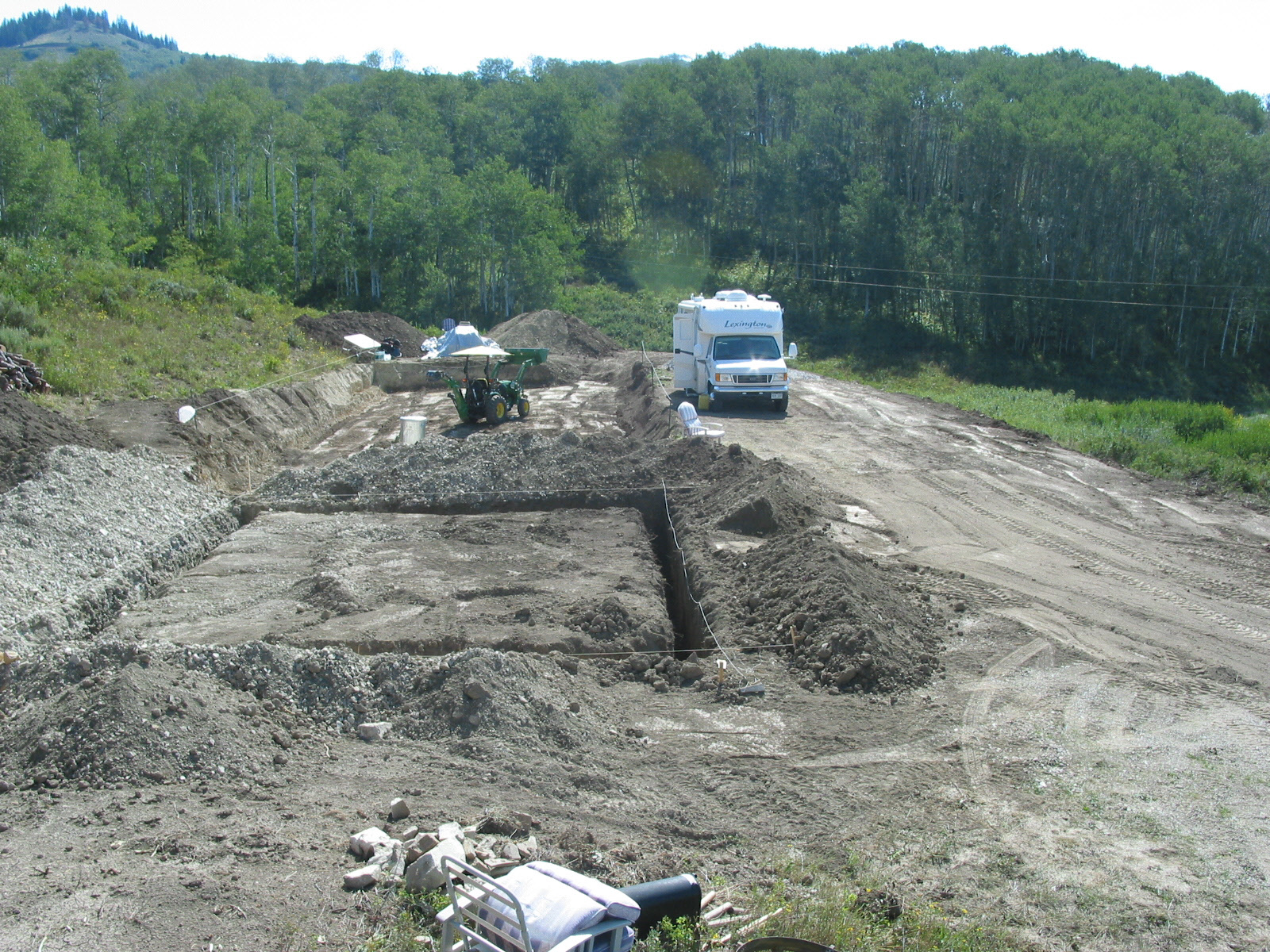

haha, they live just east of rabbit ears pass which is east of of Steamboat Springs Co. The snow come from the west most of the time in CO., well it hits there place and stalls / dumps before going over the 'front range'. We live on the front range at 6,200' and only got around 24" last year. This is why ski'ng is so good in CO. The mountains get the snow and Denver / Boulder / Ft. Collins get just a little.
Here's a google map to his place ==>> Google Maps <<== shows an emply lot. I dug his 4' basement, footings for garage, elect trench and septic in Aug 07 with a 2520/200cx/46bh. I broke it somehow and deere could fix it fast enough (hydraulic problem) so I upgraded to 3320 in Dec 07.
