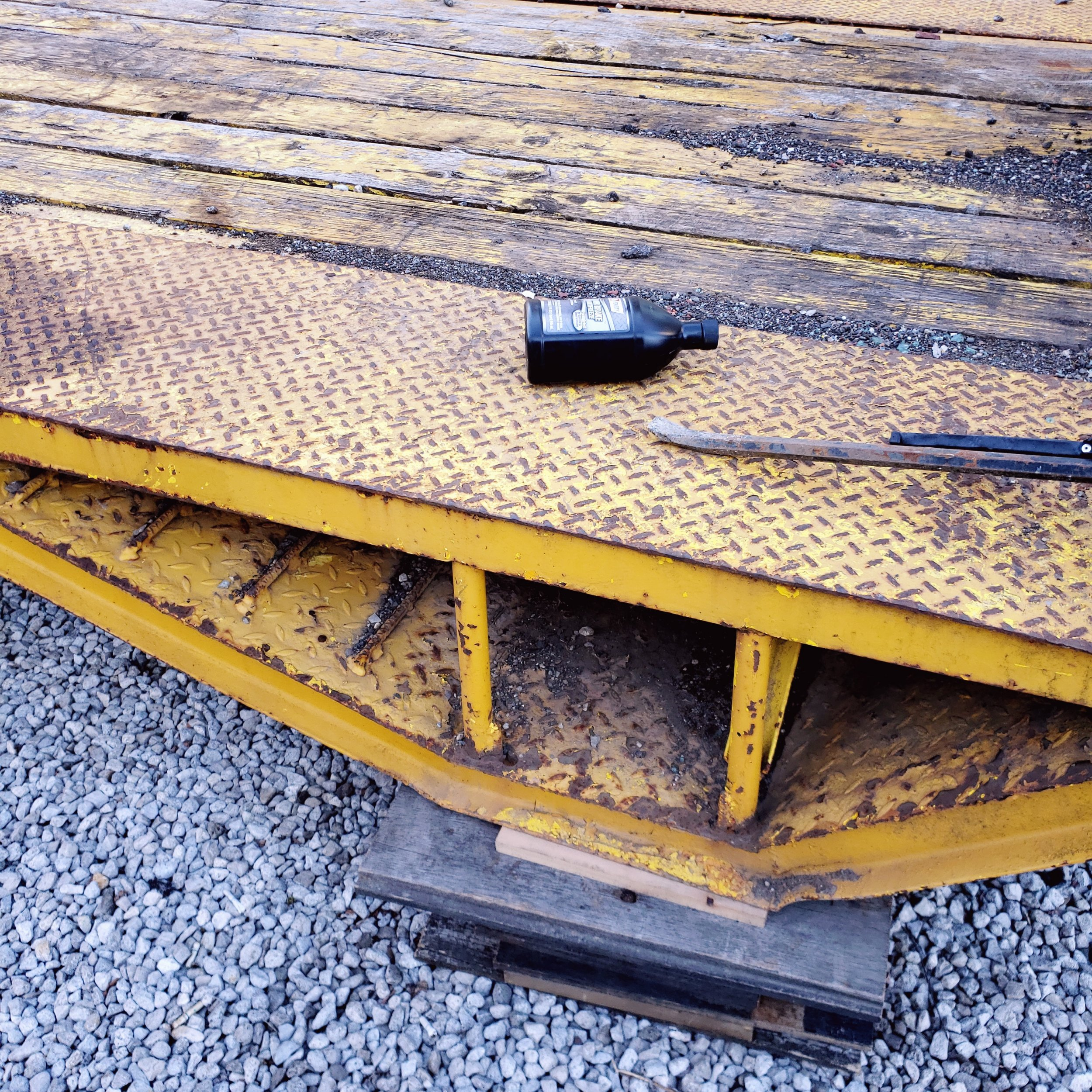

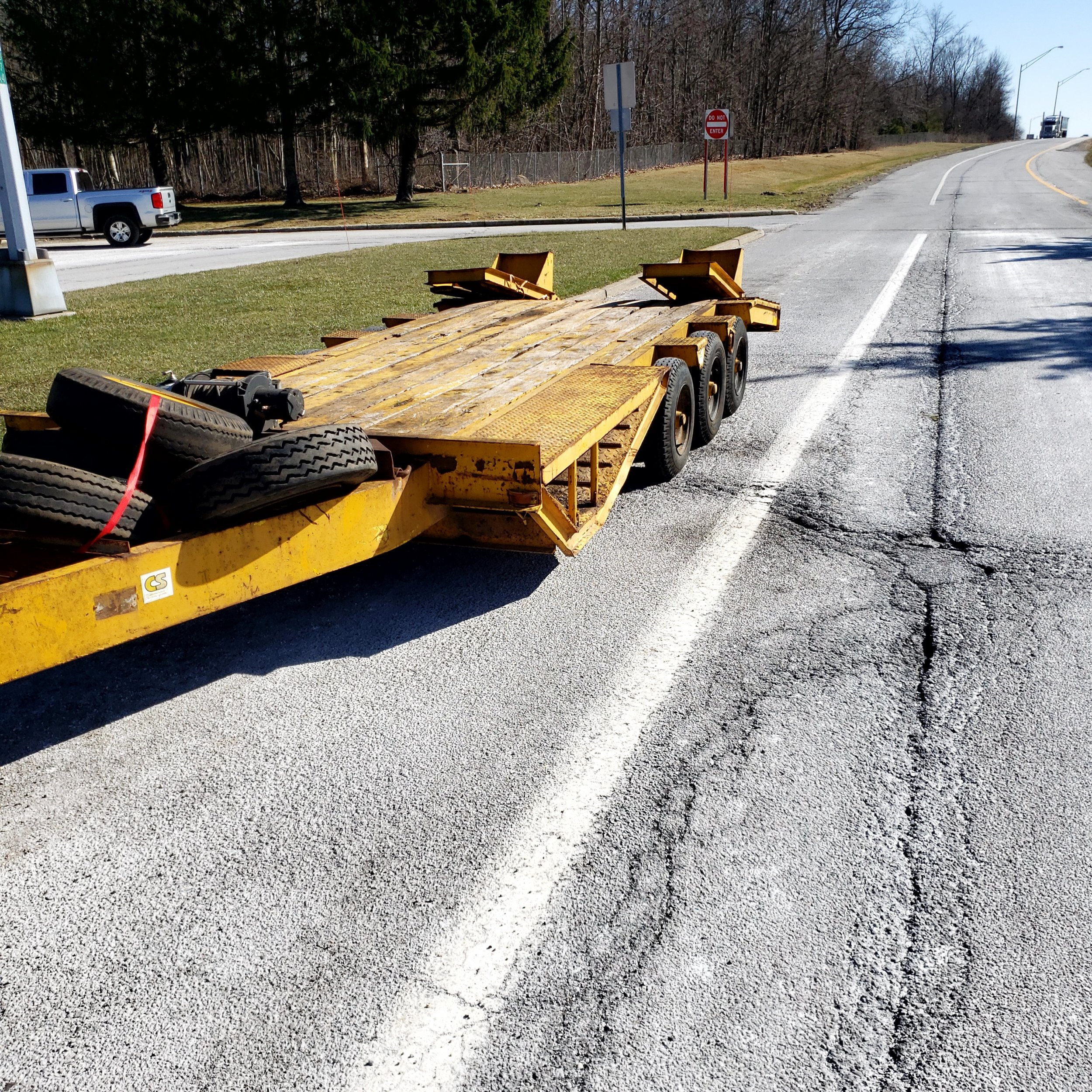

I recently sold my 555D and trailer and already miss them. Bought the trailer pictured last week to help fill the void. Much heavier duty then I need, but what the heck :)
What is the dip in the frame at the front of the trailer for? The dip does make for a nice support to take excessive load off of the hitch with a heavy load on the front before a balancing load is toward the back, but as the advertisement goes ... but wait there's more.
The dip is constructed of C-channel covered with diamond plate. Put a door on it and could store stuff there I guess. But the diamond plate has traction bars welded to it that would give traction to a wheel climbing out of the dip??? Stranger to me is the diamond plate parallel to the deck over the dip is made to be removable??
Any idea what the trailer might have been made for with the dips? Large wheel could go down in the dip to reduce the height on the trailer but not much room from the dip to the hitch.
I'll be done with the trailer in a couple months and will be putting it up for sale then. View attachment 789676View attachment 789677 I'd like to know before then what it was made for. Thank you if you have any knowledge or guess why the trailer was made that way.

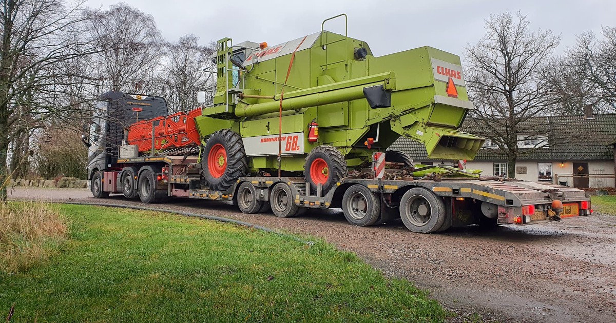

If its the top portion that is removable, definately to lower overall height on tall equipment. Some hedge rowers (used in nut orchards) are very tall, and use these.

Wheel wells. Pretty common on equipment trailers when a low loading height is required, but you dont want to haul the heavy chassis of a lowboy with its wheels behind the load
