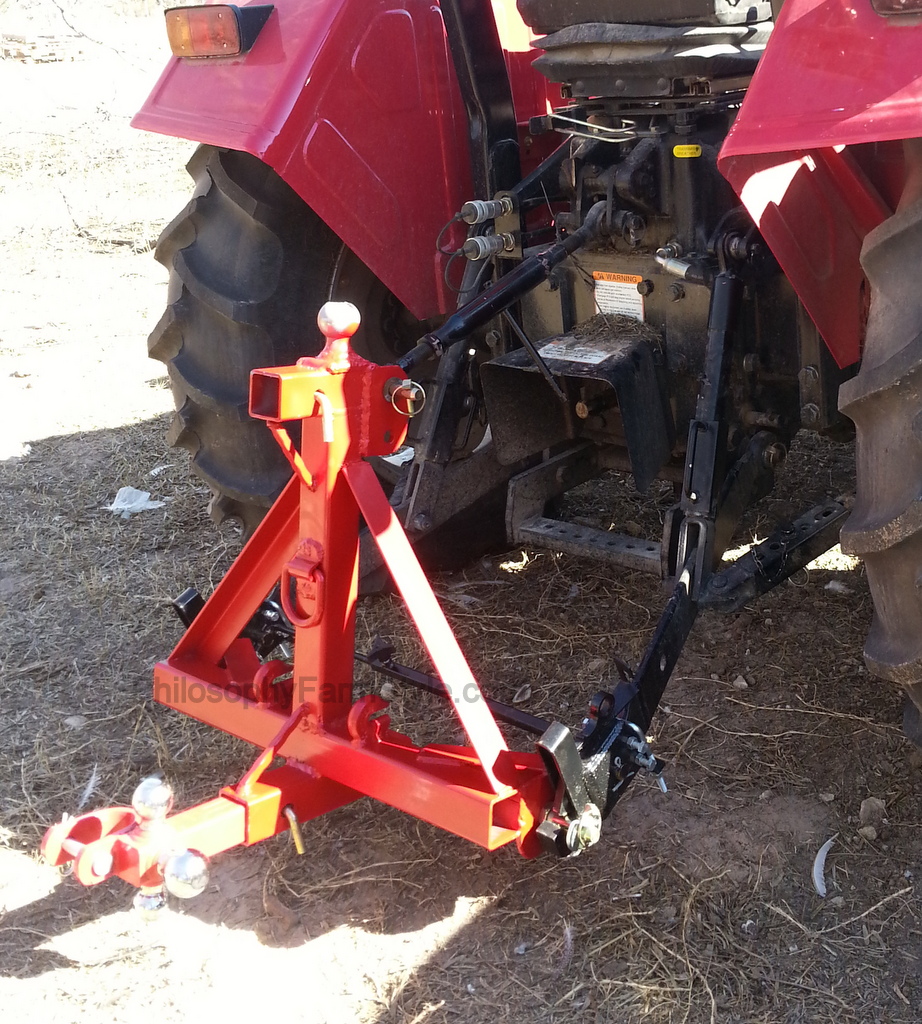

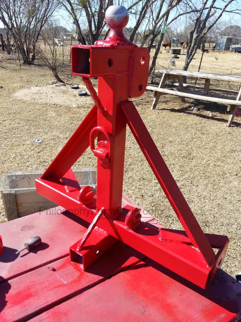

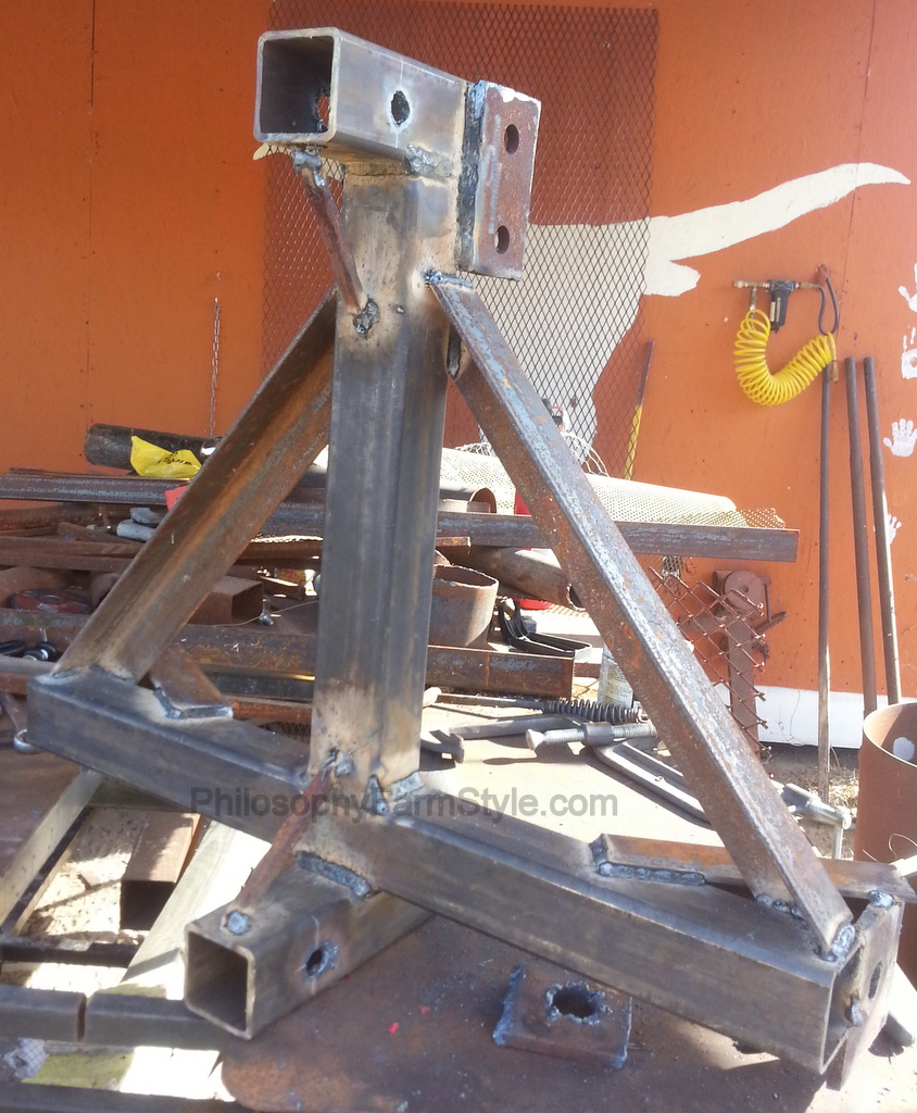

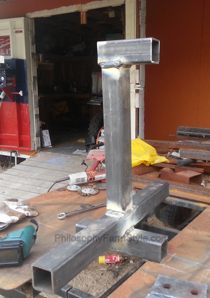

This seems to be a very useful tool and I believe will be even more useful in the future. We wanted a trailer mover, but for a $150+ tax and shipping I couldnt see buying one. So I built one.
I came up with some dimensions I thought would be suitable for the project and got started. All thou I have had compliments on it, I believe because of the paint, I still built it keeping in mind function over looks. I did add extra bracing, D rings, hooks, and a top receiver tube. That makes it more useful and did make the cost go up, but still under a $150 and you still will not find anything close to it with the possible functions that this piece of equipment will have.
I think it looks good on the 4wd 4025 Mahindra.

Nice job! One thing I would suggest adding is a limit chain. If the trailer happens to be rear-heavy or the tongue lifts going down hill, or even a quick stop, the trailer tongue can lift the 3pt to a dangerous degree. Here's a picture of what I'm referring to... King Kutter 3-point Trailer Mover. Attach the limit chain to the draw bar.
I've had my trailer tongue lift a couple of times and was glad I had the limit chain. You may never experience those situations, but I thought you might be interested any way. Again... nice job!
/ Trailer Mover
Now you tell me.....LOL. Thanx. I will definitely get something done bout that if I remember. Majority of my property is flat and if I was gonna haul long distance I would hook to the draw bar.
