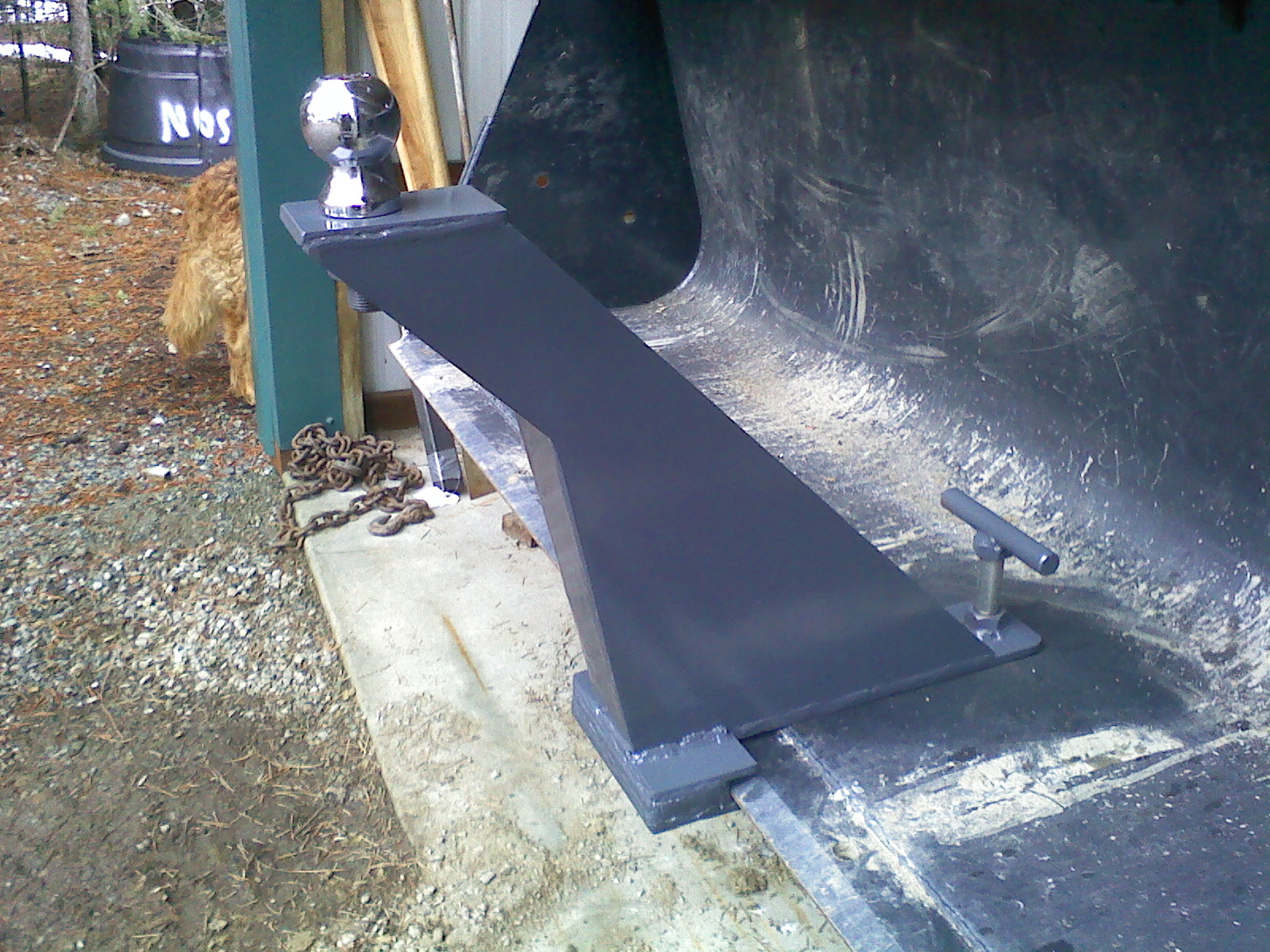

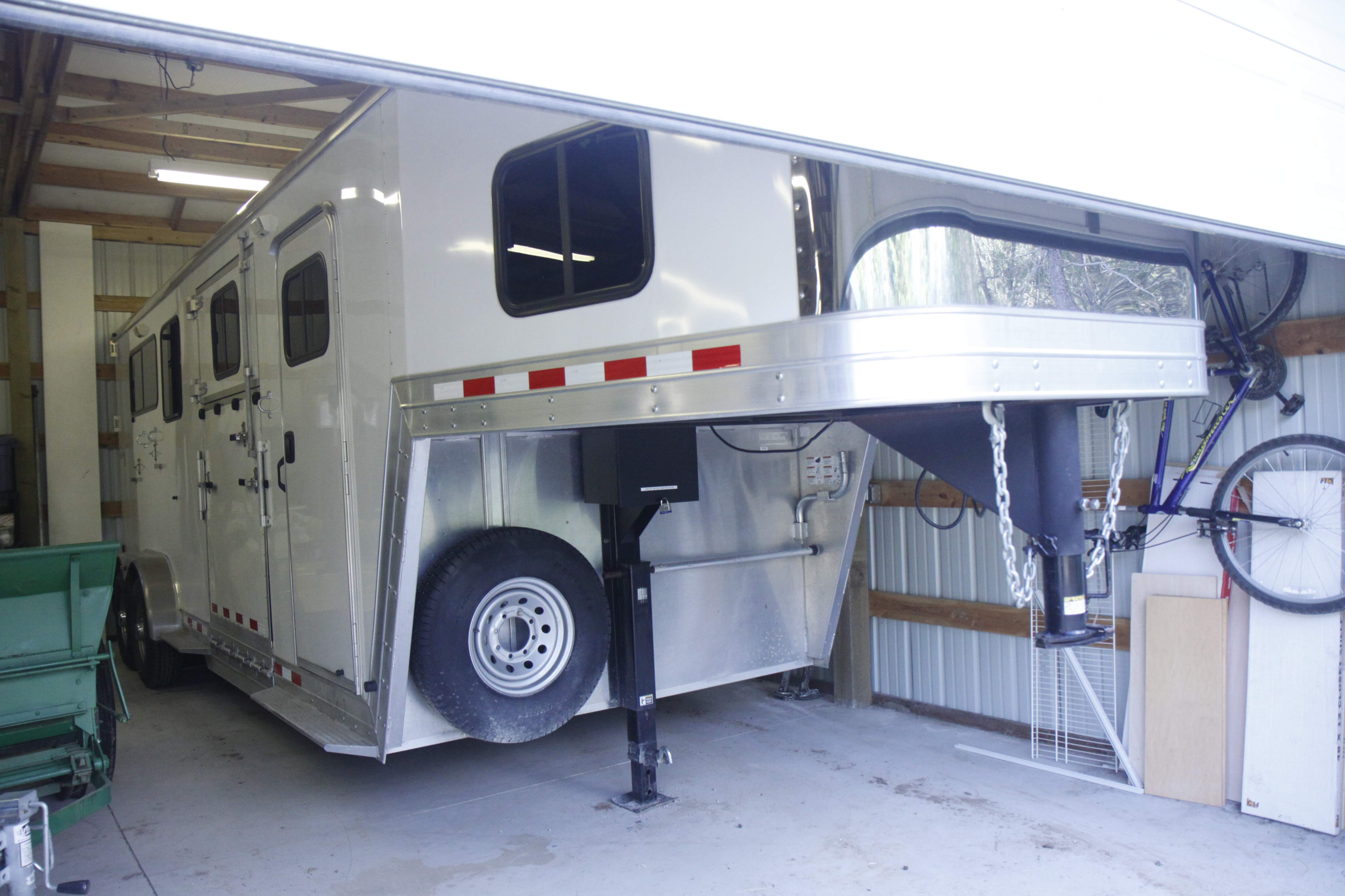

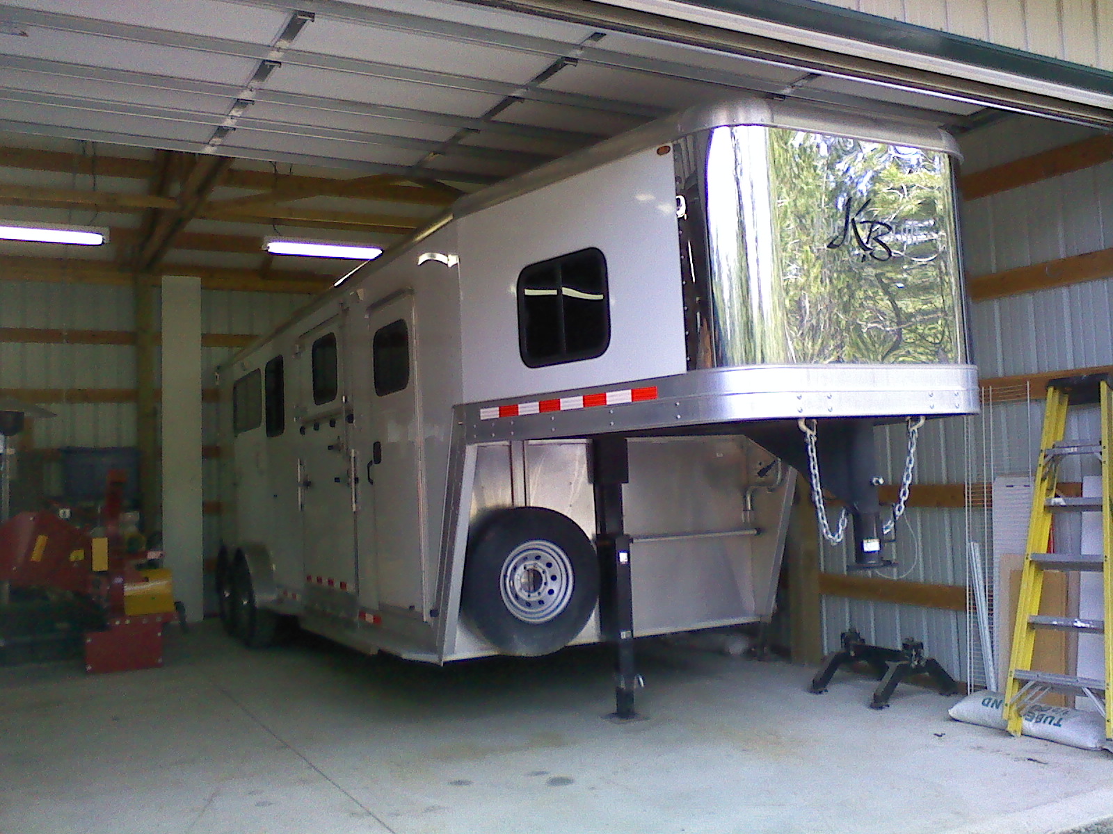

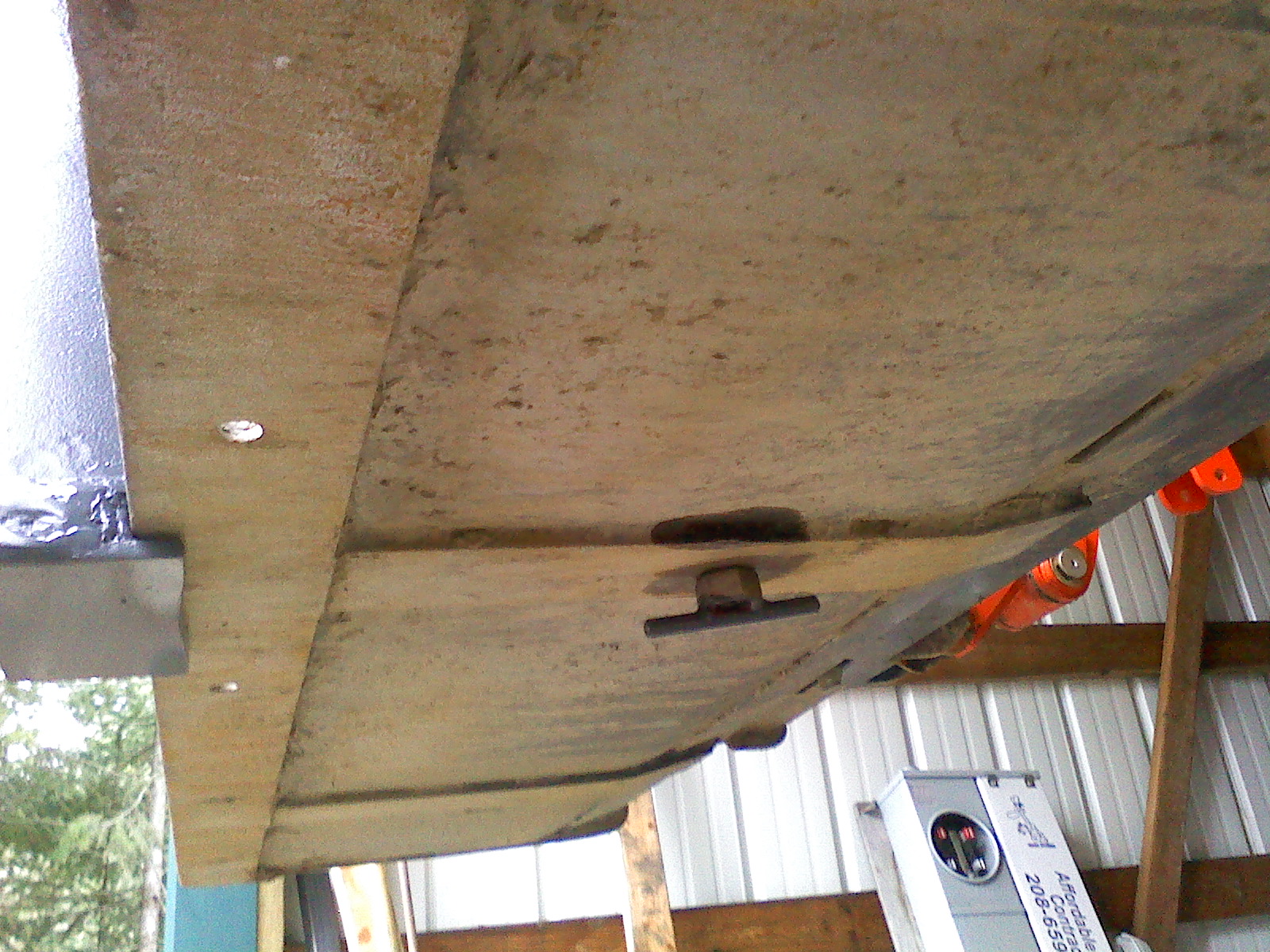

I built a simple one for my Kioti, but i have the ability to lift the weight. What is the lift capacity of your tractor. Mine is over 2,500 pounds if i remember right. My 5th wheel picks up real easy, but i do need counterweight on back.
I added a plate of 3/8" steel on top and bottom of my bucket and inserted a 1" shank 2-5/16 ball thru the resulting 1" thick steel. works great.
I made a removable 2" receiver for the smaller trailers. i had to make it extend so i could see it thru the cab without having to stand up and press face on the glass.
Its so much easier moving trailers with the FEL. you can push theme anywheres you want. I pot my 5th wheel 29'8 trailer in a 30' wide barn with absolute precision 0327111410.jpg0327111953.jpg0329111630.jpg0329111630a.jpg_MG_5063.jpg0403111220.jpg.

Its so much easier moving trailers with the FEL. you can push theme anywheres you want. I pot my 5th wheel 29'8 trailer in a 30' wide barn with absolute precision.
Yours is a gooseneck trailer. A fifth wheel pin doesn't stick down as far, and uses a plate to latch on the pin.

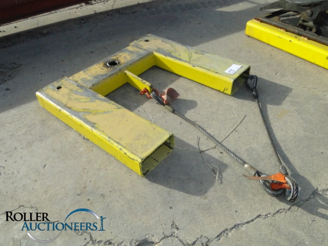

This will fit, from: Worksaver Pallet Fork Attachments
This company builds attachments for GC: Hay Farm Equipment | Skidsteer Attachments | Hay Spear Attachments
I used a piece of channel iron with a 2 5/16 ball to move my old gooseneck.
