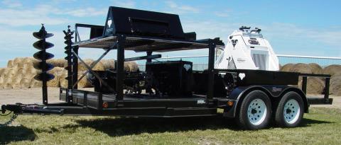

I have a trailer that I use for hauling my PT and some attachments around. The main problem is that I can only haul about two attachments.
Does anyone have pictures of the attachment mounts on the PT trailer? PT's pictures do not show this well.
Also are there any suggestions on how to modify a trailer for this? I will try to attach a trailer picture tomorrow.
Is it OK for an attachment to hang over the side and past the fenders? This seems a little dangerous, but would allow a pretty easy addition of at least two attachments.

It's a little hard to see from the picture...but I mounted my York rake, Mini hoe and both buckets on the trailer sides, but I kept them all within the width of the trailer..they did not extend beyond the fenders. I built a V-nose on the trailer front so I could also carry the brush mower. The trailer was a 5' x 10' before I added the v-nose.
Next time I'll buy a larger flat bed trailer so I can mount attachments on the bed instead of on top of the side rails. :D

I agree. I don't think we have addressed this here to any great extent. So how have other people stored attachments on their trailer? Let's get some pictures and drawings.

Thanks for the picture, but we need more. Can you get some closeups and pictures of the hold downs and mouting brackets? My trailer is similar to yours.

I would like to see what kind of supports people put under the attachments. I am thinking that angle iron would be good. Form a frame the size and shape of the bottom of the attachment. I am thinking that I would like to put the 4 in 1 bucket on one side and the grappling bucket on the other.
I keep my trailer on a small carport. If I could store attachments on the sides then I could possibly leave them on the trailer most of the time.

Well what if we all post some pics of other brands. Maybe it will spark some ideas

We have an 18' dual axle car hauler. I chain the PT down because I have a tendancy to knick the web straps and cut them. When I go out "to play" I usually put the forks in the small bucket, the small bucket in the large bucket, and put that at the front of the trailer. Then I hook up my brush hog to the PT and back onto the trailer until my rear PT hitch touches the buckets. I then run a large chain from the two front tie down points on the trailer to the hitch on the PT. The chain goes over the buckets in a V pattern and pins them down. I drive forward until the tires spin, then set the brake. I chain the front down from the two rear tie down spots to a hook that I have welded onto the front of the PT. This forms a V over the brush hog. I put that one on as tight as I can, then take the brake off the tractor. I use a load binder to snug up one of the chains. This forces the tractor to roll forward or backwards and squat on the tires and tighten the other chain in the process. Reset the brake just in case and off I go.
I have thought about mounting the buckets from the side, but since the trailer is so long, I have no need, yet. If I wanted, I could put some racks over the fenders. I would put a couple lips on the rack to slip the leading edge of the bucket under, and some tie down straps to hold it in place. For the mowers, I would but some wheel wells into the trailer deck so it would not roll, and some tie down strap anchors. For the forks, you could make a rack UNDER the deck from the side so that you could just slip the forks into the rack and then secure it with a tie strap. Lots of options available. The hard part is designing the best layout so you can carry the most toys and have the most used toys being the easiest to access.
I think a Swiss Army Trailer would be the best description! :)

Meanwhile, back to the original subject. Does anybody have pictues of the PT trailer?

Thanks for the pictures and links MrJimi. They help, but I need closeups of the holding brackets.

It looks like they are just wedging the implements against steel blocks/posts/lips and keeping them held wedged with ratcheting tie downs.

My memory from looking at them in the PT showroom is that they are simple angle iron and metal tabs, with loops to engage the strap downs. The nice thing that they had done was to really think about how to pack many implements onto the small space of the trailer bed.
They don't have a mower spot on the PT trailer. (Deal killer for me.)
