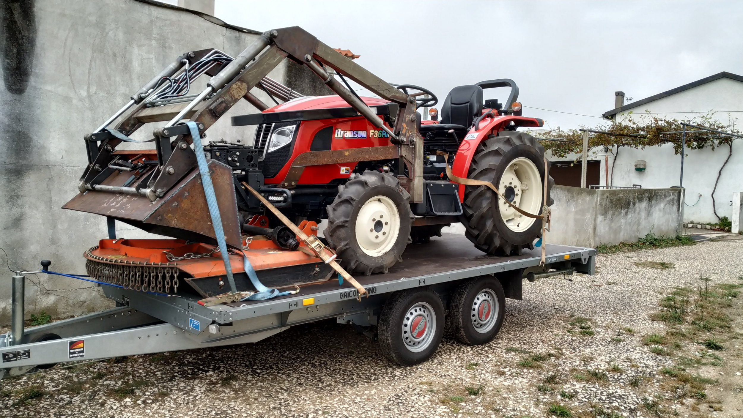

That's more or less how I load it. Although, completely different trailer (axle placement, etc) and mower but should give some ideas to consider.
I don't intend to offend. But - I would not haul this load anywhere. There are so many shortfalls it's just a matter of time before a serious problem occurs. The trailer needs a load stop in front and chains not straps. The trailer is too short for this load. It looks tail heavy.
No offense taken. We're all here to share our knowledge, opinion and learn something along the way.
Believe it or not, the trailer is well balanced loaded this way and rides nice and smooth the 45 miles it usually does with this load.
As far as chains vs straps, I would rather stay out of that rabbit hole but I'll just say those are 5 ton straps well capable of handling this load. I have three there, although I had a friend give me a bunch of straps and now I run 4, one per corner. In this side on the pond, you'll hardly see any chains used on anything smaller than 15 tons or so.
The trailer is also the perfect size my needs. Going longer means I couldn't go certain places with it, which I'm not interested in.
That is what I intend… but I have a longer trailer and as someone else said.. a “load stop” in the front.
I think yours is maybe 12-14 feet?
/ Trailer loading plan.. #20
4 meters or 13 ft.
