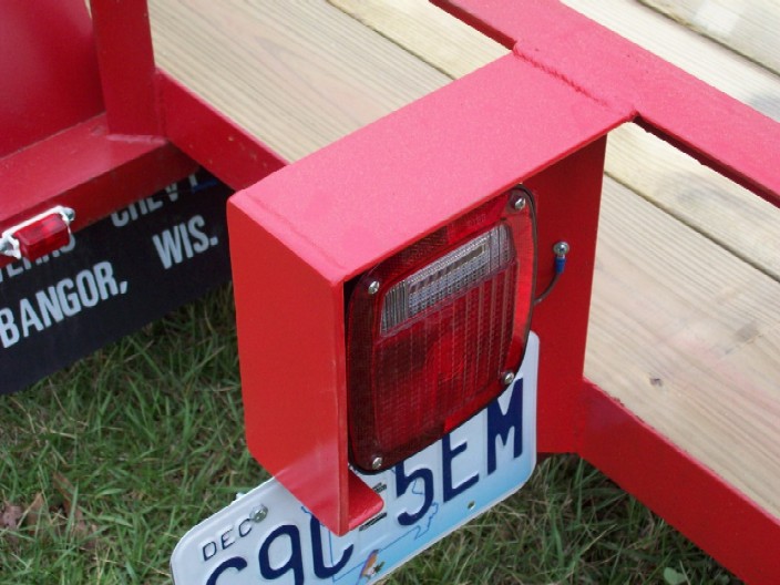

Been a long day cutting and welding, cut off the old tailllight brackets and welded together new light boxes made out of 4" angle so my lights will not get hit again, broken and knocked off.
Here is a picture of my tail lights.

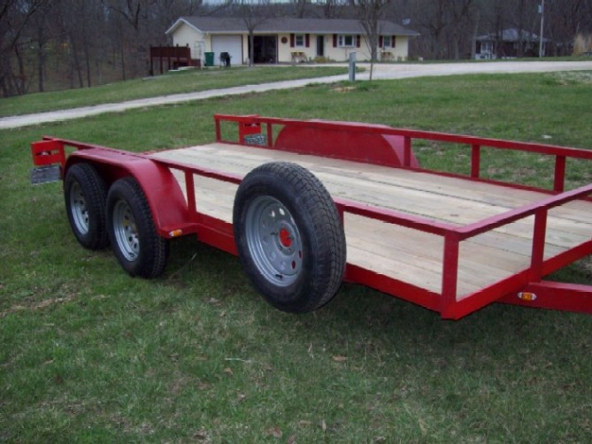

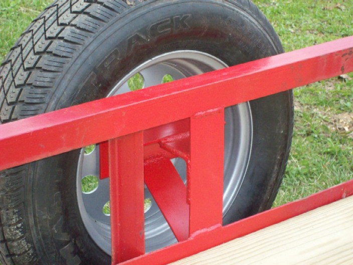

Well finally finished the taillights, they should work nice having the backup lights and extra support. Also added a spare tire mount on the side since I had the steel laying around, new tires/wheels and all this started because I was only going to replace the wood decking.

That is the way it always works. :):):)
Nice job.
Chris
/ Trailer Lights How Many? #16
Very nice restoration. I esp. like the spare tire mount. I gotta admit that i wished I did that when my tire blew out at one time and it was on a sunday afternoon, no stores open, fully loaded trailer in the middle of no where. :( Needless to say, I did what i had to do with a wrong type of tire and hobbled home with the single axel trailer. Now you have refreshed my memory and reinstate my old resolve to put a spare tire on my other trailers as well.;)
