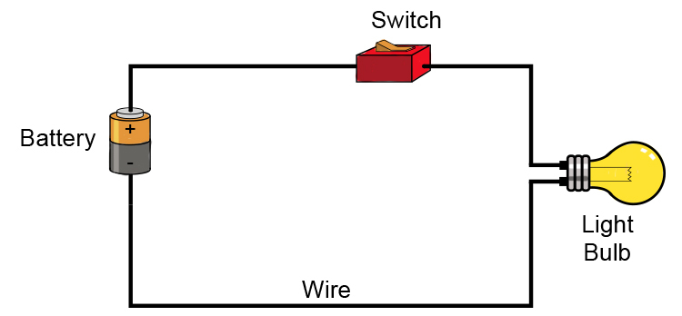

It the end it is just a "current loop" with electrons flowing from source (generator/alternator/battery) then trough "lamp" (incandescent/LED) and then though "switch" (headlamp/turnsignal) and back to source... To confuse the issue electron flow is from negative side power source to positive s
ide of power source...
   / Trailer Lights Gurus--Got a Question. #140
To confuse the issue electron flow is from negative side power source to positive side of power source...
It makes sense as the negative side is losing electrons while the positive side is gaining electrons.
Bruce
