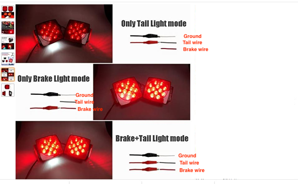

There is only one wire besides the ground wire. So the signal for all the functions has to go thru that wire. Right?
Also on LED trailer lights I think it is the number of LED's that are lit to distinguish between the various functions. (dim and bright, blinking etc)
I understand the seperate filaments in incandescent lights but, again, how the signal for seperate filaments is sent thru the one wire. (different voltage?)
If you only have two wires you only have 1 function. For running lights and brake/turn you would need three wires.
Same as in the diagram you attached.
Edit: As @herm0016 points out below, three conductors can be from two wires and ground.

hook the ground wire to the chassis at each light, and the 2 wires, individually to the 2 other wires. we are not confused. electricity is not magic.
my trailer is set up exactly like this. grounds run to the mounting bolt of the light with a star washer.

Here is one of your pictures labeled. You must have one wire for tail and one wire for stop-turn. Ground may be a wire to the trailer connector (Best) or a wire to the mounting bolt if the bolt isn't grounded (Not as reliable).

Thanks. I will give that a try. I guess the confusing part is the white wire on the trailer harness at each light location. This, to me, is ground or neutral but your comment earlier leads me to believe that the wire wire is actually is a substitute for brown for the tail lights. (running light) Then the second wire (black in my case) of the trailer harness would go to the yellow wire on the left side and green on the right side.

That fixed it! Everything works as it should. (even without the pickup lights turned on:))
The old lights only having two wires, a white and a black, and the wiring harness having a white and a black also made perfect sense that one of them was a ground. Right? No, wrong. The light mounting studs were the ground to the trailer chassis, I guess.
Not sure why the new LED's have a grounding wire instead of thru the mounting bolts. Maybe just because they are LED technology. (I did connect the white wires to the trailer chassis)
I should have figured this out a lot sooner but just needed some help from you guys.
If it were me, i'd have both (all) trailer white ground wires going into the trailer connector pin that connects to the truck white/gnd socket.
If you have the LED white wires grounded to the trailer, it sounds like you are using the actual hitch ball as the ground circuit to the truck. That will be very intermittent......

Actually the white ground wire runs from the pickup, where it is grounded to the frame, to the trailer via the 4pin connector. Then it connects to the trailer frame behind the trailer axle.
I thought, too, that it continued out to each light but therein lies my confusion and I still don't know who the hell is on first.
