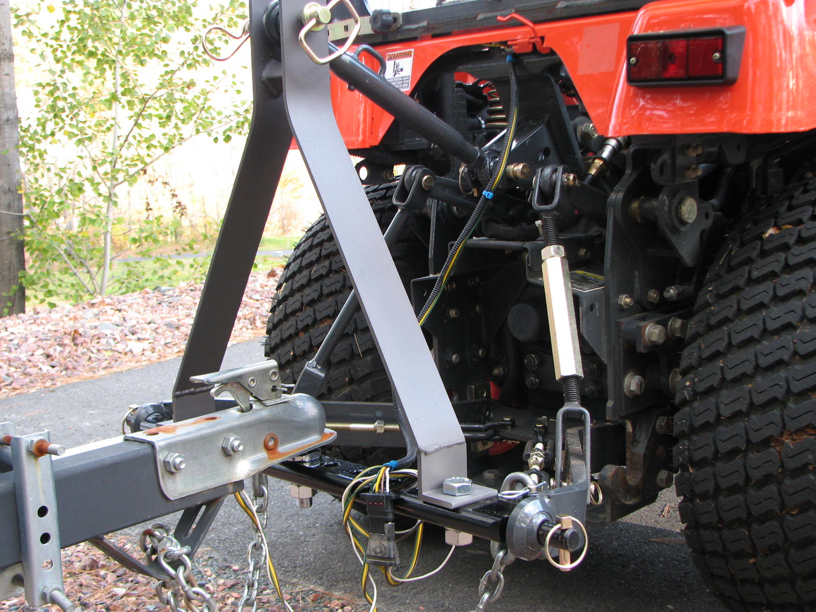

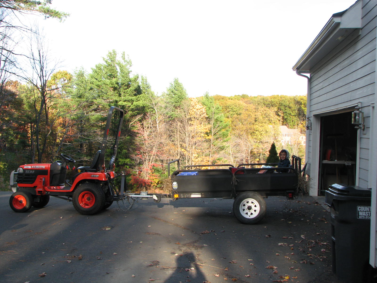

The kids had a great time riding around. Lights were on and flashing for hours without blowing any fuse. I ended up spliced the trailer light to the exsistant flasher and parking wires w/o fuses. Here are some pics.
