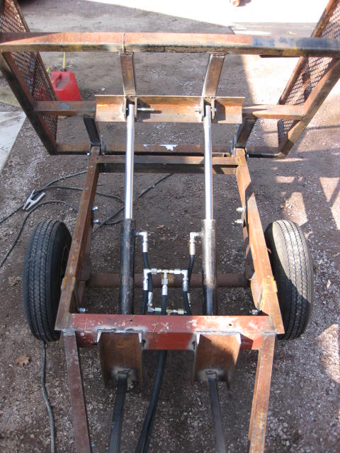

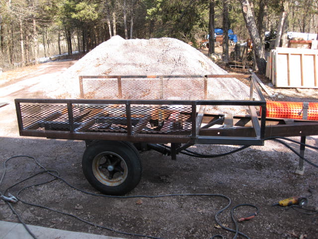

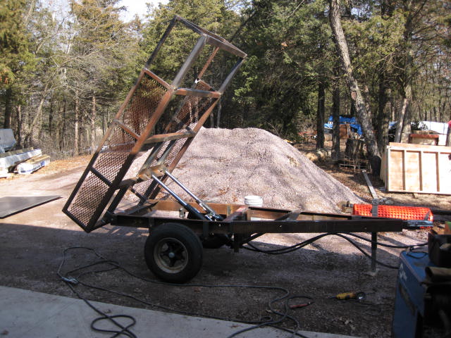

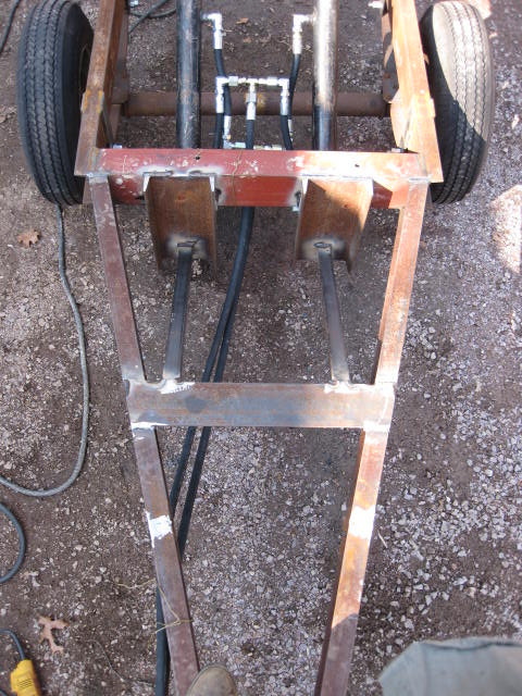

I made my 5'x8' out of 5" channel, it held up well hauling and dumping wood. Never built a trailer before, got a lot of good ideas from the site.
