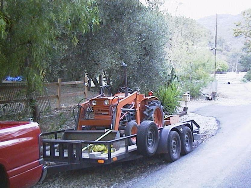

The attached pic shows 'Grumpy' on an 18 ft car hauler that I bought new for $900., it had GVW of 7000#, and w/modifications totaled out to $1150. (mod included a used single 3500# rated axle with elect. brakes. The two foot extra length is very nice when you want to load up and go with the FEL and boxblade (as shown) installed. Saves time and grumbles.
