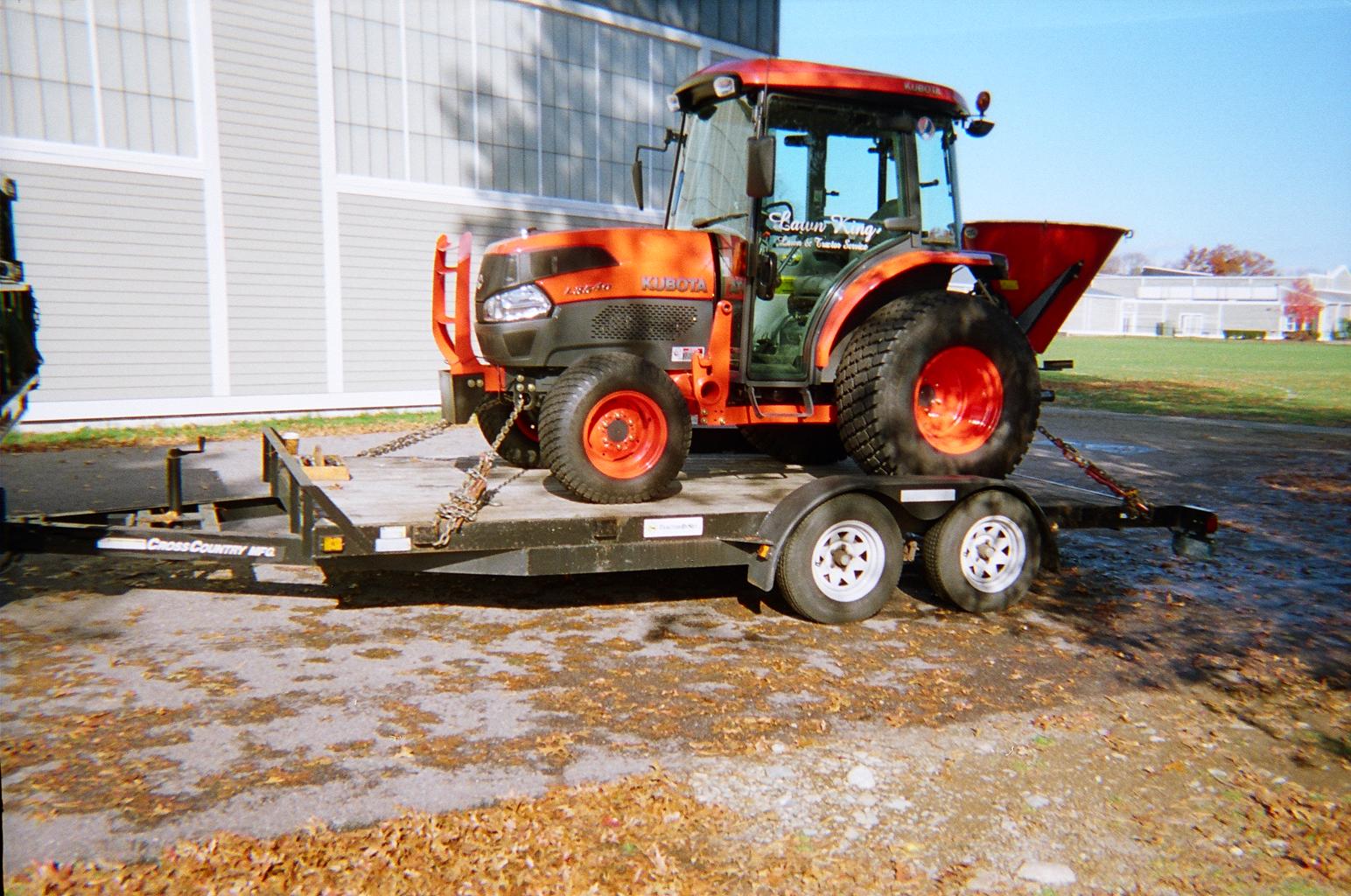

I towed mine today with my 16ft trailer pics below. I would recommend 18-20 feet depending on attachments and at least 10K capacity. I'm looking for a 20-22 12K to replace my current trailer.

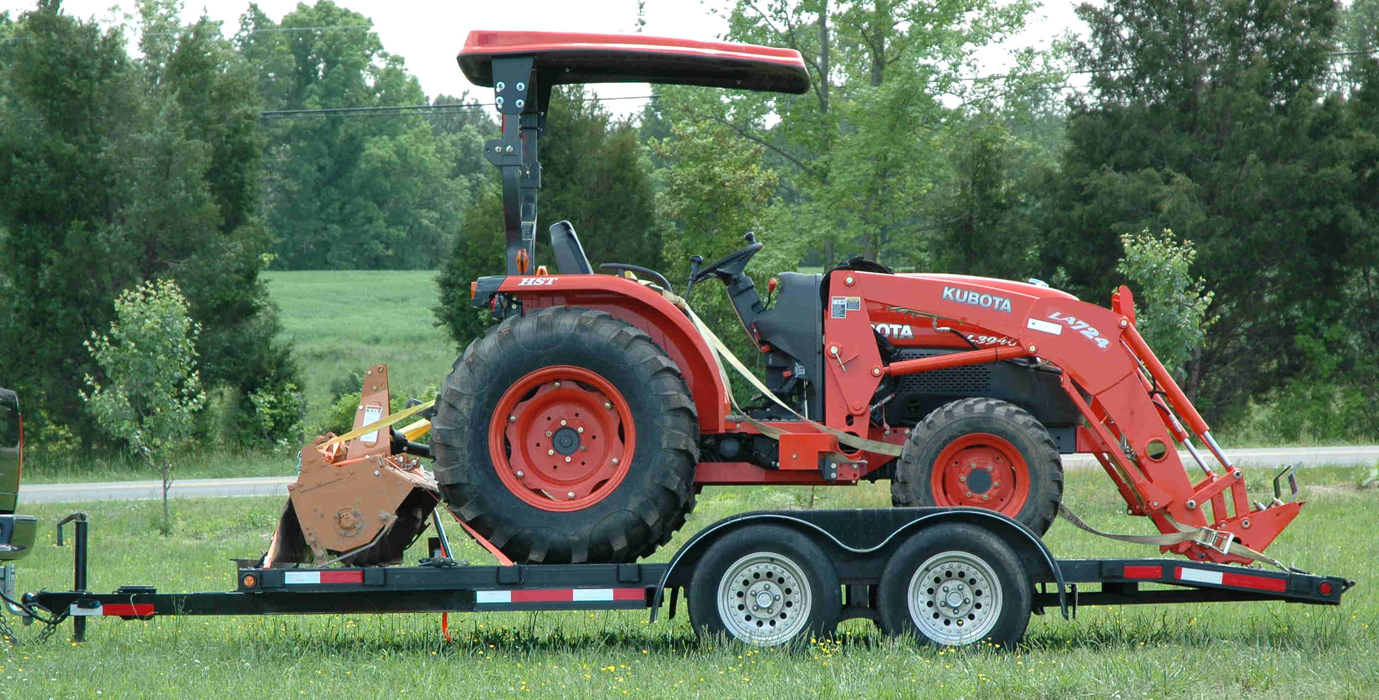

I like a beaver tail car carrier.
Medic, the trailer shown in your pic sure looks like a 7000# trailer....definitely pushing it with that 3940 on...
/ Trailer for a Grand L? #8
That's why I'm looking for a new trailer.
