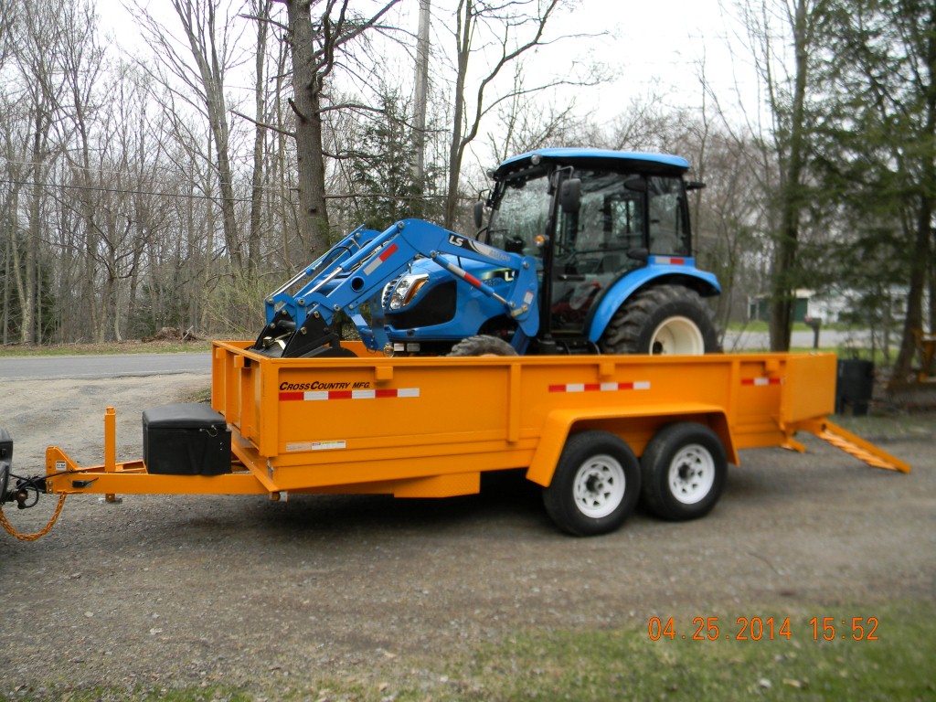

A dump trailer was mentioned a few times. I'd advise against getting a dump trailer.
The standard dump trailers are generally 10,12, & 14' long. Not really long enough to haul the tractor with attachments front and back.
Dump trailers are also not as wide as a car trailer.
Hauling a tractor in a dump trailer it is hard to tie down the tractor with the higher sides. You have to reach over the sides or get in the trailer to do it.
I have a 16' L x 80" W dump trailer (special ordered). Empty it weighs about 3800 lb. I hauled my tractor in it once and found it too hard to secure in place plus has a higher center of gravity.
I'll stick with my 22' tilt bed for hauling tractors or vehicles.

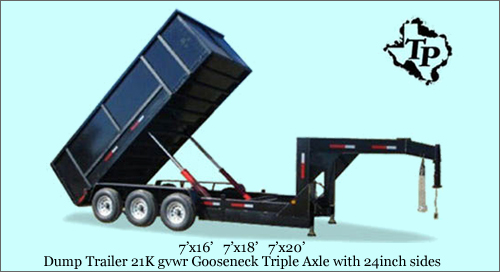

I ordered one of these a couple weeks ago. Looking forward to using it. Like was mentioned above I was looking for something longer than 16 and wanted to be able to handle my tractor which weights around 12k. 7x20 with 4 ft sides. I plan to use it to haul wood chips.
/ Trailer Features - What To Look For #20
I'd definitely go an 18', for a BX25. The angle makes it kind of hard to tell, but on mine, there is room, but more wouldn't hurt. It fits about perfectly, until you want to add something else.
Here's another picture, taken the same day. The angle is very similar, but you might get something from it.
