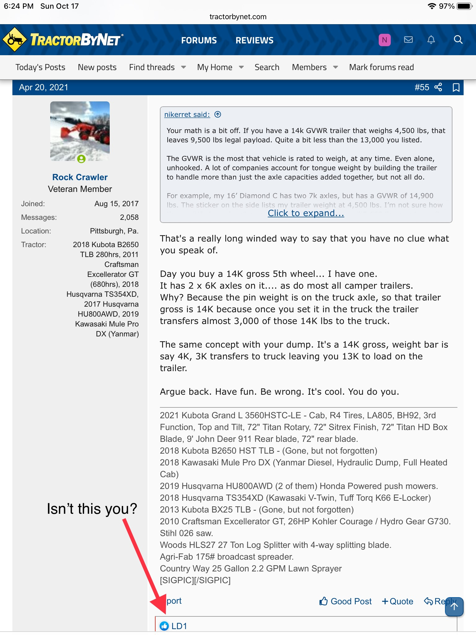

Im not wrong. And if you do care to go back and re-read the thread you linked while pounding your chest.....you will see NONE of my posts in that thread arguing with you or about GVW. You were arguing with someone else.
And for every link or source you can cite saying what you claim....I can cite an equally credible source saying what I claim is true. Case in point is rock crawlers post above.
Citing Rock Crawler isn’t a source. Please, cite an industry leader or official government document, contrary to what I’ve posted. I’m excited to see them.
If you get stopped and scaled they are gonna make sure you ain't over axle ratings. This hitch load is not on trailer axles...rather the trucks.
There are a lot of things that can be checked. What and how is going to be determined by the investigating LEO. This is more different, from LEO to LEO than from one jurisdiction to another. Everyone seems to find what they like to look for/enforce.
If you have a 14k trailer....you can put 14k on the axles.....period. not my fault that some manufactures choose the incorrect CYA method of GVWR minus empty weight for payload
Incorrect or correct is irrelevant, in that regard. If they use a “CYA” method, that will be yours to answer, if it comes up. It is unlikely to be an issue unless there is a wreck and it’s a suspected contributing factor. This is a big problem with all of the ”de-rated” trailers. I’m talking manufacturer de-rated, not printing off your own VIN plate or just registering it as such (which isn’t de-rating, at all). Technically, that is their new limit and would be enforceable as such.

Wow, you pointed out the fact that I "liked" a post. Far cry from you acting like I argued with you in the other thread and wouldn't learn....
You aren't worth the time to spend googling and linking. You can do that, and if you have I am sure you have also found contradicting information.
I really wish manufactures didn't assign a gvwr on trailers at all. List let us know what the axles are.
You insist that some LEOs make you unhook and some don't. So it seems even law enforcement cannot agree on best method....or better yet....it ain't about what is safe or what isn't....it's about an easy money grab.
If every axle and every weight is within capacity.....yet an Leo makes you unhook and now trailer is over so you are busted......ponder this: if your truck is over gvwr....will the LEO let you unhook the trailer to shed the tongue weight and all of the sudden call it good?
Seems what you are saying is that amongst LEOs....they have no standardization other that whatever suits them best at the time. Either the hitch load is part of the trailer GVW or it is part of the truck GVW...but it CANNOT be both.

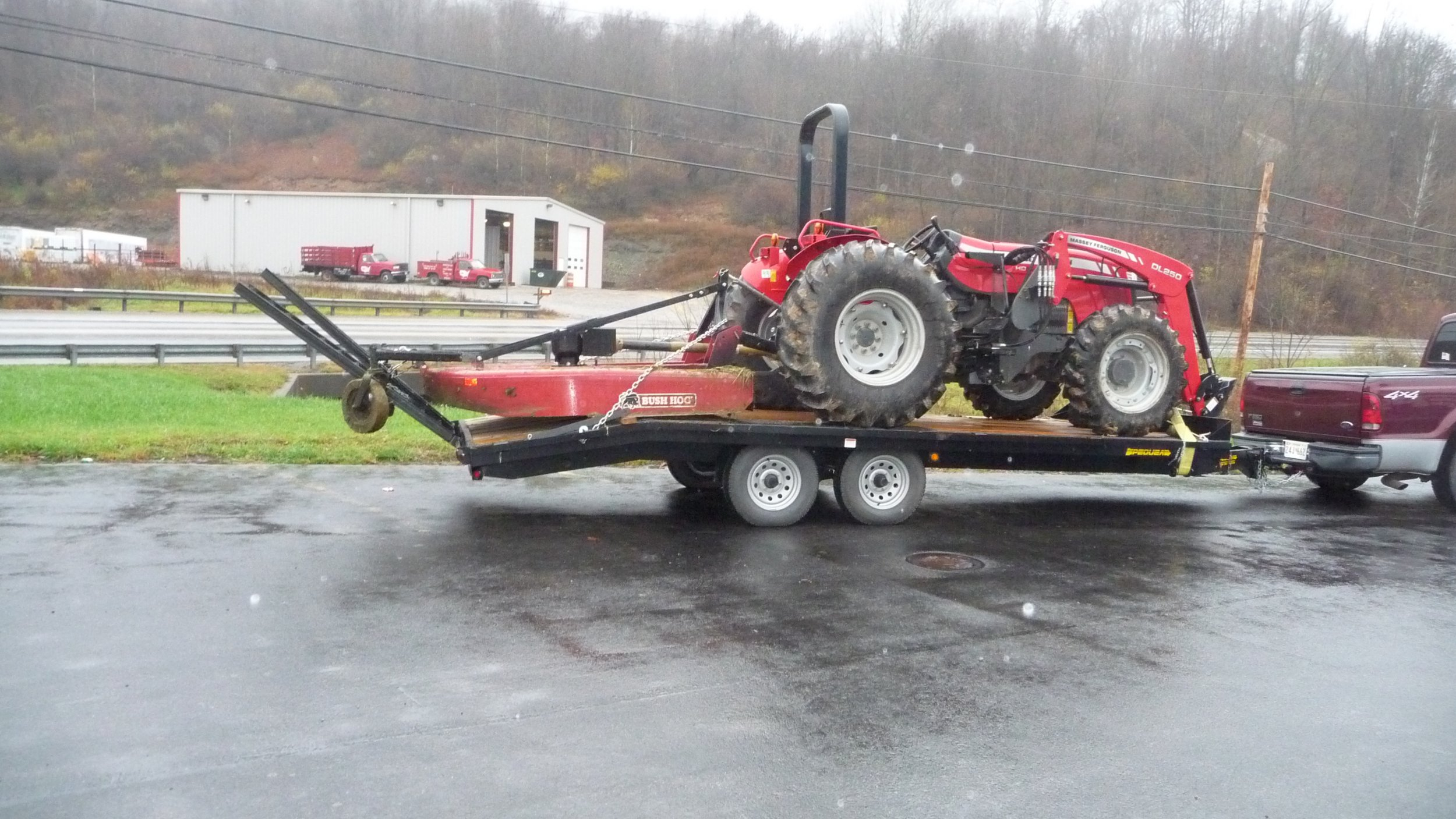

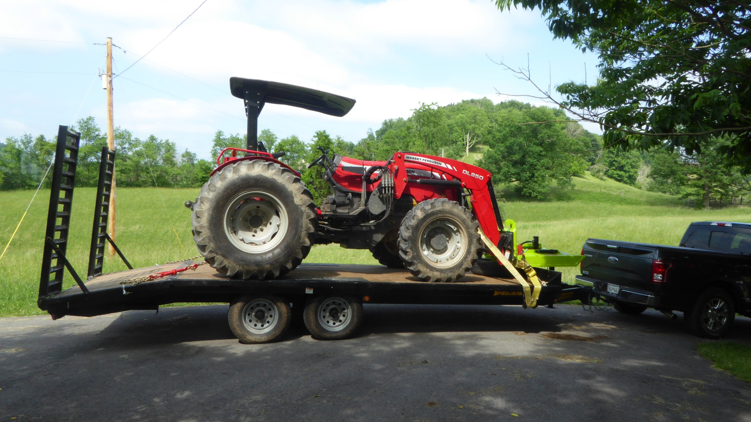

My MF2660 is roughly 1000lb heavier than your NH workmaster 70. I have loaded tires. I would guess the loaders are very much the same weight or close enough. My bucket is a very heavy 4-in-1 which weighs 1000lbs. I use a 7 ft Bush Hog brand hog which weighs 1460 lbs. I towed this 80 some miles each way in some serious mountains in WV (missing only the bucket) using my 2000 F-250 V-10 and Pequea 1018 trailer. The trailer weighs a hair under 3000lbs. No problems whatsoever. I have also towed the MF2660 and loader & bucket (without the hog) 330 miles on interstates including some long steep pulls but using a heavier trailer (approx. 1000lb heavier than the Pequea.) No problems. Your 6.5L V8 has enough torque and HP (not much different than my V-10.) The truth is the 3.5L turbocharged V6 has a few more HP than my V-10 had and equal torque figures... which is strange but true.
I have also towed the MF2660 minus the bucket and minus the hog (for 25 miles each way just to get to/from a Laneshark dealer,) on the same Pequea 1018 trailer returning with the 600lb or so Laneshark on the FEL using an F-150 3.5L Ecoboost. I do NOT recommend towing this sort of load with the F-150 other than short distances at slow speeds -- mainly due to weight of the truck being 1500 lbs lighter than my old F-250 V-10. The weight of the towing vehicle matters a LOT in terms of stability, steering and stopping. A 4WD truck will have heavier springs in back and tolerate more tongue weight better than a 2WD.
To heck with the towing capacity ratings of these various trucks. Your F-250 is plenty strong to do your towing with everything your describe. Both my old 2000 F-250 stick and my 2015 F-150 automatic towed the loads mentioned easily/well power-wise. Power is NOT the issue. Weight of the truck is an issue (you have good and plenty.) The heavier the truck the more stable towing.
I don't think the tractor necessarily has to go on first. Best is to cut and try and see what fits best for you. I do not think you can beat the Pequea trailers for quality and strength at a reasonable price. Mine is a 1018 deck-over. Pequea sells a longer 20ft deck-over which I recommend highly. There are many good brands of course.
There is nothing wrong with you using a "bumper pull" (really receiver hitch pull) trailer but there is no question that a 5th wheel design trailer is FAR better in avoiding fishtailing and sway as well as distributing the load better amongst your truck's 4 wheels. If you plan to do a LOT of towing with this entire load (and can give up normal bed space in the truck) then go to the 5th wheel trailer and don't worry over the weight. Otherwise, just use a good solid deckover with about a 20ft deck on it.
