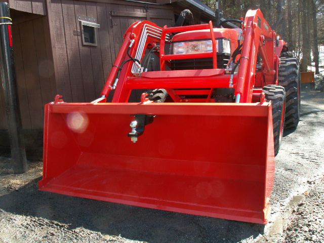

This idea might work for you?

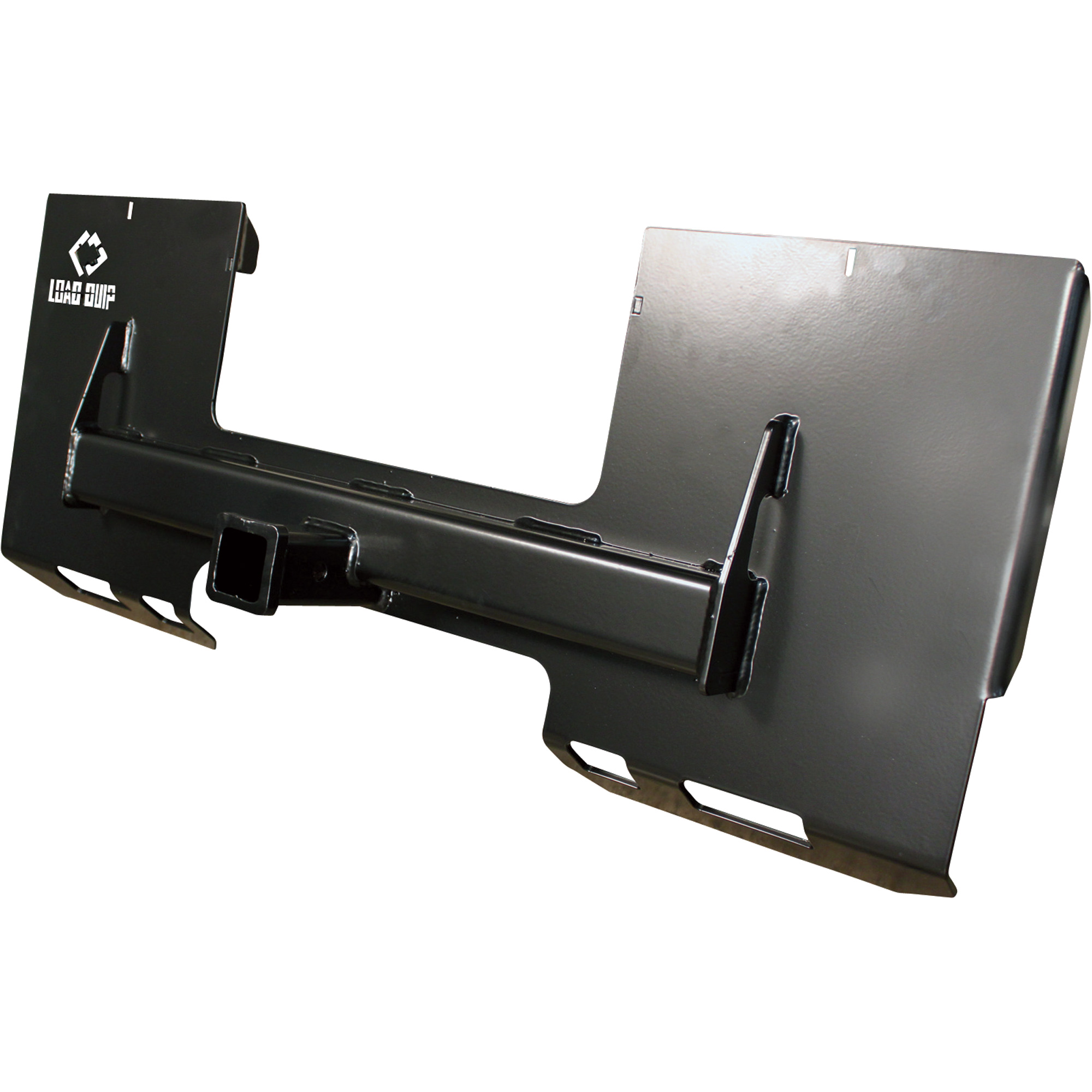

/ Trailer ball #17
I have a clamp on receiver hitch for my FEL and it works well for light trailers. When I try and use it to move my dump trailer though it shifts side to side no matter how hard the clamp is tightened on the bucket.
If you have FEL with SSQA, I recommend this adapter plate:
Skidsteer 3 Point Attachment Adapter Skid Steer Trailer Hitch Front Loader Case | eBay
It also lets you mount 3 pt attachments to the FEL as well.
There is another model available with a cut out that makes it easier to see the trailer tongue.
It lacks the 3 pt capability though.
Both these adapter plates bring the ball closer to the FEL pivot point which increases the lifting capacity for handling heavy trailers.
