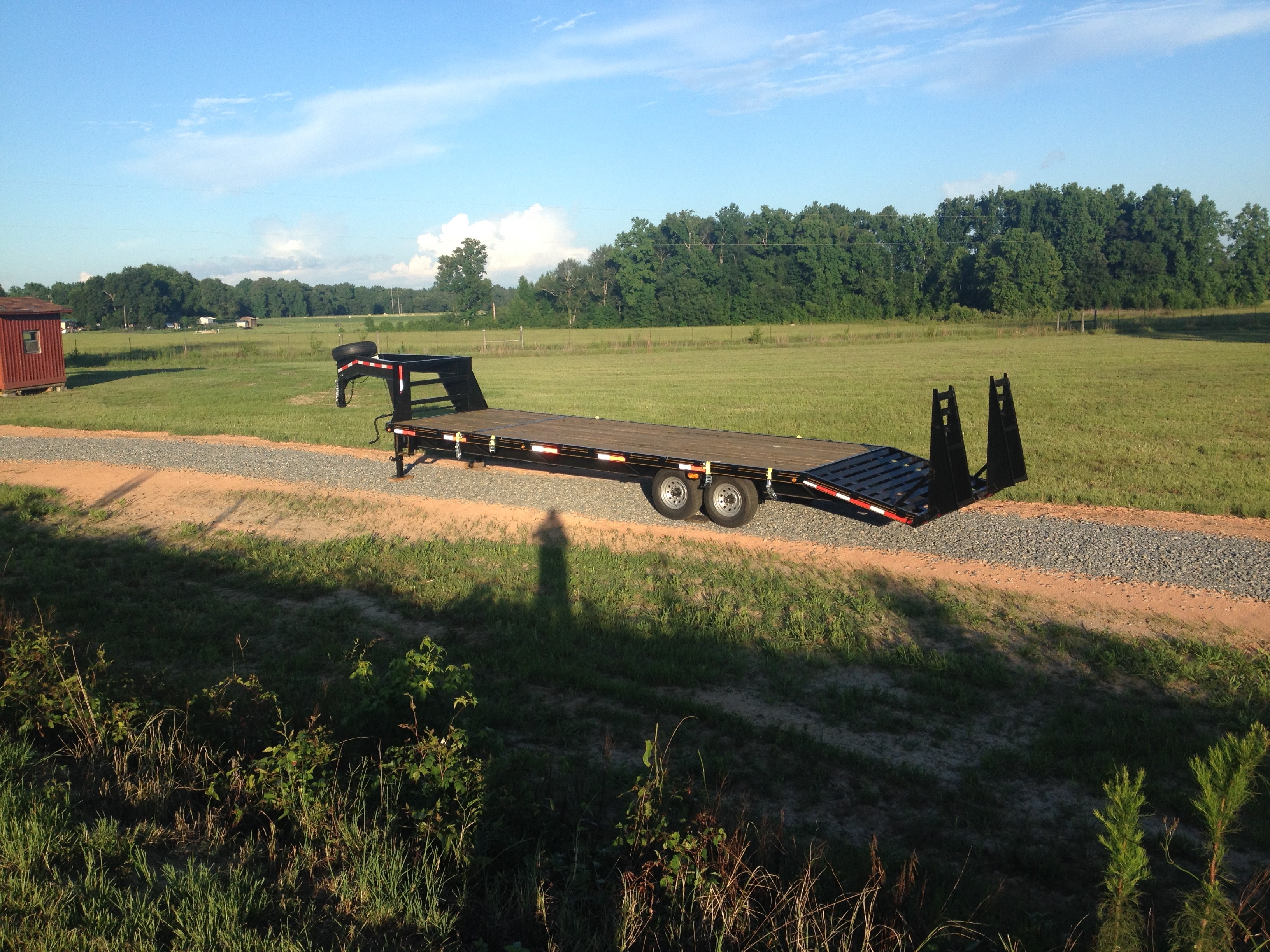

Here is the trailer I mentioned in my previous post. It has dual 7000lb axles. With it only being single wheels and not duals, it matches the capacities of a 3/4 ton or 1 ton single rear wheel truck. If it had tandem dually axles, I'd probably get a 1 ton dually to maximize use out of the trailer.

Thanks for the info. Looks like you have a nice setup. The tow vehicle will mainly be used as a farm truck and to haul stuff as needed. I have a regular car for normal driving. If I can find something that matches used, I might go that route, otherwise may do new if I have too many requirements that can't be met by something used in the area.
Not mine but my dad's solution, I just wanted you to know how the process went since I helped him narrow down a trailer! I wish brand new trucks and trailers were one of those things you could test drive with your specific equipment loaded to see if it works for you.
