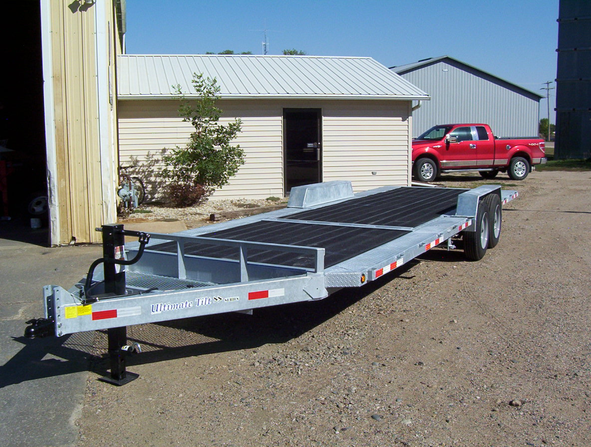

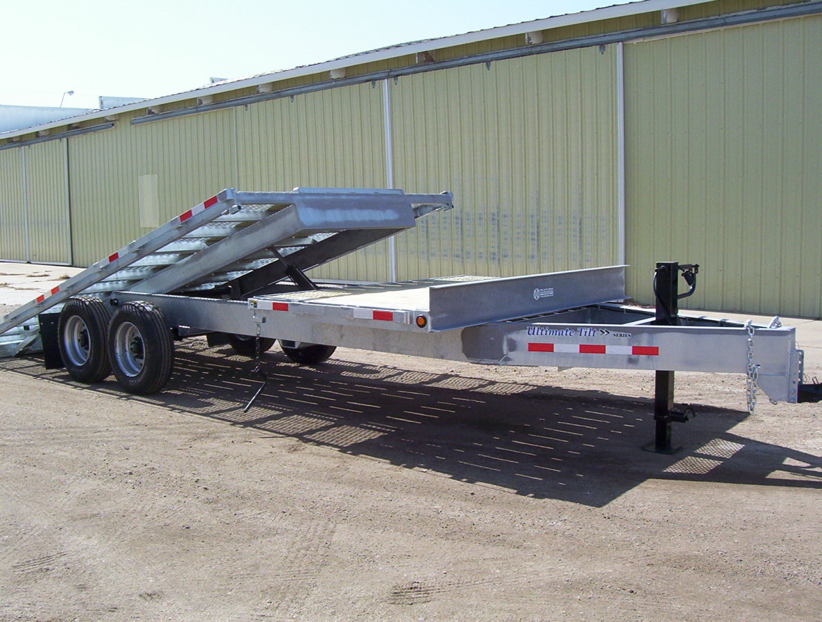

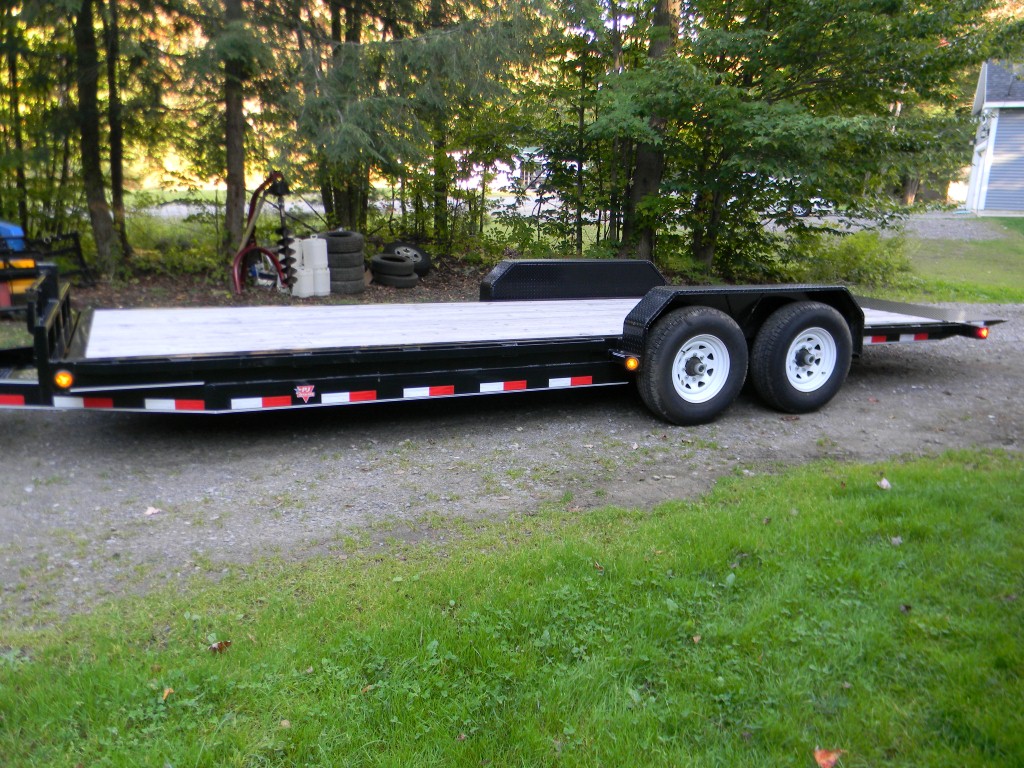

Just an FYI, As Chris and others have mentioned that axle placement on a tilt bed is important.
My 22' PJ tilt bed is hinged toward the back. Axle placement is in line with a non tilt trailer.
On my previous H&H tilt bed the axles were further forward but with a 20' deck I had plenty of room to balance the load. Attached are my PJ and H&H. I'd guess the PJ is a 60/40 placement maybe more. The H&H was maybe 55/45. H&H is the one with 5 lug wheels. I have not had any problem balancing a load on either trailer.

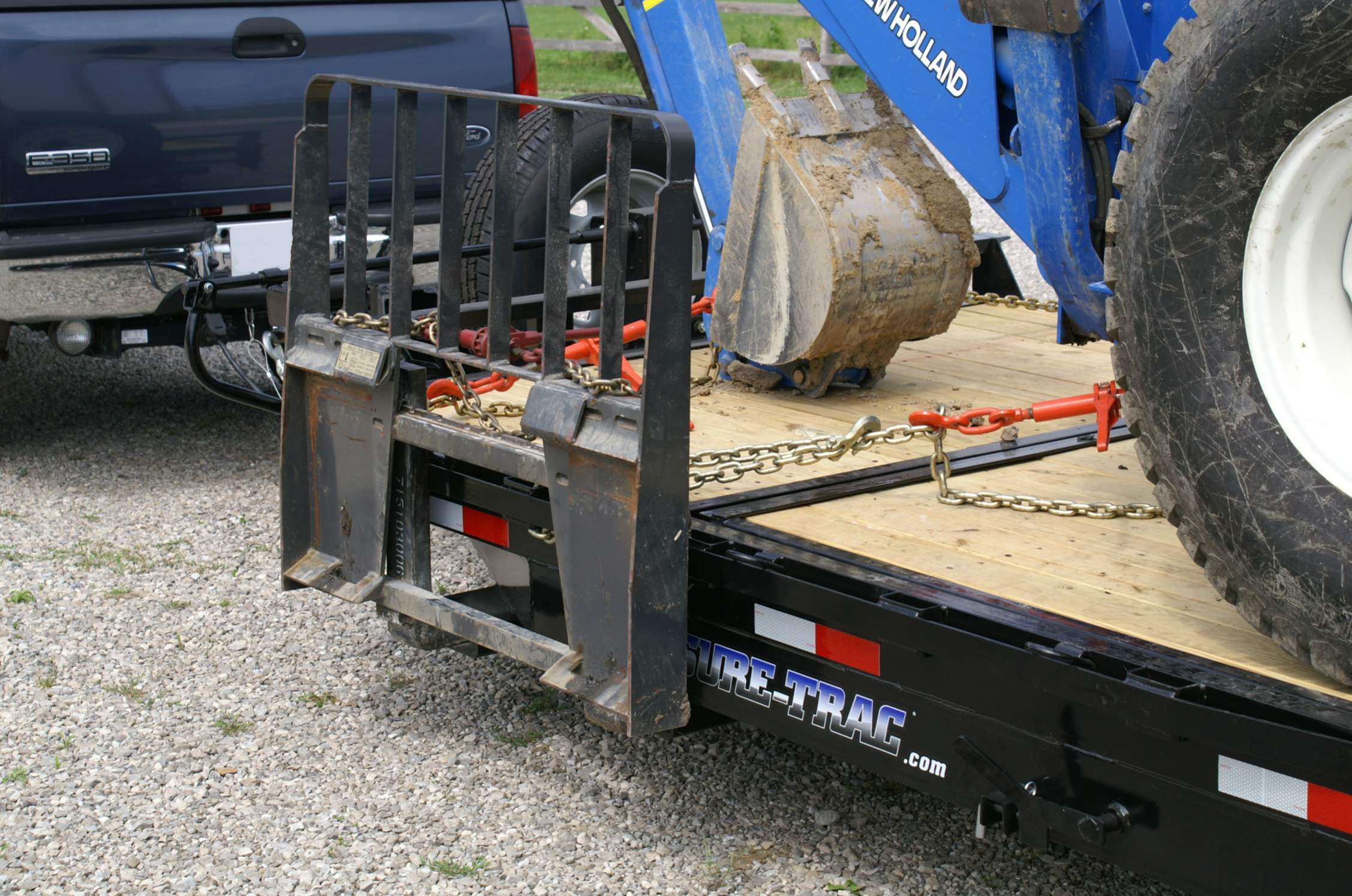

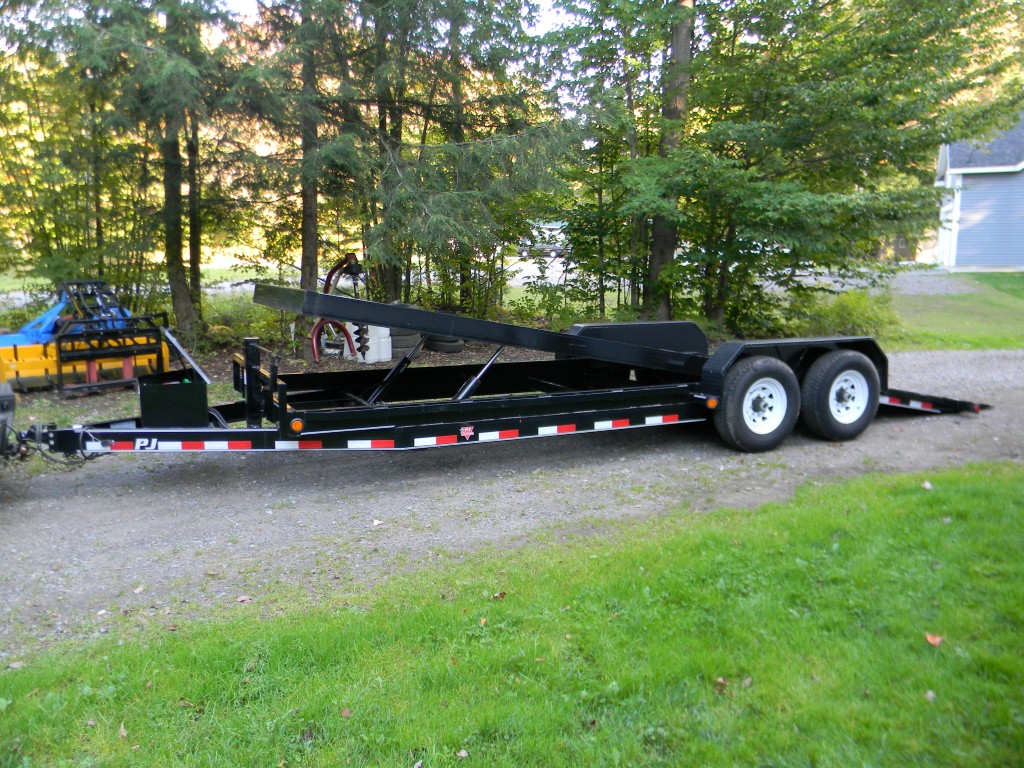

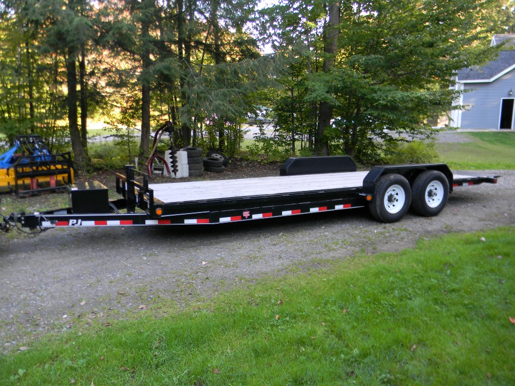

Not much to look out for as it's a new trailer. I'd say it's the gravity tilt model T6. I have the powered full tilt 14K 22' (TF) model and like it a lot.
Go on PJ's site and use the 360* view mode and magnify the pic. I count 5 pockets in front of the axles and maybe 3 behind.

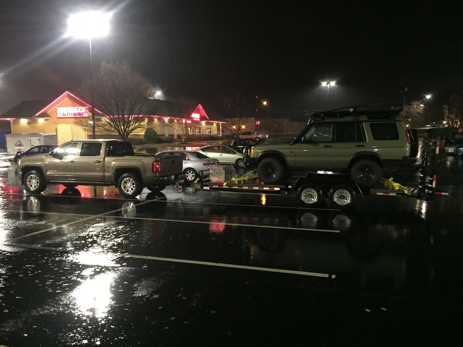

I recently bought and towed a 2000 Land Rovery Discovery II home from Atlanta for my wife. The unmodified curb weight on the Land Rover is supposed to be around 4,500lbs. I would hazard with all the aftermarket equipment the previous owner added (ARB lockers, skid plates, roof rack, air tank, front/rear steel bumpers and running boards) that it is reasonable to say that the DISCO was easily north of 5K.
My truck was able to tow the trailer and vehicle. However ~8K was getting into the range where I would not want to tow that much on a regular basis with my truck. I did purposely by a trailer that was over engineered and therefore heavier because I was tired of the cheap junk available in my area. Long story short, just be aware that you may run into some weight limitations more quickly than you might realize with a heavier trailer, especially if you are not upgrading your tow vehicle anytime soon.
