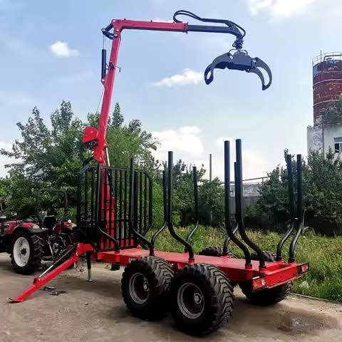

The owner of it got it used, a few years ago and never used it, now is selling the house and moving. If you wanted to take your side-by-side into the woods and grab a load of wood, seems like this setup would be ideal.
For the sake of trails, this would be nice to move downed trees out without bringing your tractor out to the work site. We are looking at used tractors so that lowers its value to us.

You might look into what they cost a few years ago and make an offer on that basis because he might not have as much invested as he is asking?

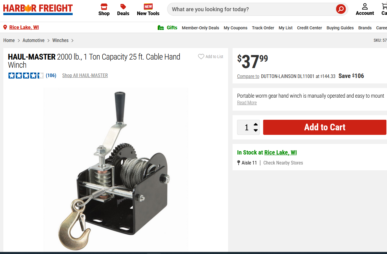

I have one of these. I took the handle off, and hooked it up to my cordless drill. It works amazingly well. I have winched tractor attachments onto my trailer with it.

I'm not familiar with that brand. I use my own Metavic trailer pretty extensively. If the focus is on getting the logs out of the woods, they work wonders, but you need to be doing a fair amount of it (and/or find a used one at a good price) in order to justify the cost. If your use is just to move logs out of the way to clear trails, this type of trailer probably does not make a lot of sense. For that, I'd be looking at a grapple on a tractor
There are less expensive models on eBay. See this Link: ATV/Small Tractor Logging Trailer. You can also save eBAy fees by buying from the seller directly: Jason Zuleger at jasonzuleger@gmail.com. He imports them, and can have them delivered to a number of ports/warehouses throughout the US. NOTE: I've never seen one in person, so I'm not sure what the construction quality is like. I do know they come with "some assembly required".
