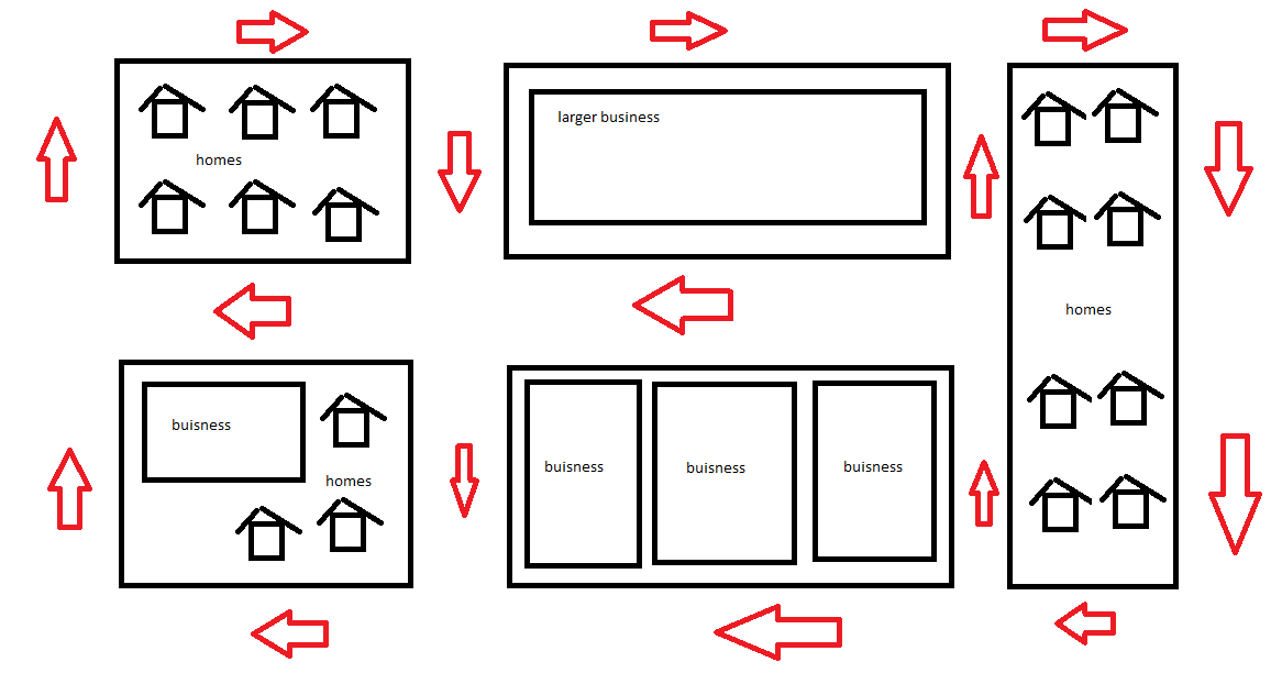

KISS (keep it simply stupid) *raises fist in anger* *arghs*
i understand as cities get larger and more traffic occurs, you need more lanes, etc....
prefer if they would just make ever other road a one way streets, and turn "individual blocks" like a huge round about.
