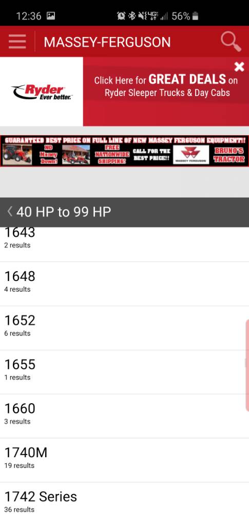

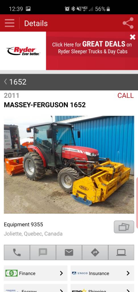

I just checked TractorHouse again and you are right, very thin pickings. I'm not sure when the last time I checked was but it wasn't too terribly long ago. They were more available then than there are now to be sure...
This one looks pretty interesting, (the one with no price). It doesn't have a loader so definitely wouldn't be the right one for you. Looks like a rear snow blower and I'm not sure what that thing on the front is, possibly a fancy Snow pusher?

That's on the other side of the country and I've noted they seem to have lots of Masseys and just about everyone is equipped with snow moving equipment. On this side of the country I'm pretty much stuck with new, waiting for something to show up or making a very long treck.
