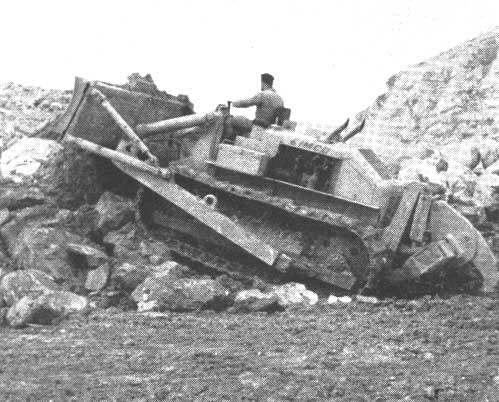

Dozers are gonna stay front engined for awhile. Eimco tried the "operator in front" setup and it wasn't popular. Little downpressure on the blade with the engine mounted behind and poor visibility when backing. Dozers spend nearly as much time backing as pushing.

Milkman a few companies made front seated dozers, Eimco is the main company. They had a rear engine front seat line. Also a German company made one to. the thing with the front operator is clearing and quarry work mainly something rolling onto the cab or a branch going through it. The hightrack Caterpillars do feel like your riding on the front of the machine with the improved visibilty. Ive run few scrapers with the seat on a 45 for fine grading to. I usually sit sideways on a roller or compactor because of the repetetive backing and trying to stay out of the same tracks each time. Ill post a picture of a 103 Eimco dozer if its the coorect size.
