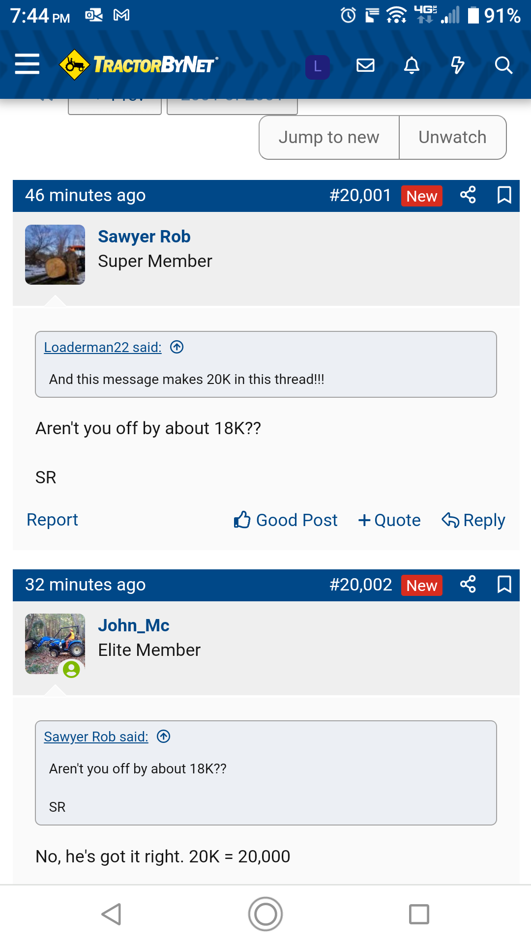

Aren't you off by about 18K??
SR
Top right has comment count, the pages might be off if you look at 15 or whatever per page instead of 10

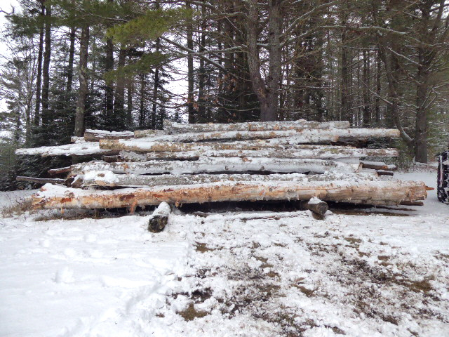

I finished blocking up my wood this morning. Turned this pile from last Christmas

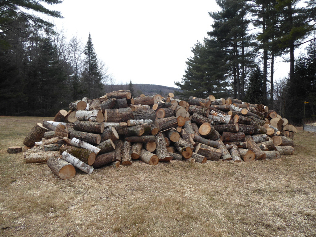

Into this one
Time to get the splitter out and It'll have two full summers to dry. For me this is a good time to do my wood. March and April are transition months. Winter is over but real spring doesn't start until May when road work and gardening can start.

That's a pile of 'em Mr. Gordon...looks like some 24's slipped past Quality Control.
You must be a beast to be able to manhandle those!

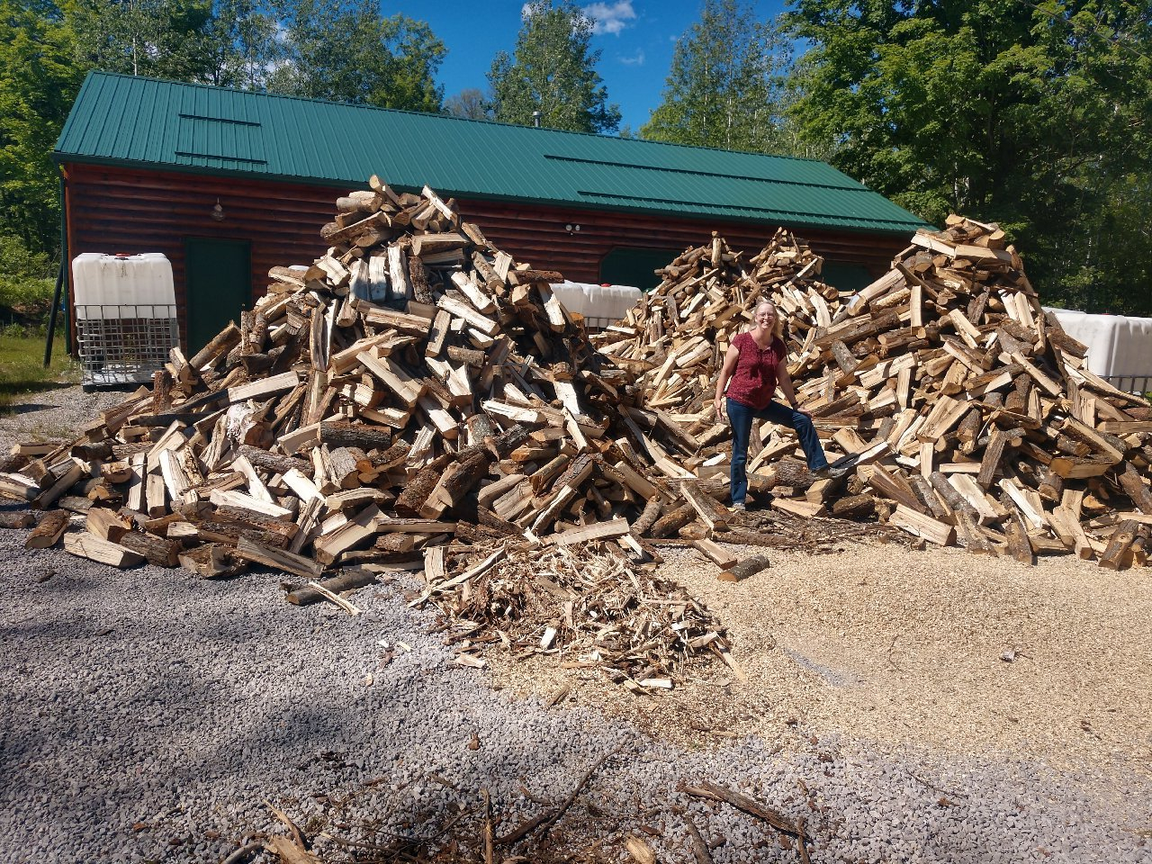

Gordon this is what we did in 15 hours:
That worked out to about 12-13 cords. It was our first time using a processor and so we went through a bit of a learning curve. I expect the next time, we will be at a cord per hour.
Output is dependent on the diameter of logs and the capacity of the processor, Some processors have a faster cycle time. The ideal log size for us is 8-12", and that gives one pass through the 4 way wedge. Smaller diameter logs yield less wood per cycle and larger diameter logs need to be split a second time.
The next time we will pre-sort the logs. Logs under 6 " will not be split, just cut and stacked. Logs over 12" will be set aside and processed with the 6 way wedge.

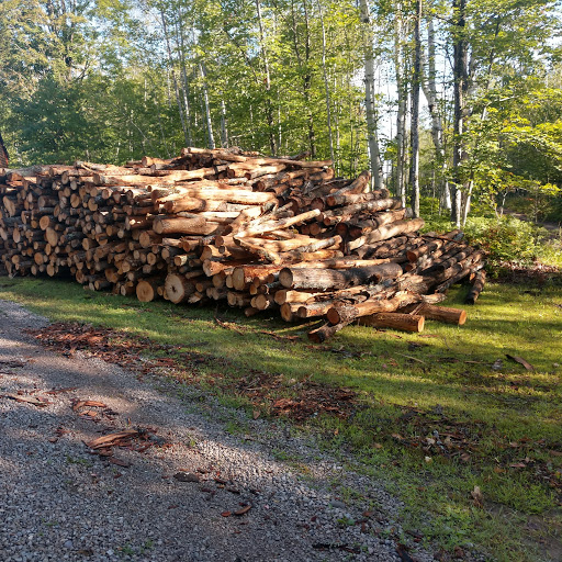

I have 20 cords of logs to sort through. See below. That should take about two days but not a lot of effort as I have a cabbed tractor and a grapple. Getting old forces me to work smarter and not harder.

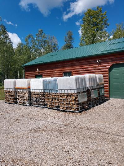

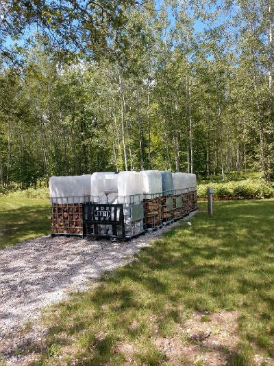

This is how we store our firewood...just under 1/2 cord per tote.

Thanks for the detailed explanation along with the great pictures. Gives a pretty clear idea of the processor capability. Very impressive. Actually your whole system of working up and storing fire wood is very impressive. Very efficient !! So far I have not been able to find a local outfit that rents processors - seems like a good way to go.
