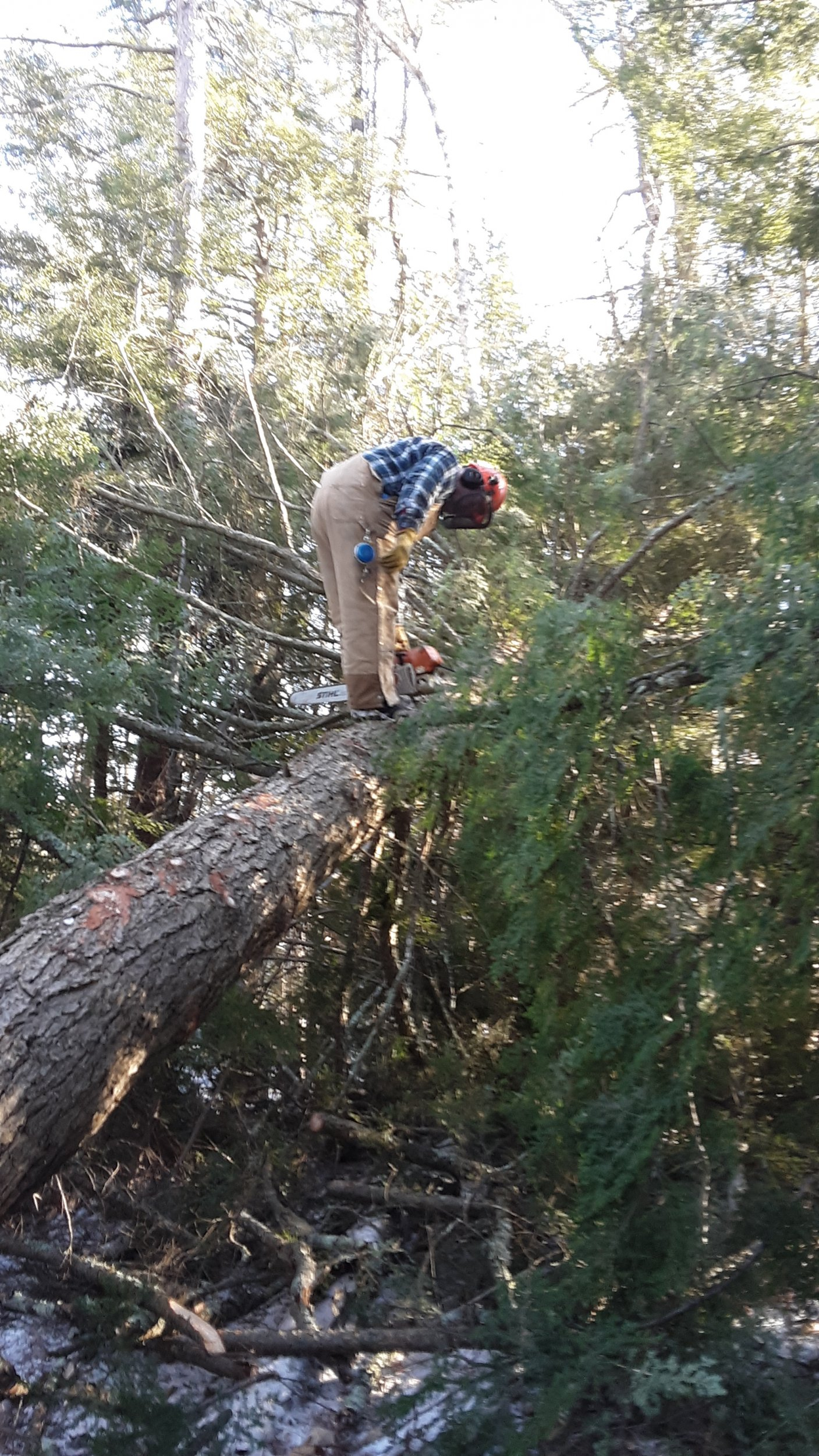

These are from December, I forgot about this long running thread.

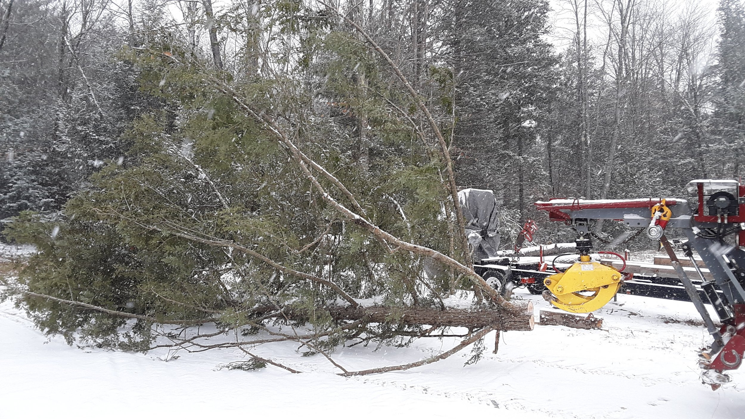

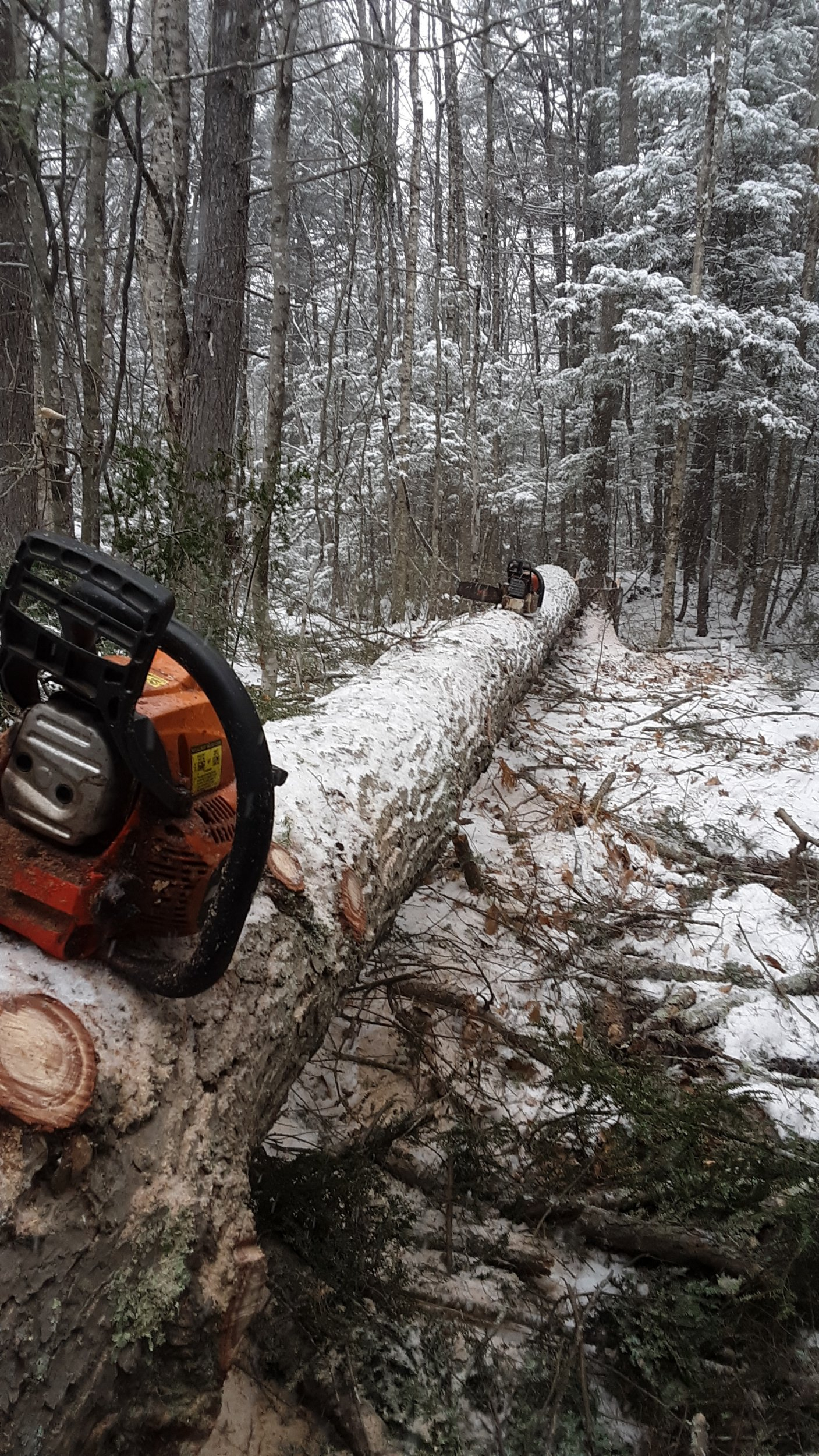

the top ^^ to this log below

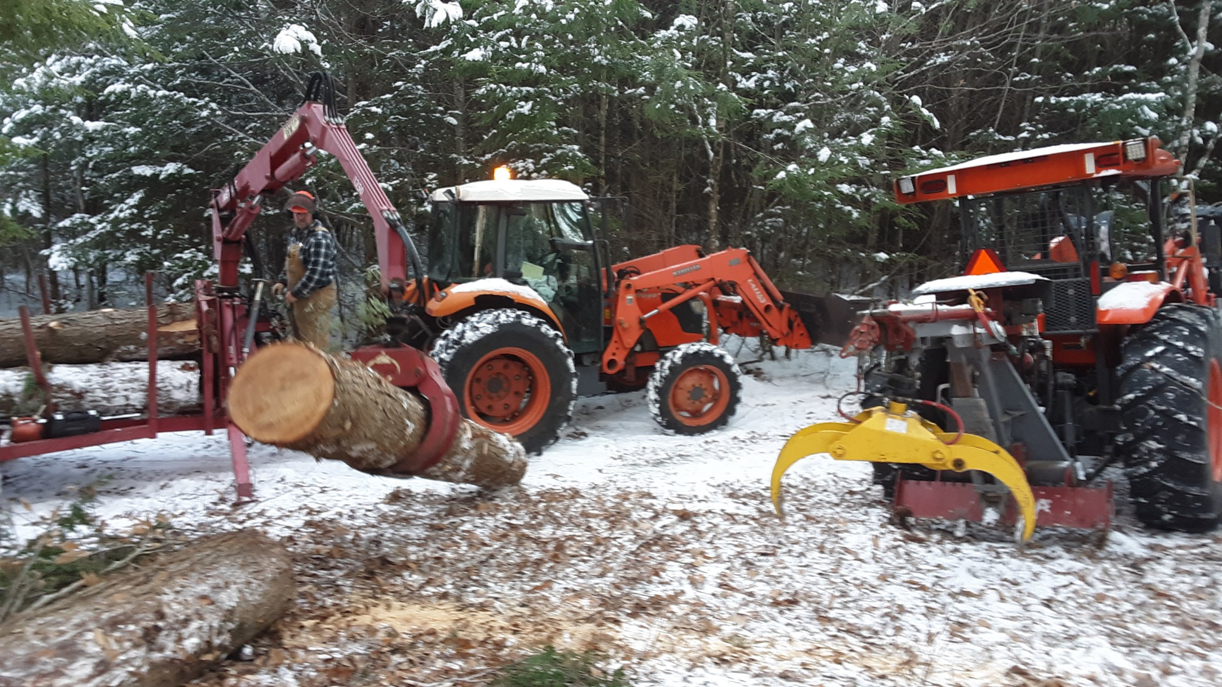

A buddy's rig on the left. I got them out to the trail with my tractor on the right.

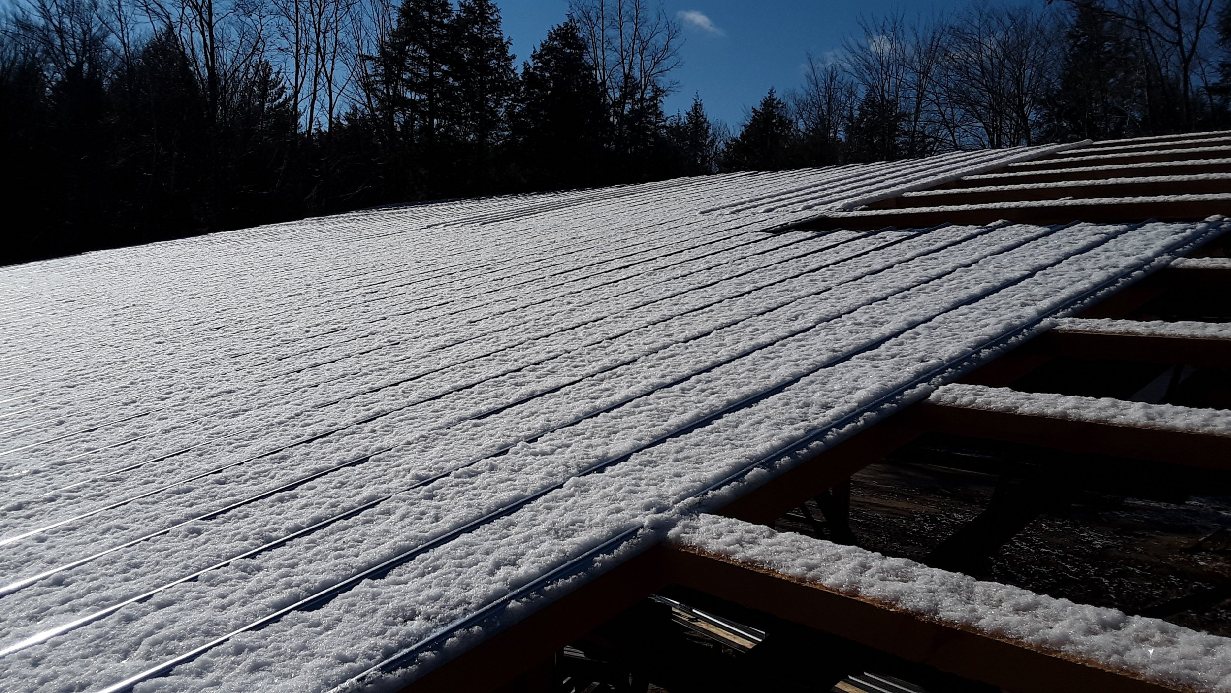

This was 12/9/21 and the first snow that stuck. I was gathering hemlock logs for siding for my sawmill building. My plans were to pick away at it this winter moving the mill into the building, it's under roof. That just didn't happen.

Some great pictures Eric. You have some good Hemlock. Takes a real woodsman to limb out the top like that. I assume all the framing for your saw mill building came out of your woods and off your mill ??? Very nice work.

Gordon that was my buddy up on the tree😆. I was the lazy guy taking the picture.

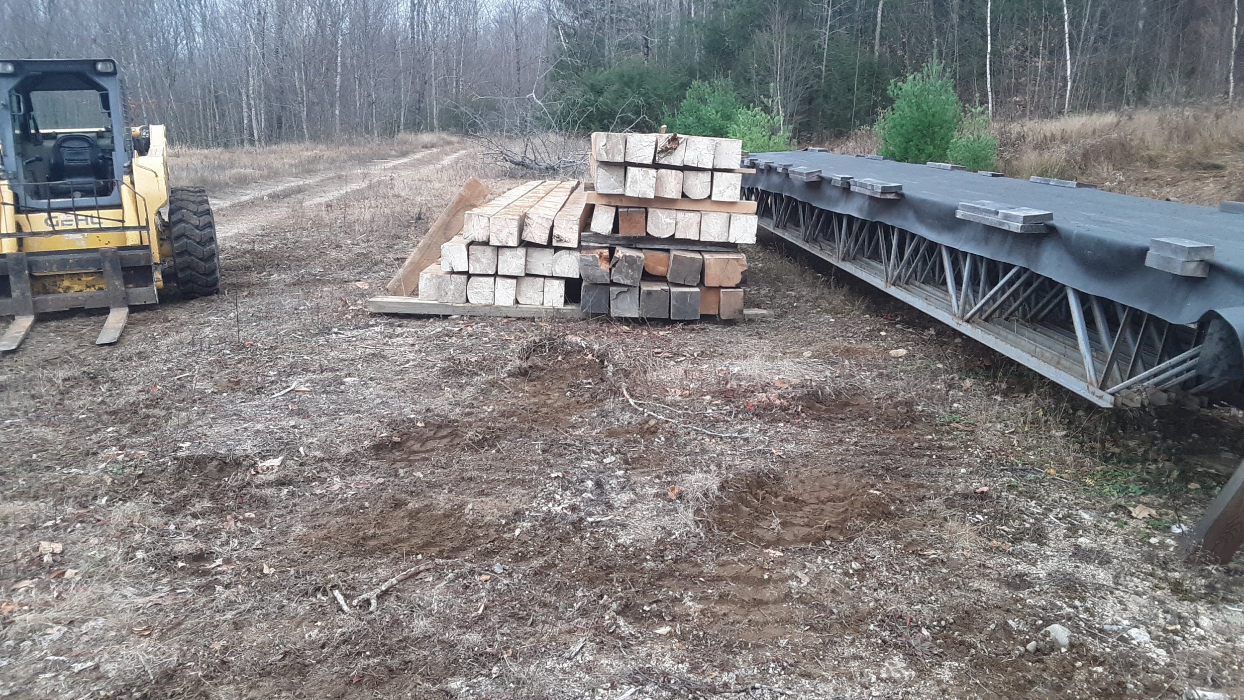

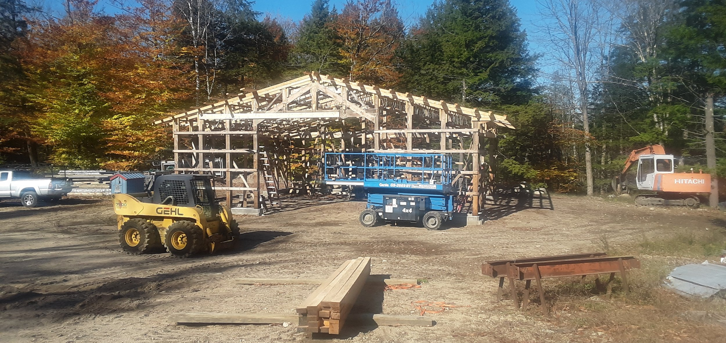

As for the lumber, a friend gave me about 35 8x8 x mostly 24' long spruce timbers. They were for a dream of his father's, sitting stickered on concrete in a building for 10 years or so and they needed the space we horse traded a days labor and he delivered them to my place. I did need to resaw the twist out of them. I bought the 2x4's for the purlins and wall girts to save time.
I'm building this by myself and was hoping to finish it before snow... at least I got it under roof.
Here's the free posts and the metal bar joists that I bought about 8-10 years ago. 38' long, 11 pieces for $400!

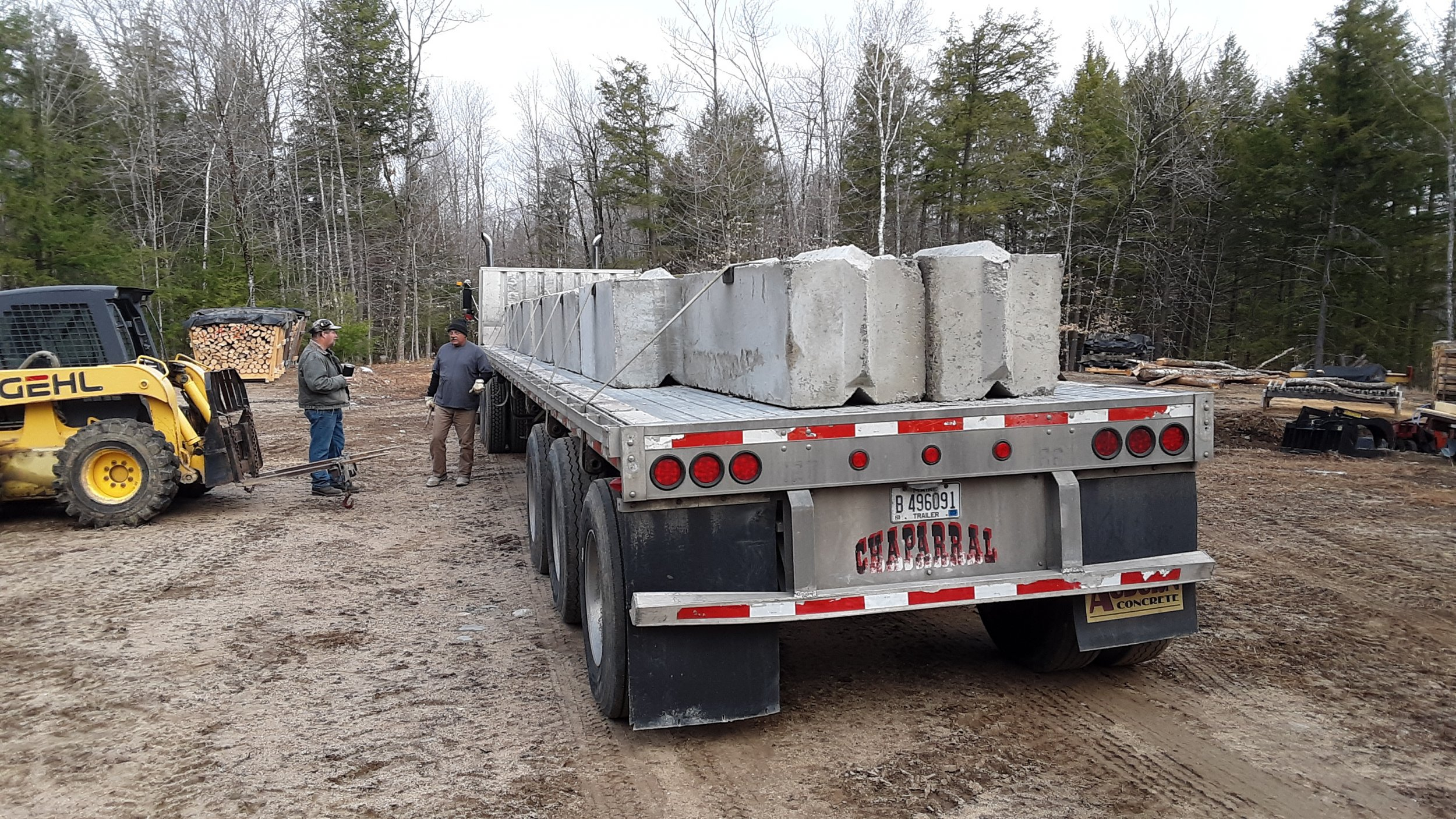

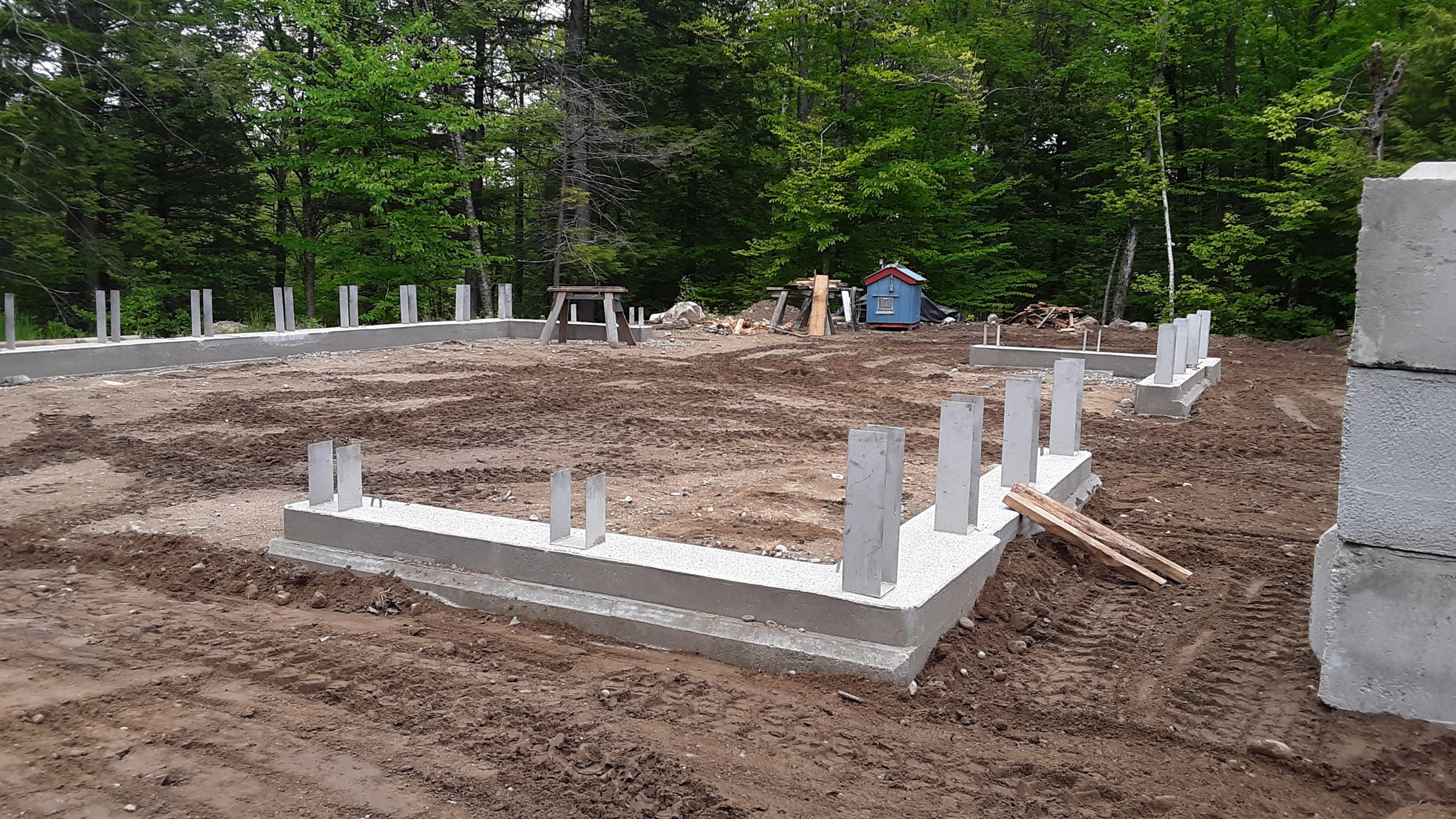

These blocks are my inexpensive "footings".
20 2x2x6 concrete blocks, delivered for $1240 iirc. They were kinda on sale during the time when the roads were posted because they had a yard full and come spring they'd be making more and also needed the space. Fortunately I'm on a state road and it can't be "posted".
For those that don't know what I'm saying... over the winter the roads freeze up (because they were never built properly years ago) and when the frost is coming "out" in the early spring heavy trucks over a certain weight are restricted because the sub surface is almost mud like and the asphalt will crumble under the load.
April 7 was the delivery date.

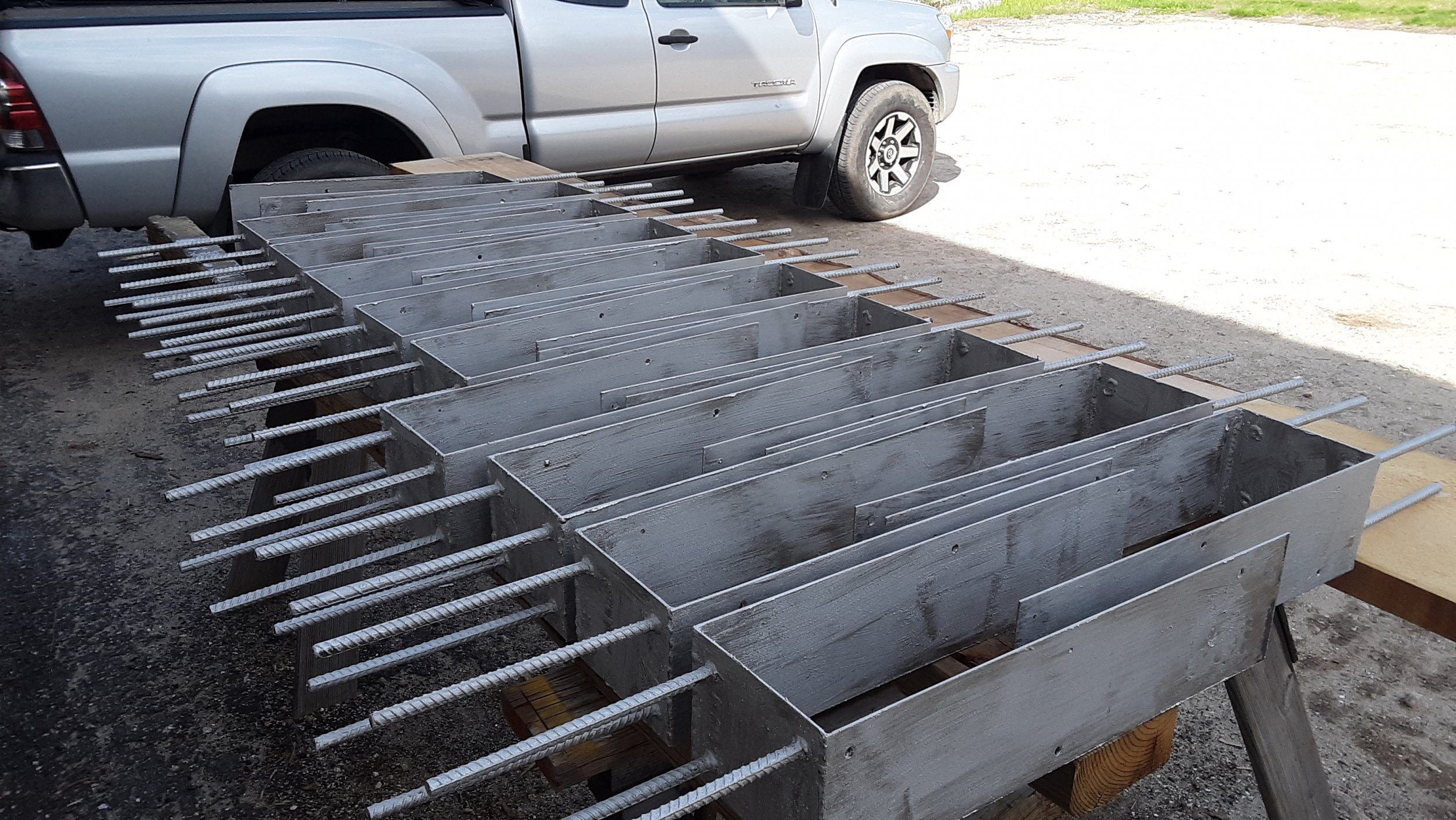

The blocks were put on a 12"-16" layer of crushed stone, then I formed up an additional 12" concrete that is above grade. I made those brackets that got "wet dipped" into the concrete.

Your mill will be very happy in that building. That's a pretty slick way of doing an out-building foundation (y) Smart use of available material too. Very nice !
