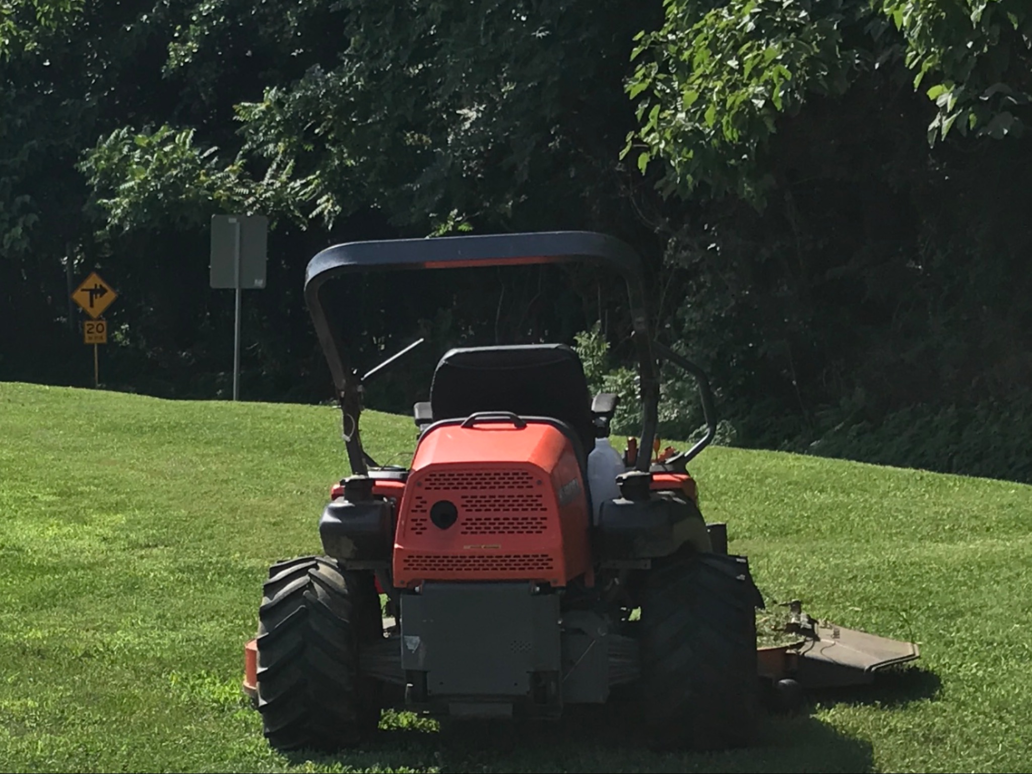

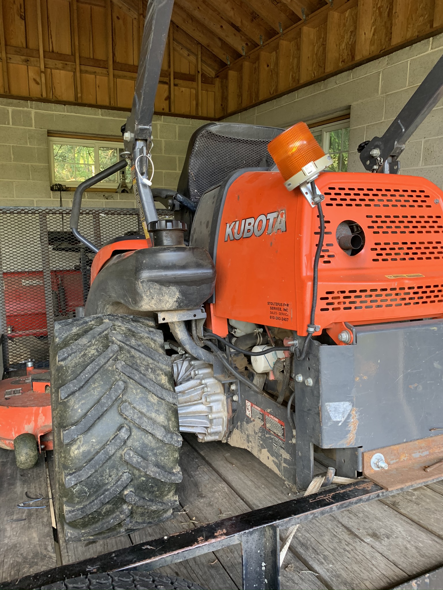

I have some wicked slopes that I try to mow with my Z turn. Certain areas I avoid when wet... other areas I avoid all together. I have one short but steep grade that I have to go up to get to a patch above a retaining wall. I have to lean as far forward as I can to keep the front wheels on the ground. Not for the faint of heart or sphincter.
I have been looking for a good hunk of steel to stumble on, that I could attach to the front edge. I am convince that 50lbs forward and low would be a huge improvement on my little Z.
/ Tractor vs zero turn #100
You could foam the front tires. I think mine added 30 pounds each after I did that.
