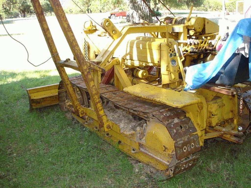

I have a tractor and a crawler. The JD 420C at 20-something horsepower will out push and pull my 50+ horsepower tractor. I use the "dozer" to maintain the dirt path I call a driveway. :ashamed: It's over a quarter mile long and sloped. After a hard or long rain, there's many areas that need attention. I've also used the dozer to pull my tractor out of a mud hole in the back. I also use the dozer to consolidate cactus patches where I wouldn't dare take my tractor(s). I built the backstop for my range too. Once you have it, you find all sorts of work for it. Mine has a crane I've used many times to unload trailers and move downed trees. It picked up a 3500lb OBI punch press off a trailer. I also used the crane to move my Bridgeport mill into the shop. I only paid $1500 for it and haven't done anything except do a valve job and put a new carb on it. Oh, and put gas in it. It's a 1956 model. It's paid for itself many times over.
She ain't pretty but she sure is a hard worker.
