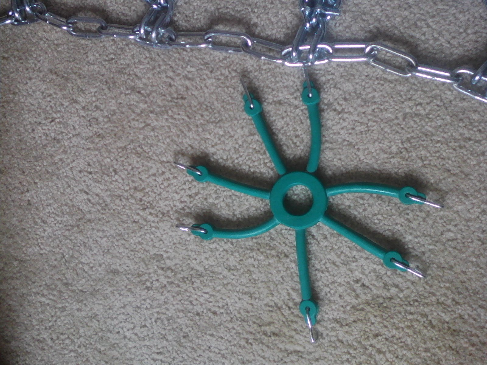

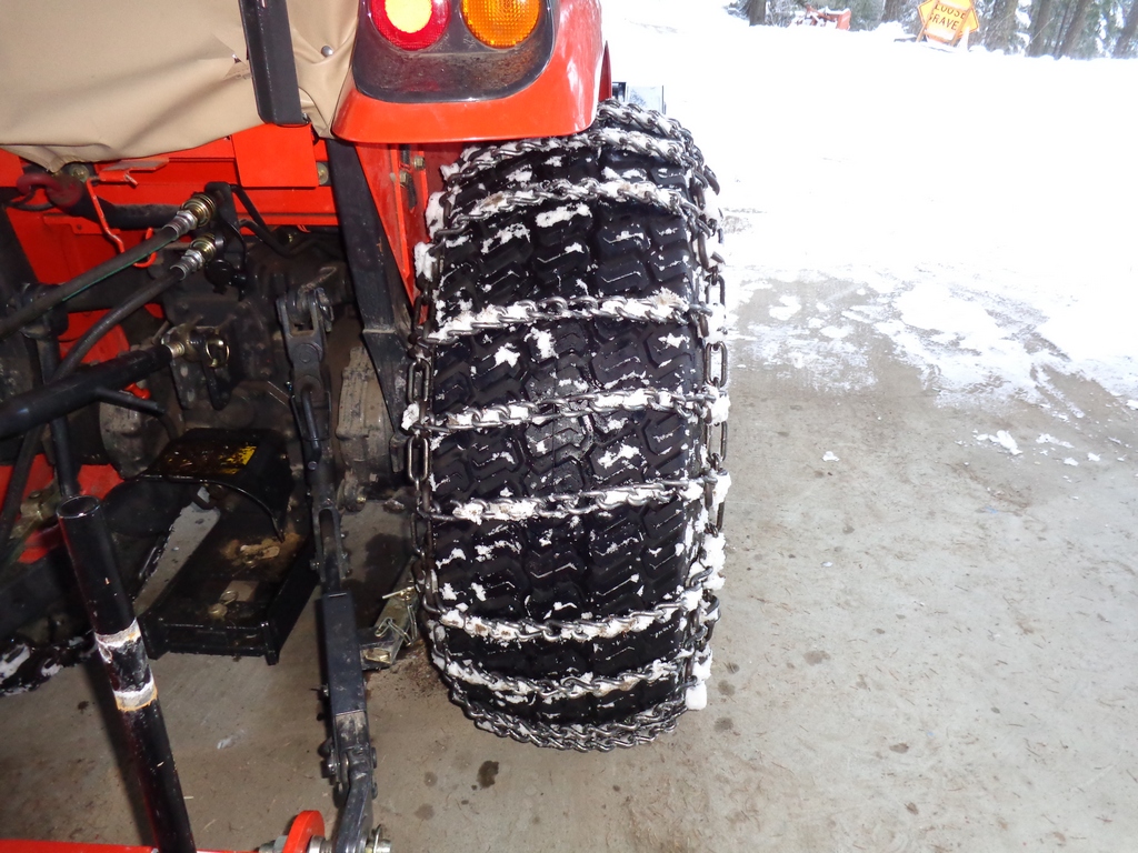

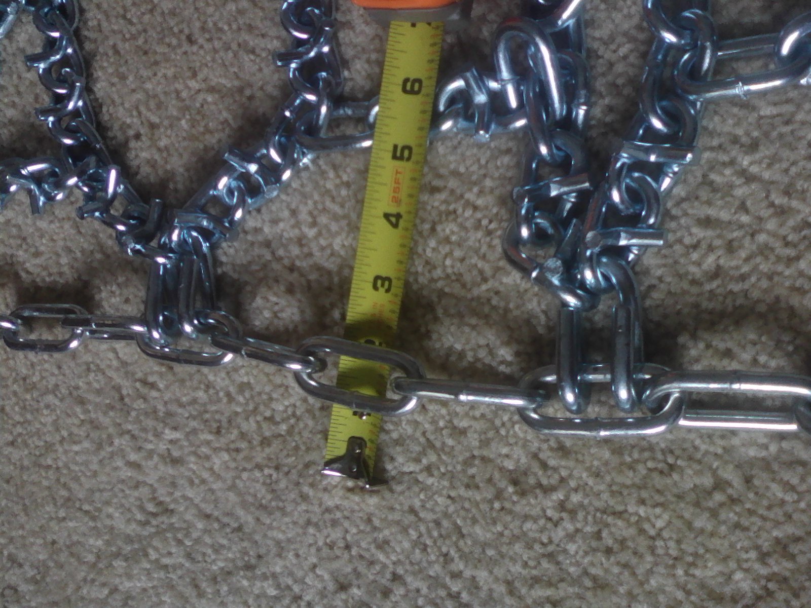

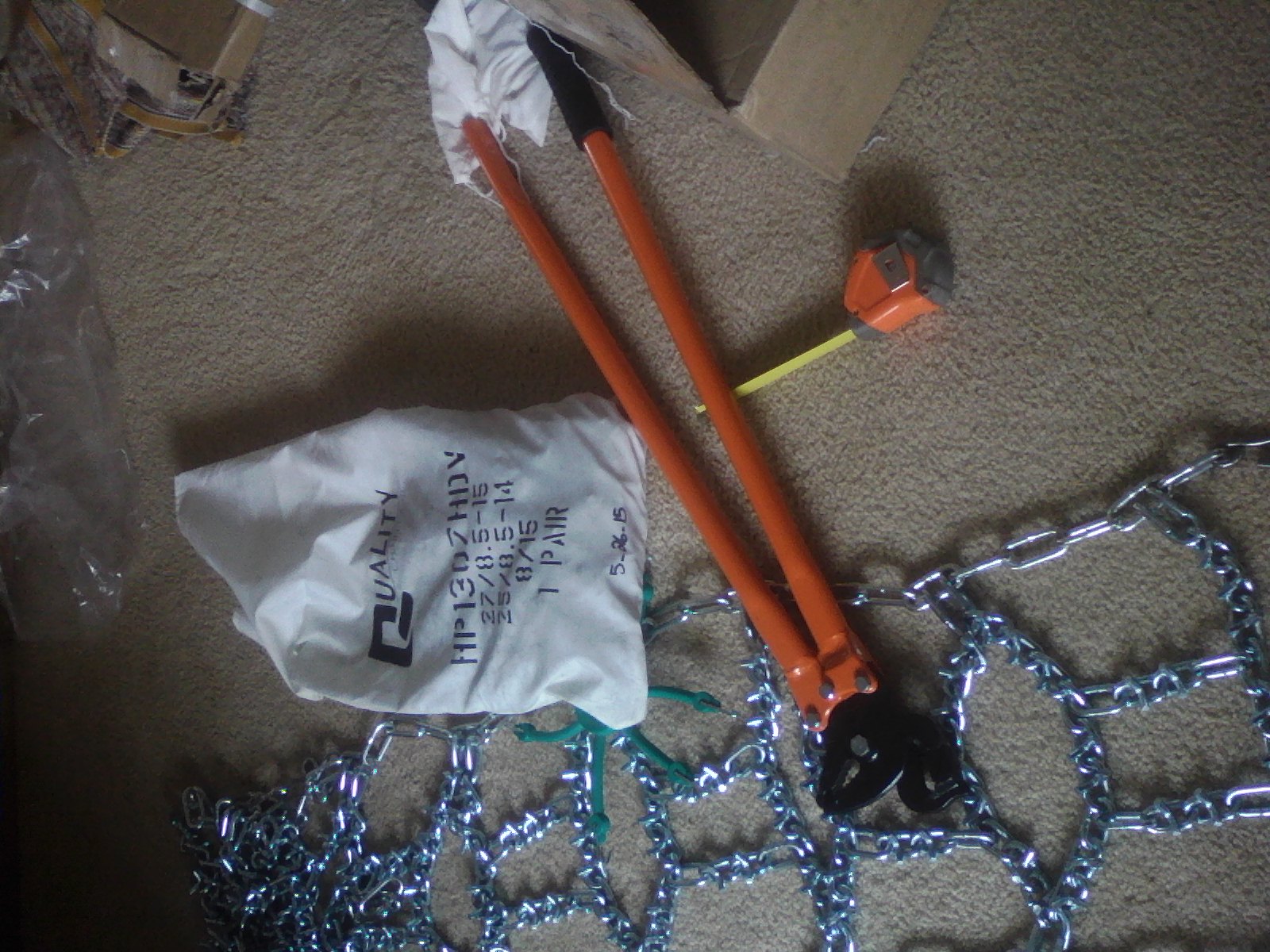

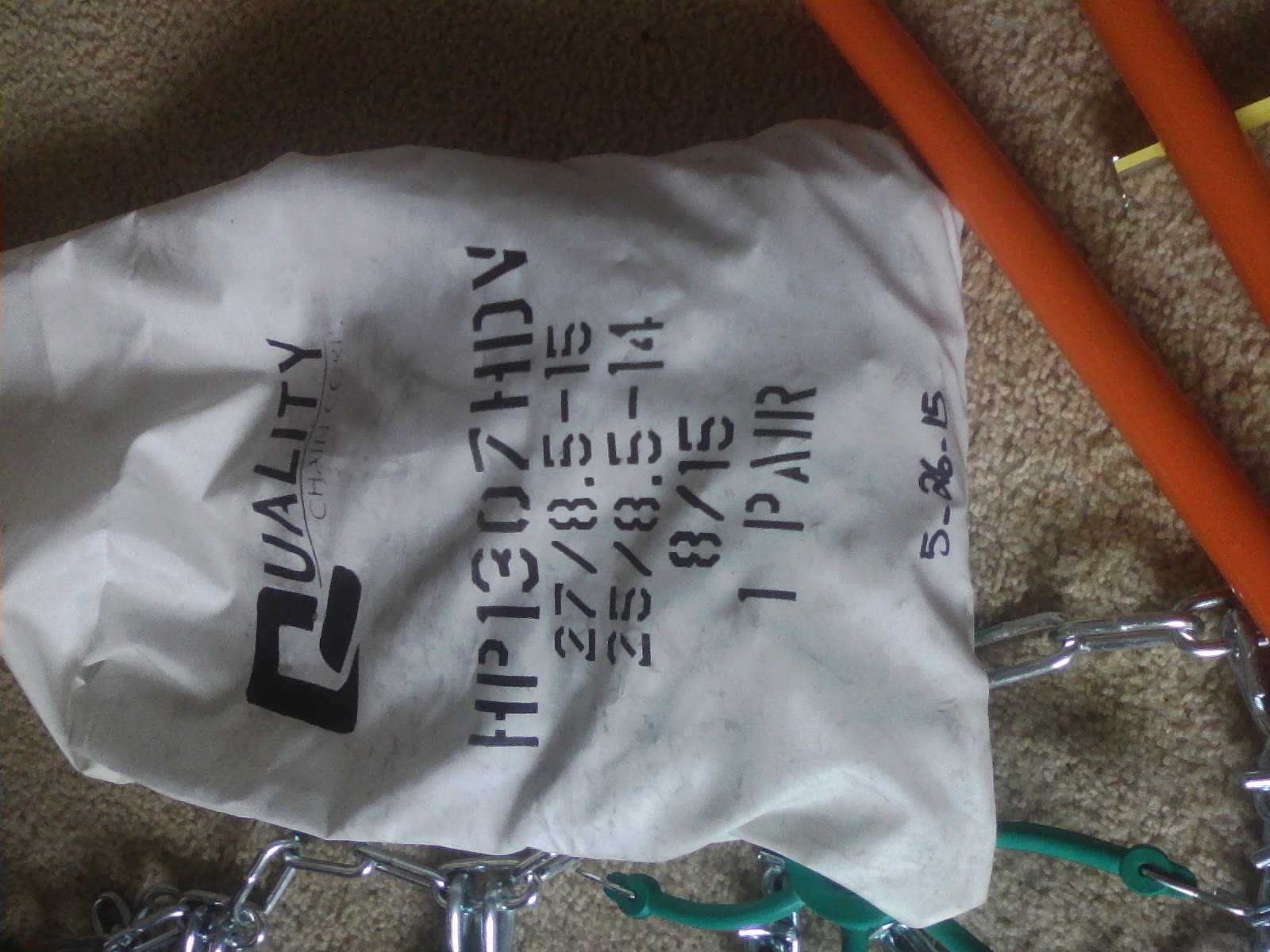

I thought I would start a new thread on my install. I have a Bobcat CT 235 with filler 15x19.5 rear and 25x8.5x14 front. Both are R$ tires. I ordered an H-bar set from Quality Chain after a long search and from past experience. I wanted something stronger than the typical garden tractor tire chain category that the front tire size usually showes up in.
First pictures are of what I bought.
First picture shows the weight of the chain the rest are of the order including the tensioner and chain repair tool I got.
Next post will be the install

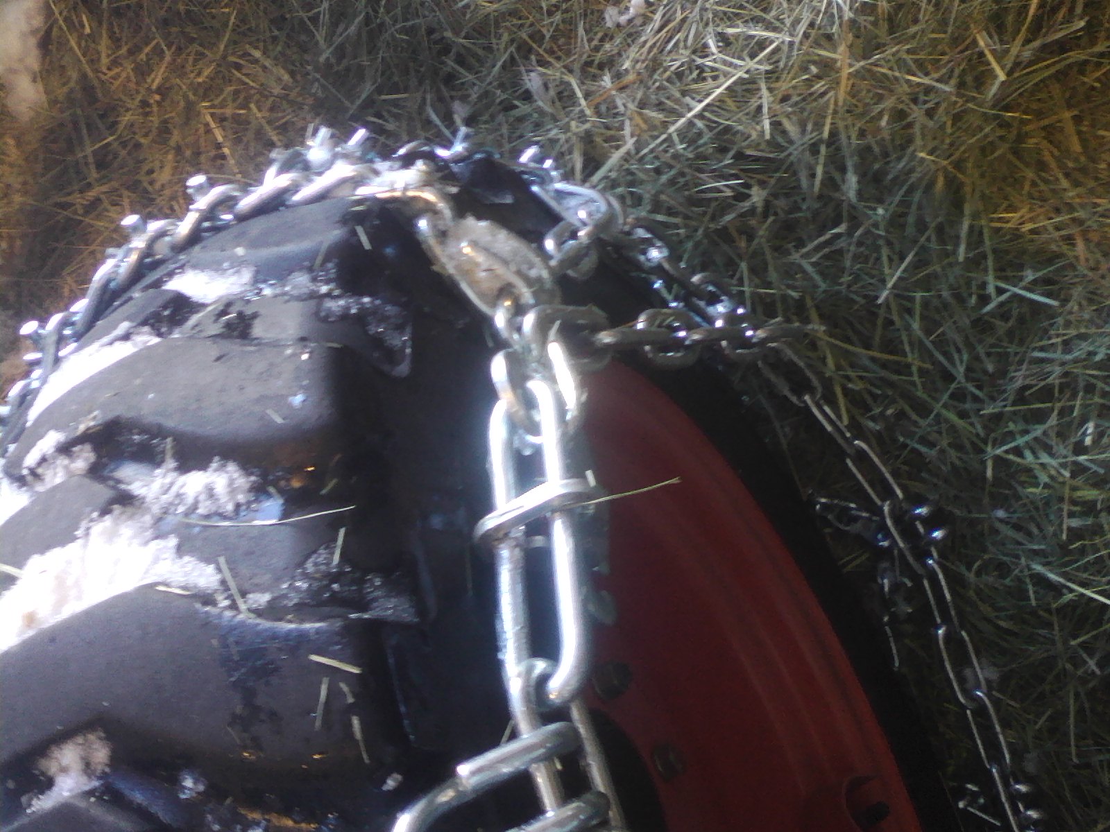

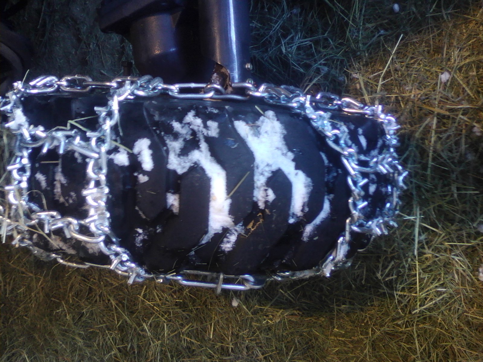

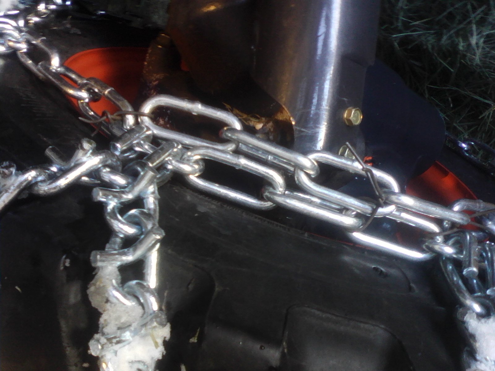

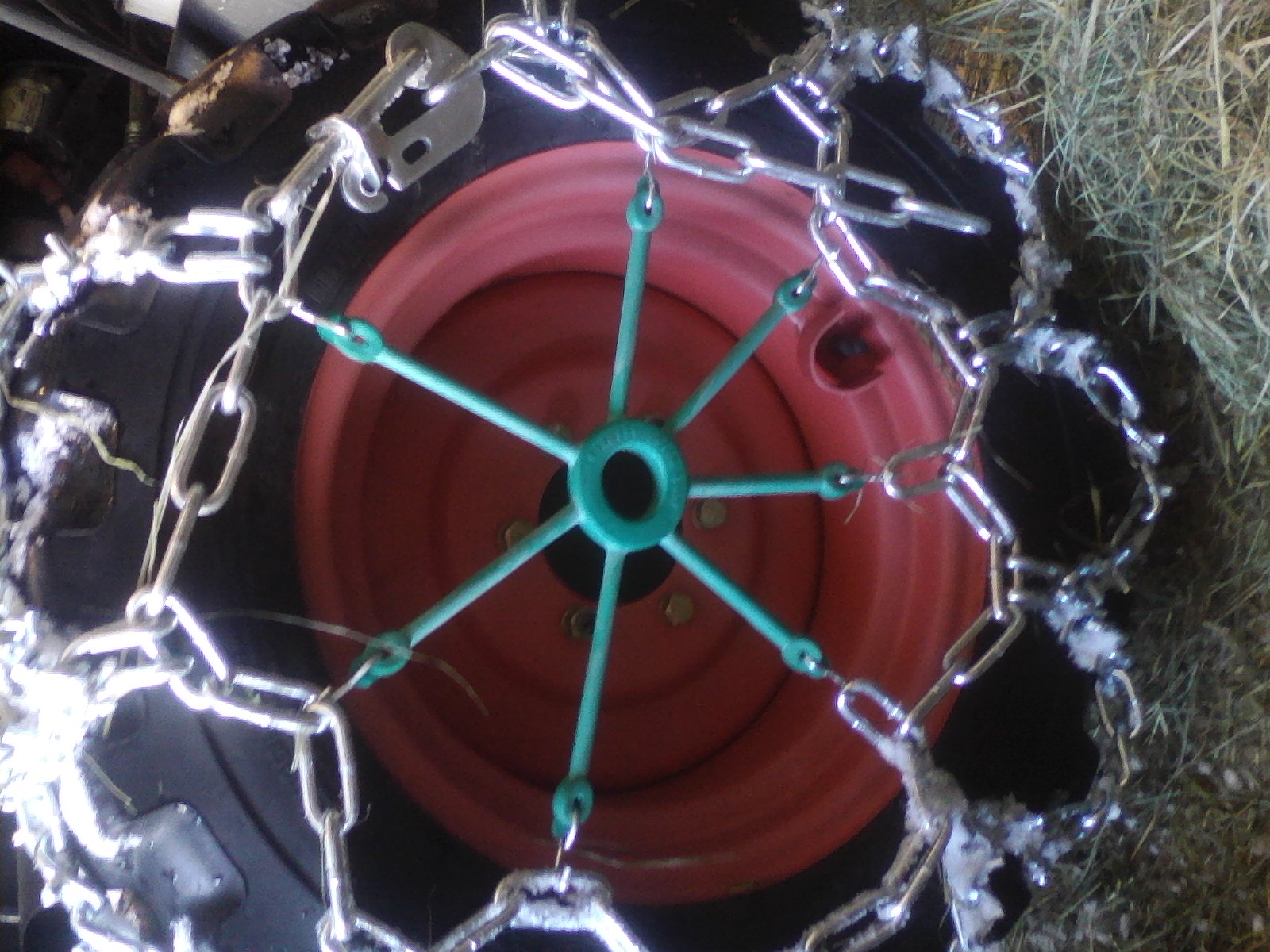

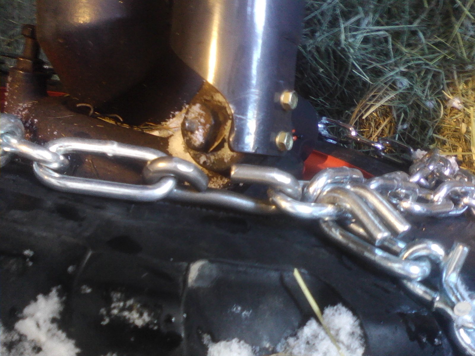

I knew the chains would be long based on the other tire sizes they fit. I jacked up the front using the bucket and draped the chains over. I wanted the inside high to clear the steering ball joint. The S hook with into the cross link chains at the proper length, but the outside seem a bit long, even with the tensioner. The photos were taken after about 300 yards of running. I also temporarily tied up the excess length to check the adjustment.
I also will look into filling the gap where things are connected.
So far I am considering shortening the cross links an inch (one link) so they ride a higher and take out some of the side slack. I can locally get extra chain at Tractor supply to fill the gap using shackles and pin connectors.
I have worked with truck chains and garden tractor ones, but I am learning here.
Any other help would be appreciated.

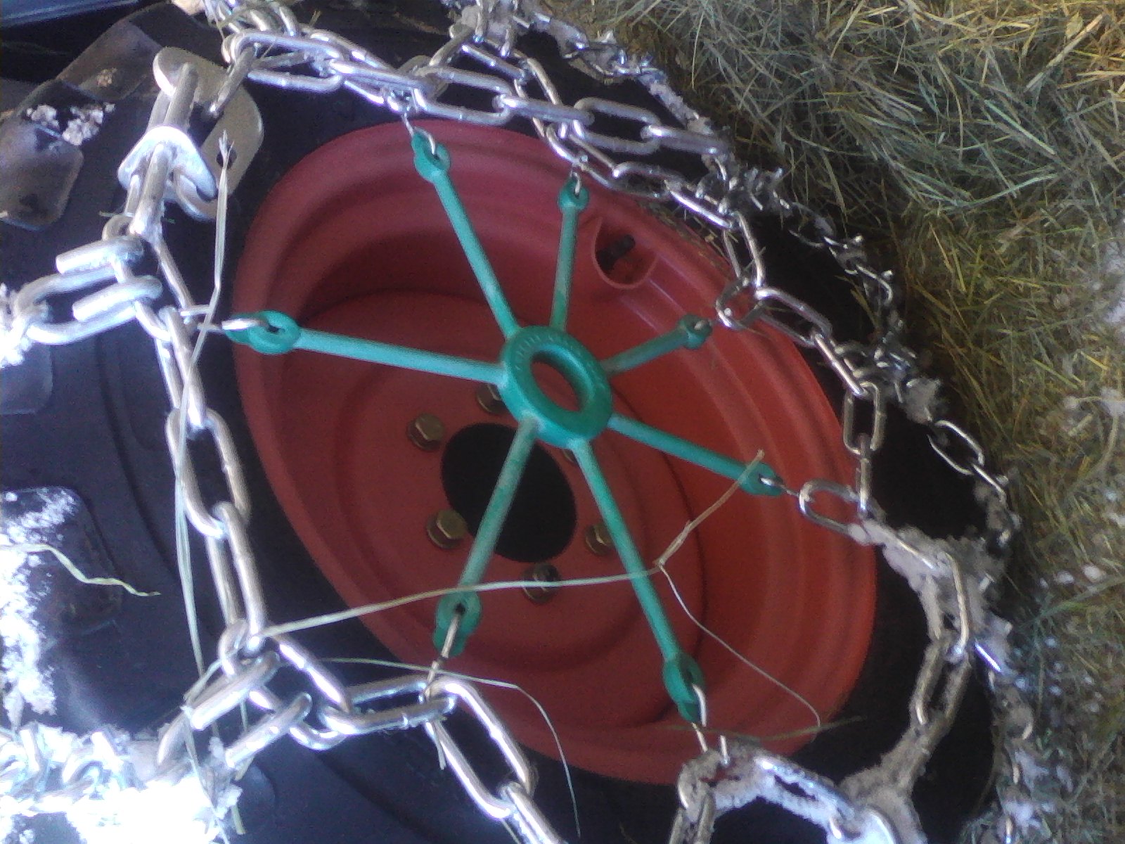

I could use some tensioners like that. Can you tell me the part number of the green tensioner you ordered? I looked on the Quality Chain website and did not see any green one's listed. Unfortunately they do not show which tensioners are for which diameter wheels.
Thanks!
Thanks!
Part # is 0213 picture #32 page 81 of the catalog. If you give them a call they are very helpful

I believe it is more cost effective to have them fit various sizes for production. I don't mind adjusting, but before I cut I want to know a bit more of what I am doing. For my rear tires I am getting a quote on a custom job for an exact fit. Even with custom, depending on tire pressure you will get a different fit too.

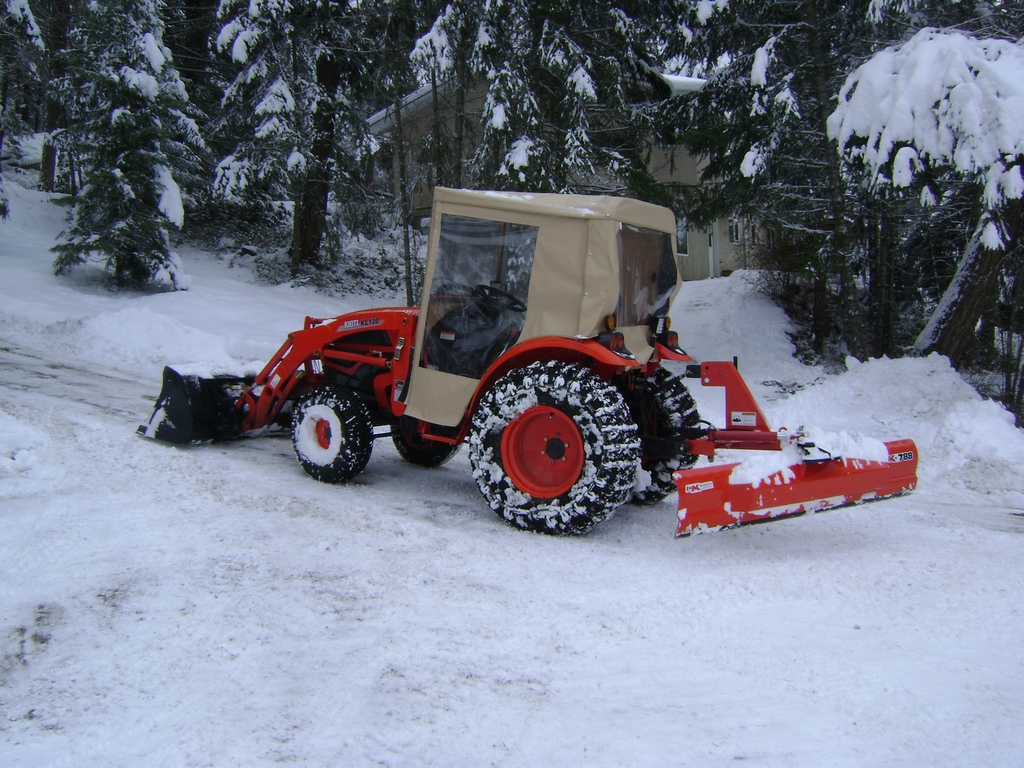

I sent the chain guy the size of my tires and the chains came perfect no extra links took 1/2 hr. to install they were nice and tight and after 4 tanks of fuel still no necessary.

Does anyone have any fitting tricks they have learned. As I had the front end lifted by the bucket, I draped them over each tire and got the S-hook to latch. I think I should have paid a bit more attention to make sure the chain was centered before doing the font cam-lock. Thoughts?
However the good thing is I had to upgrade my bolt cutters - my 18" one would not cut the hardened steel used in the 3/16 side chain so I upgraded to a 24" model rated for 3/8" hardened steel (grade 8 bolts). If it does not work I can take it back.
