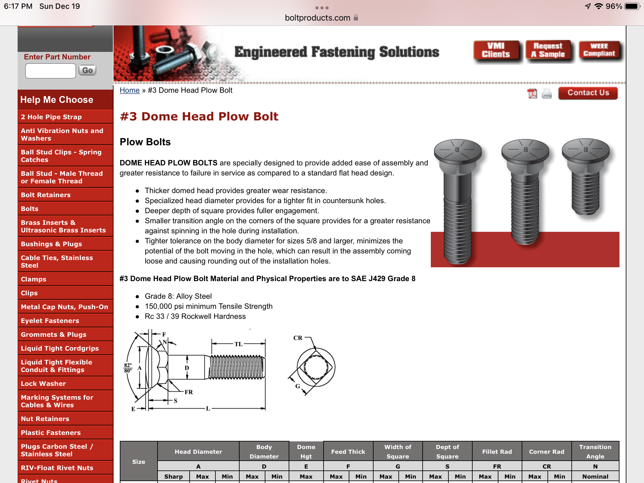

Carriage bolts are a poor substitute for plow bolts. The underside of the head is flat rather than tapered. So when, as you say, the dome head wears off there's little or nothing holding the bolt tight. The remnants of the head will recede into the tapered counterbore and whatever you are trying to hold tight against a support or frame will be loose.
Plow bolts are either grade 5 or 8. Carriage bolts are usually grade 2, if you are lucky they can be found in grade 5.

Actually, Dome head plow bolts are neither Grade 8 or Grade 5. They are if correctly made, ASTM Grade A325.
   / Tractor Supply doesn't have plow bolts #55
Not all plow bolts are dome head. It would not be a stretch to say most are flat headed.
Edit: Apparently not all dome head plow bolts are A325. The ones I used to source from Trinity and Imperial were Grade 8 as are these.

plow head bolts are all of the above grades (Grade 5, grade 8, grade A325 and more), a Mechanical Engineer specifies what grade to use for what application.
I have a 6' Landpride back blade with grade 5 plow head bolts. To add a rubber horse stall mat to plow snow in the winter I had to get longer plow head bolts to make up for the 3/4" rubber mat. Fastenal had the longer length in stock but were grade 8. They work and were available, your mileage may very.
