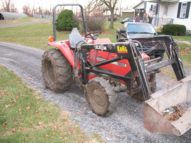

I got my tractor stuck the other week. The ground was too soft to lift with the bucket, so put 4x4 cribbing underneath it to increase the surface area, and lifted the front wheels off the ground. I put cribbing under the lower wheel, and dropped the tractor on that, and then used my truck as an anchor and the FEL as a lever to pull the rear tire out, and the differential locks and drive it out.
pics and so on here
meat: Tractor stuck!
/ Tractor Stuck, Bangor PA #24
Put the tractor in an incredibly low gear, tires barely turning. 4x4 locked in, rear diff locked. Rocked the front wheels back and forth and let it crawl forward while the come along was cranked.

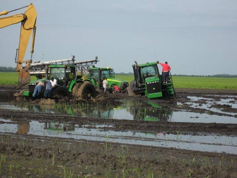

Came across this picture today and thought this would be a good place to show it off. This is another day in the mud.
/ Tractor Stuck, Bangor PA #30
Those boys have everything they own stuck!
