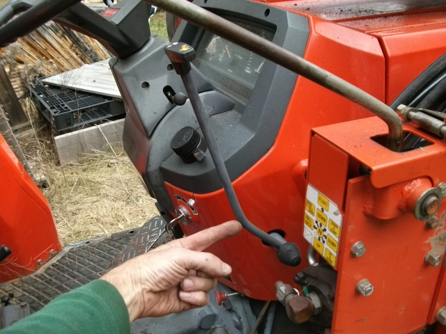

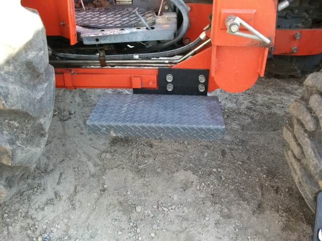

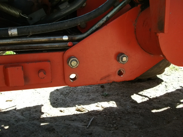

Had no step on the right side of my tractor. Finally got around to making one. Actually made one for each side as will replace the almost unusable one on the left side next. I modified the throttle lever to facilitate easier ingress/egress on the right side. Bracket is 1/4" material which I got lucky and got powder coated. The top piece is an old aluminum diamond tread deck plate off a Komori printing press which I cut in half to be able to do both sides.

Thanx! to Jay also. Most Kubotas are made to enter from the left side only, at least the two I own. Practicality dictates both sides for on/off, hence the mods. Still on the fence about modifying the FEL joystick on either tractor. When working in cold weather the extra clothing is usually what catches on the various handles and knobs. An unanticipated use for the wide steps is for an unauthorized passenger. Not much room on these Kubotas for riders as they pack a lot into a little bit of space.

I wish the step on mine looked as nice as that. One thing you might add is something to give you a sure grip when you have wet or muddy boots. I'd be afraid of stepping off onto that and losing my footing. Maybe a piece of expanded aluminum or ss on top of the step would help. It might be fine as is though. Just a thought.

Nice step - On my L3830 the HST pedal is in the way if you get in from the right. If it is in gear you could go for an unexpected ride!
Nip 'er off about 5 inches. I finally cut mine and am happy with the result. Still hooks under a loose coat though unless I'm careful, but getting on in the woods is ever so much easier now. I used to really hate walking around to get on from the left, and sometimes it just made life more difficult than it needed to be.
