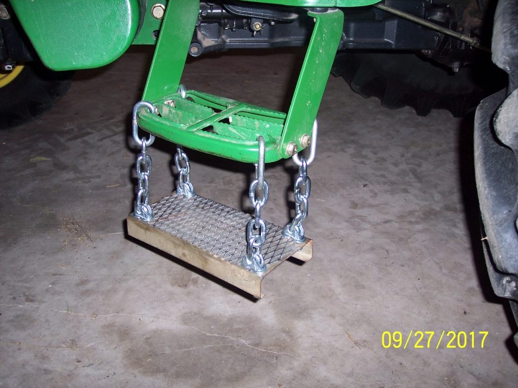

One of the reasons I signed up for an account on these forums was to ask how to do something; but I went ahead and did it before I ever got around to asking the question!
John Deere has some ergonomic issues (such as no seatbelt extenders for us heftier farmers, but that's a different issue).
Having to step up 19 inches from ground to the one step below the operator platform is hard on folks like me that have back issues. A day of tractor work (on my 4120) can be painful after a lot of these large steps getting on and off.
Some C channel from a friend of mine, some expanded metal (I already had from other projects) for a non-skid surface, some chain and cable clamps, and I have a swinging step -- only 11 inches from ground to its surface.
The wheels are in line with the steps, so John Deere didn't omit a second step to avoid hitting something front-on, because the wheel would have already hit it. So I guess they were concerned about turning into something and mangling a lower step. This is why I chose to make a swinging step. If I turn into something, the step will just be bounced away or over it.
When I'm satisfied with using it for a while, I'm going to paint the step and the chain links, except the quick links at the top that connect it to the JD step. You can guess which color I'll paint it. For me, I found that if I use the ball and pad part of my right foot to step on the swinging step, then I can quickly get my left foot up to the JD step, and so on.

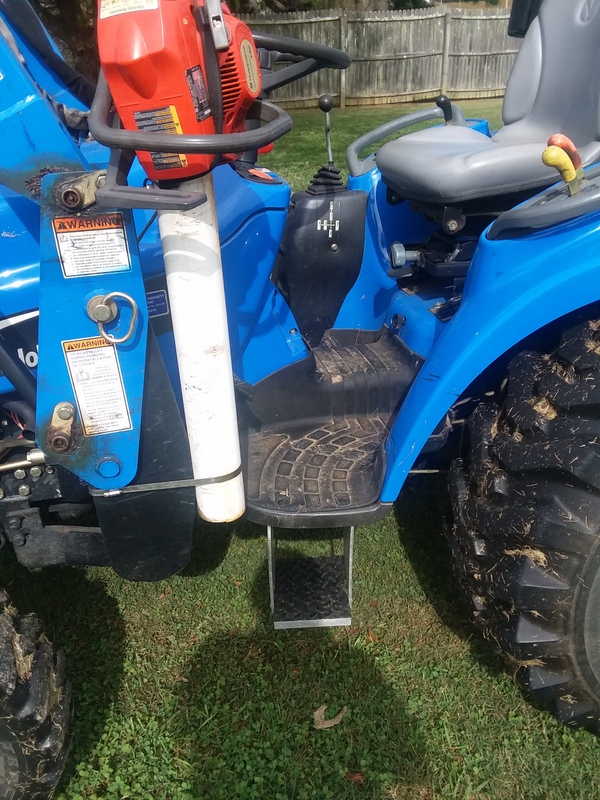

Made this step a few weeks ago from alum. I sourced from ebay. Tractor platform already had mounting brackets for factory step. This step only cost about 30.00 vs close to 300.00 for new holland's version.new.jpg

Clever idea! Does the step not try to swing under/away from you when you put weight on it?
Yes, it does. My first attempts at using it, I was putting my foot too far in, and ended up rubbing my shin against the JD step. But I soon found that I should not use the middle of my foot at all. I just use the ball and pad area at the front of my foot (I don't know anatomy enough to know what it's called), and that works great. It swings in a little, but I'm standing over it enough that it doesn't swing that much -- not enough to swing my leg into the JD step, as long as my foot is not too far in.
After about 4 or 5 tries, I got the "swing" of it (pun intended) so that it does just what I needed: gets me up high enough for my other foot to catch the JD step without having wrenched my back to get there!
Oh, and as to color: I found that it is pretty visible in its location. So I went ahead and got some metal primer and JD green. I'll be priming the step and chains (except the quick link) today, and plan to paint it tomorrow. Probably over several days I'll add a few coats. I'm not using the tractor right now anyway. (Walnut time!)

Finished product. Visibility isn't really a problem, so I chose the main color to match the bulk of the tractor.

On the swinging step, many manufacturers use a strip of belting (like round baler belts) on each side to hold the step on, easier on the shins that way.

I often see utility co. trucks around here with a rear step suspended by a couple of lengths of about 1 inch diameter steel cable. This is stiff enough to not swing with a person's weight, but it will give if the truck backs into something.
