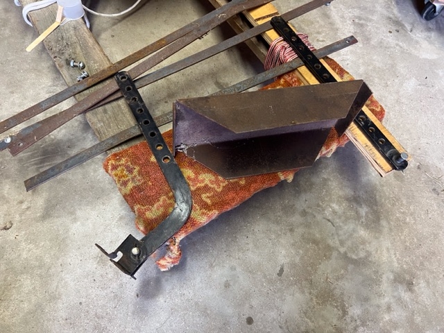

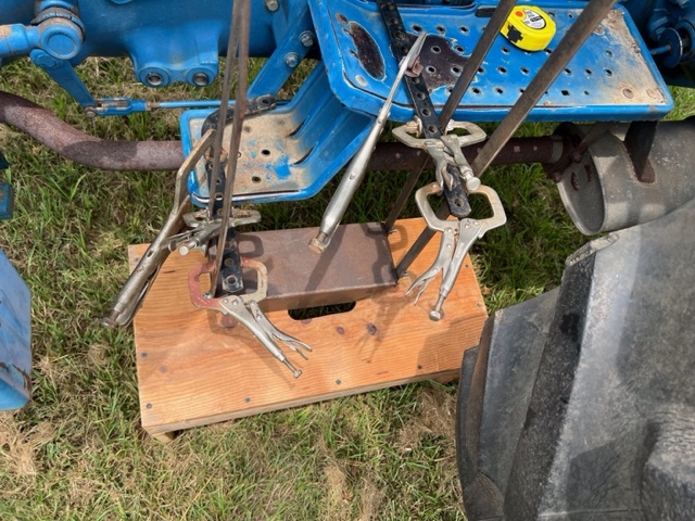

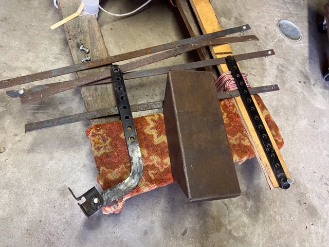

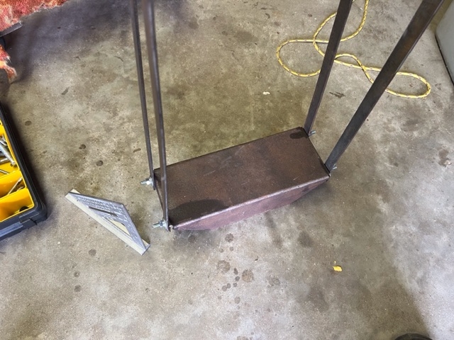

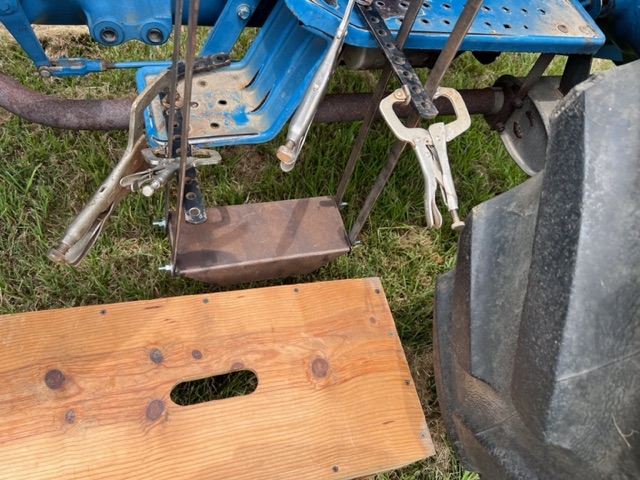

Due to injury to both shoulders, climbing up on my tractor has become an issue. I’m trying to minimize any additional injury.
I’ve been using a wooden bench as a step up. Then kick it out of the way. Getting down from the tractor is not much of an issue.
Anyway I decided to fabricate an extra step for the tractor. I found some usable parts in my metal scrap pile. Just thinking and designing as I go. The step part I made long ago and cannot remember how I used it. Good looking step may need to cut it down a bit.
Pictures show progress so far. Slow going cause I have to care for my shoulders, arms and hands. Plus hot hot in Texas so I do a little bit at a time. Hopefully this will work.
