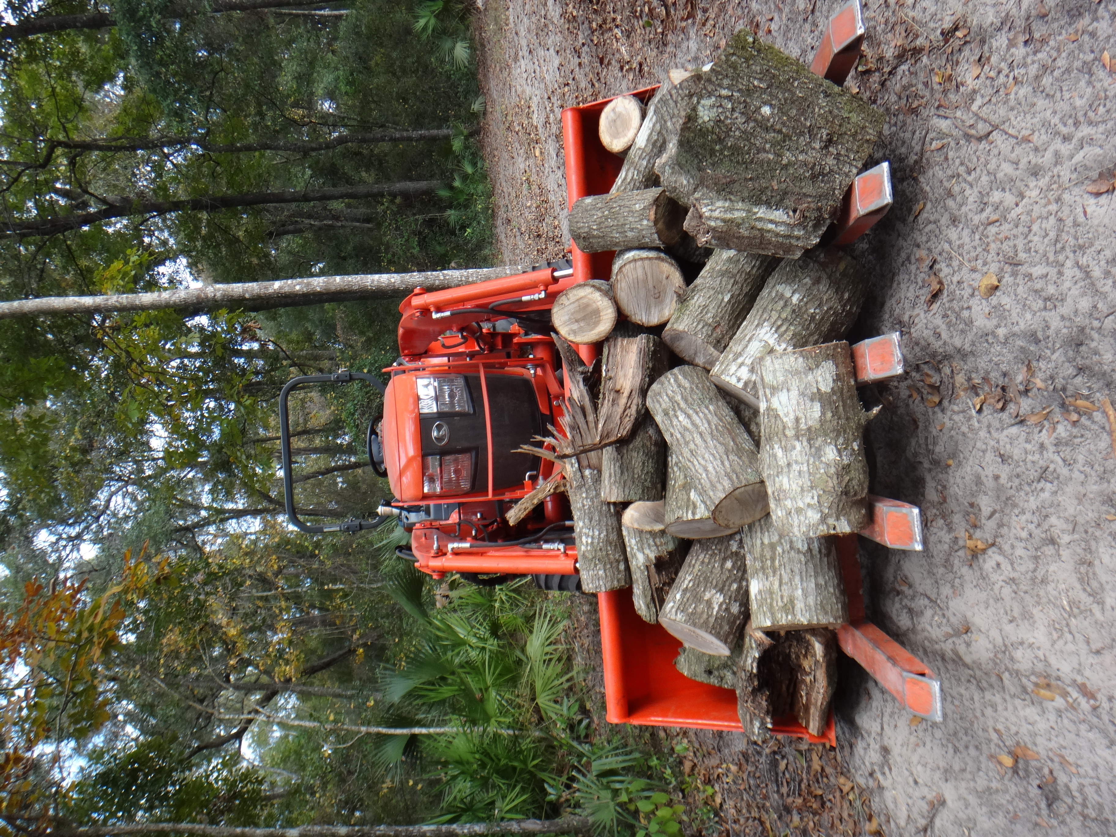

   / Tractor sizing and comparison and choices...Help me identify potential candidates! #30
I haven't had an issue with moving dirt with my LA805 and 72" bucket
Nor do I.
Well a guy I work with says the MX5200. moving dirt doesn't have enough weight for the bucket after filled tires.
It is WEIGHT not size which defines a tractors capability. Compact tractors ALWAYS require Three Point Hitch counterbalance for maximum FEL lifts.
