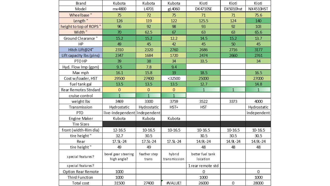

A lot of work on the matrix for sure. I have done smaller ones comparing up to 4 tractors at a time with fewer specs.
Another thing you may want to consider is turning radius. Comparison of the wheelbase isn't necessarily an indicator of how sharp the tractor will turn. The circle scribed by the inside rear tire on a tight turn is 27" smaller with my L4240 than with my L3200 (71" vs. 98").
I would echo Jeff's comment on the HST/Plus. The on-the-fly range shift has been very useful.
Thanks. I wasn't worried at all about the turning radius, until you mentioned it. Now I'm looking over the steering mechanisms in the tractors and I really like the bevel gears of the Kubotas. I noticed a few tractors have u-joints. I will not buy one with u-joints. I saw a double u-joint cardovan in a JD. Those are much better, but that tractor was sky high way outta my budget. I guess I will pay attention to the steering radius now that you've mentioned it. I want a long wheelbase for the steep hillclimbs that I'll have to do daily just to get from spot to spot.
