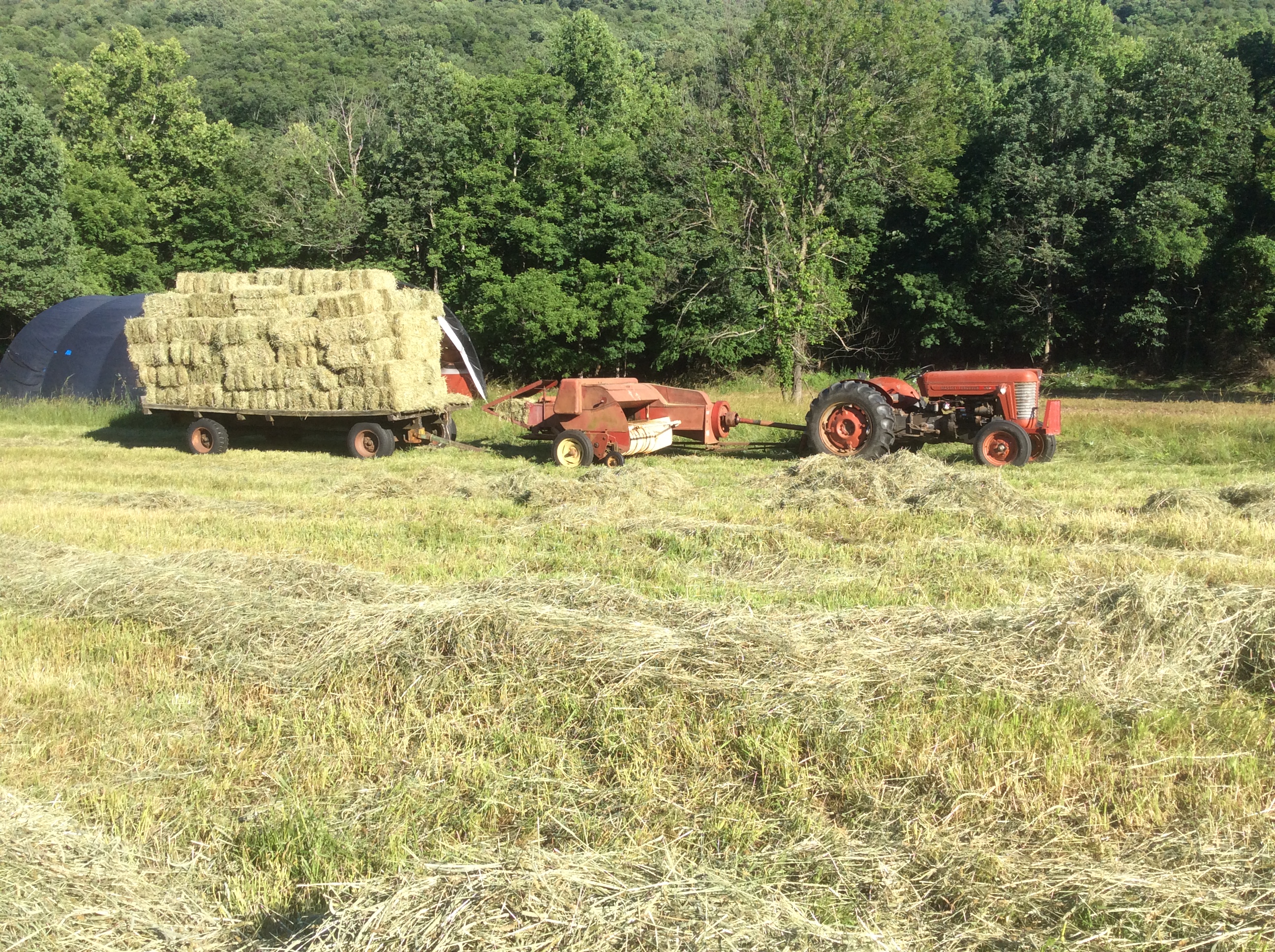

Massey Ferguson 50 diesel on flat ground and very very minor rolling hills does very well with a baler and loaded wagon in tow. This tractor is operated at 540 PTO which is 1,499 engine rpms and 31.08 hp per it's Nebraska test.
A similar tractor would be a MF 135 or a Ford 3000 at 37ish hp. IMHO, this is an ideal size tractor for haying flat fields, pulling a wagon on small farm acreage and a limited budget.

See how well that works Rob!!!! Logical, positive input, supported by pic. An addition to the thread rather than a distraction!!!! :D
You mean I don't post enough picts for you??? Geee, and I was sure I was coming here, just to make YOU happy too! lol
