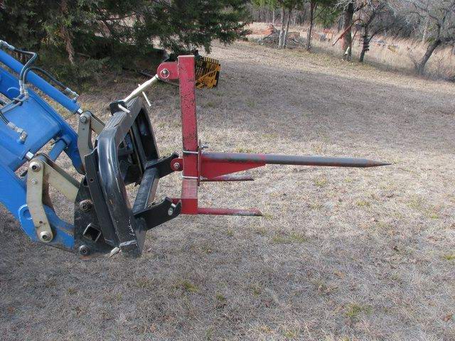

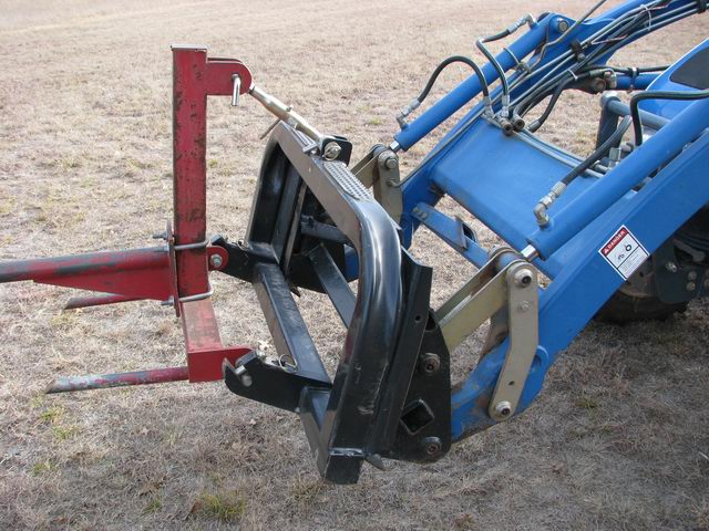

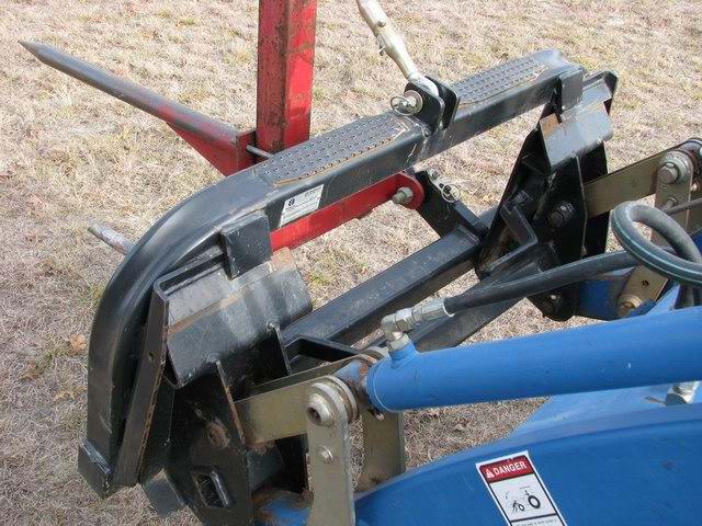

[[This is a highly functional and worthwhile practice, missing on some.]] Somebody in the design was not paying attention in ME class tho. Otherwise they would have used round tubing to resist the torsion. Square tubing is a very inefficient use of metal in that function and effectively ensures that you carry around more front weight than you would need if the proper shape were employed. Since every bit of overhung front weight destabilizes the tractor it really surprises me to see a manufacturer apply reinforcement weight out there in so cavalier a fashion.I like the idea of the really strong torque tube on my adapter. It is beefy enough that I can wrap a chain around it and lift heavy objects without having the added weight of a bucket. I've even thought of welding hooks near each end for convenience so they are there no matter what I have attached. The other reason is that I have a toothbar and often have uneven loads on the bucket when popping rocks or roots. The torque bar helps to ensure the bucket does not twist, or at least that's my perception. I also think that some lightweight implements like bale spears might not have a lot of built-in torsional strength. By having it on the loader side, you never have to worry.
[[My torque tube is not just face welded onto the inside of the QA adapter. It goes all the way through and is welded on all surfaces.]]] In the photo below, you can see my 3PH QA adapter also has a brute of a torque tube. It's a NH adapter and is built extremely heavy. It was only $250. I'm sure steel prices have driven up the price of all these items in the last few years.
