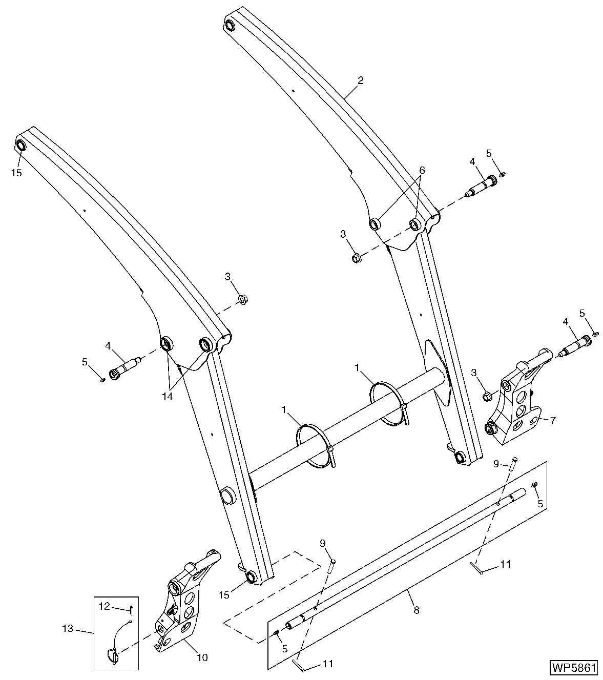

I am pursuing the installation of a standard QA system on my NH TC45 tractor. The implement side attachment plates are readily available, cheap, and space efficient. The tractor side attachements are not.
Because they are out of my price range currently, or extend the bucket significantly, and I want some fab practice, I am going to make my own.
One question I have is that tractor side QA systems that I have looked at have a torque tube, or equivelant, going between the two sides. It is my impression(and true for my equipment) that the attachements themselves are stiff enough that the torque tube does not add any strength. In fact, there are several post here that indicate that mistakes caused that tube to bend, preventing the QA system from reattaching to implements.
Therefore, I would like to not utilize a torque tube, and allow the two sides to move independently( as they now do without QA). Does anybody see a problem with doing that, and can the people who have this system think about the attachments, and tell me if I will have a problem.

The two halves will move independently based on the cylinder/linkage with the least resistence. Unless you diligently leave the bucket cylinders completely stationary whenever there is no attachment on the QA device, it will be a bear to get attached to a bucket or whatever. I had the displeasure of operatong a Deere 5520 that had a 541 loader with pins missing between the coupler halves. It was a real d@#kache.
If you are at square one with this project, look into the 'Euro' style coupler being seen more and more. I am beginning to be a big fan of this style. I believe attachments for this coupler will be more available as time goes on.

I am working on a homebrew QA (tractor side) and I know why you want to eliminate the torque tube (at least I can only think of one good reason). i am guessing that the torque tube will interfer with whatever you have planned for releasing the bottom catch pin?
The only other reasons I can think of is weight reduction (which would be minimal anyway) or your bucket has a structural section across the back (Kubota's have an angle welded across the back) and it would interfer with the torque tube.
I think most loader attachments are torsionally very strong and you would be ok to eliminate the TT. I would not do that for reasons already stated PLUS the torque tube also acts as a "spreader" keeping your cylinder ends apart. If you delete the torque tube then the tops of the QA can flop side to side. If you mount your bucket with them crooked then you subject the pins and cylinder to side loads. This could be helped or minimised by modifying the bucket, forks, etc but it would become a PITA.

I would say you are correct in that the Torque Tube is NOT required...Alot of skid-steers dont have the tube, my Factory Deere SS QA does not have a torque tube...
As for aligningment of the "Paddles" the little silver tube in the pic is considered a "Timing Rod" and is nothing more then a small piece of pipe which holds the 2 paddles close enough to each other that you can retract/extend the bucket cylinders and keep em close enough to attach implements with no issues.

There has to be more to that than just a pipe; what happens if you only hook one side in and curl? Maybe that is a solid rod (stressproof,etc)? Does the tube allow twisting (i.e. springs at ends)?
Does your loader have a flow divider for each side? Maybe JD uses that to "balance" an unbalanced load when oop's happen. Could you try torquing one side a little and see how it responds? Maybe a closeup pic of the backside (of the QA:eek:) would be interesting.

Here is a picture that may help... It's a solid rod with 1/4" pins (#9) that tie the two sides together. I can tell you from personal experience that when one of the pins shear off, then it's a PITA to try to hook the bucket up. The shoes have a mind of there own unless they are tied together.

I wouldnt call that rod "stress proof" nor would I call it strong, like KennyD mentioned, theres just 2 1/4" bolts holding it there....You would not ever use it for lifting or anything like that...The sole point of it is to keep the 2 paddles (be it the SS Quick or standard JD Quick) relatively aligned together.

I like the idea of the really strong torque tube on my adapter. It is beefy enough that I can wrap a chain around it and lift heavy objects without having the added weight of a bucket. I've even thought of welding hooks near each end for convenience so they are there no matter what I have attached. The other reason is that I have a toothbar and often have uneven loads on the bucket when popping rocks or roots. The torque bar helps to ensure the bucket does not twist, or at least that's my perception. I also think that some lightweight implements like bale spears might not have a lot of built-in torsional strength. By having it on the loader side, you never have to worry.
My torque tube is not just face welded onto the inside of the QA adapter. It goes all the way through and is welded on all surfaces. In the photo below, you can see my 3PH QA adapter also has a brute of a torque tube. It's a NH adapter and is built extremely heavy. It was only $250. I'm sure steel prices have driven up the price of all these items in the last few years.
